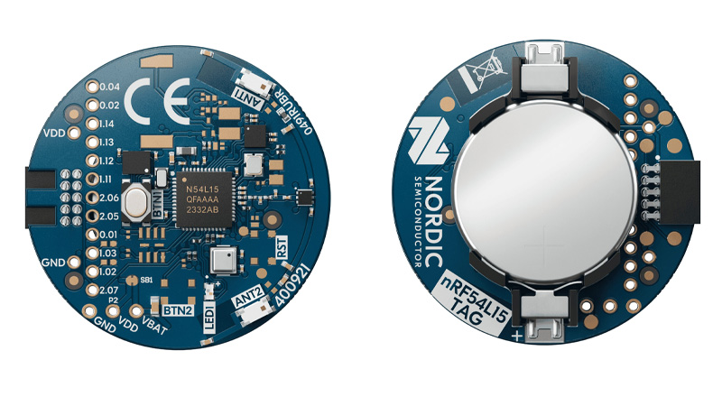

Nordic nRF54L15 Tag shown from the front and rear views

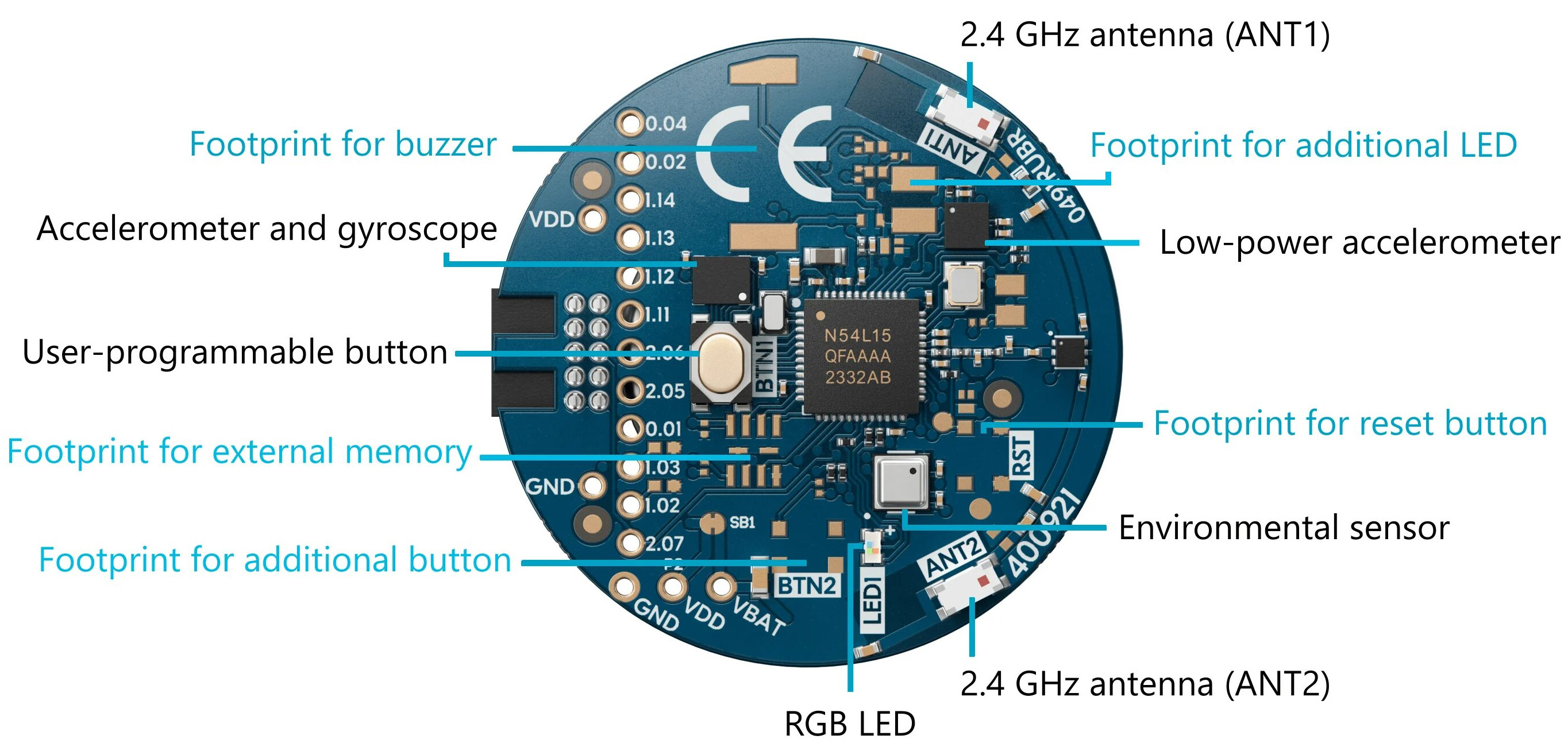

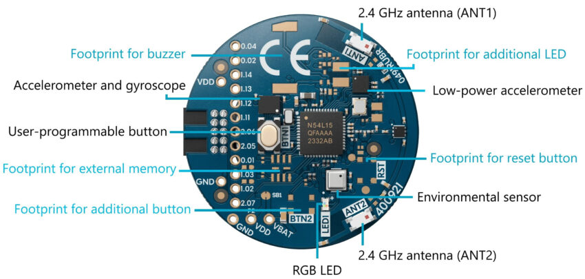

nRF54L15 Tag with its dual 2.4 GHz antennas, motion and environmental sensors, RGB LED, programmable buttons, and expansion footprints

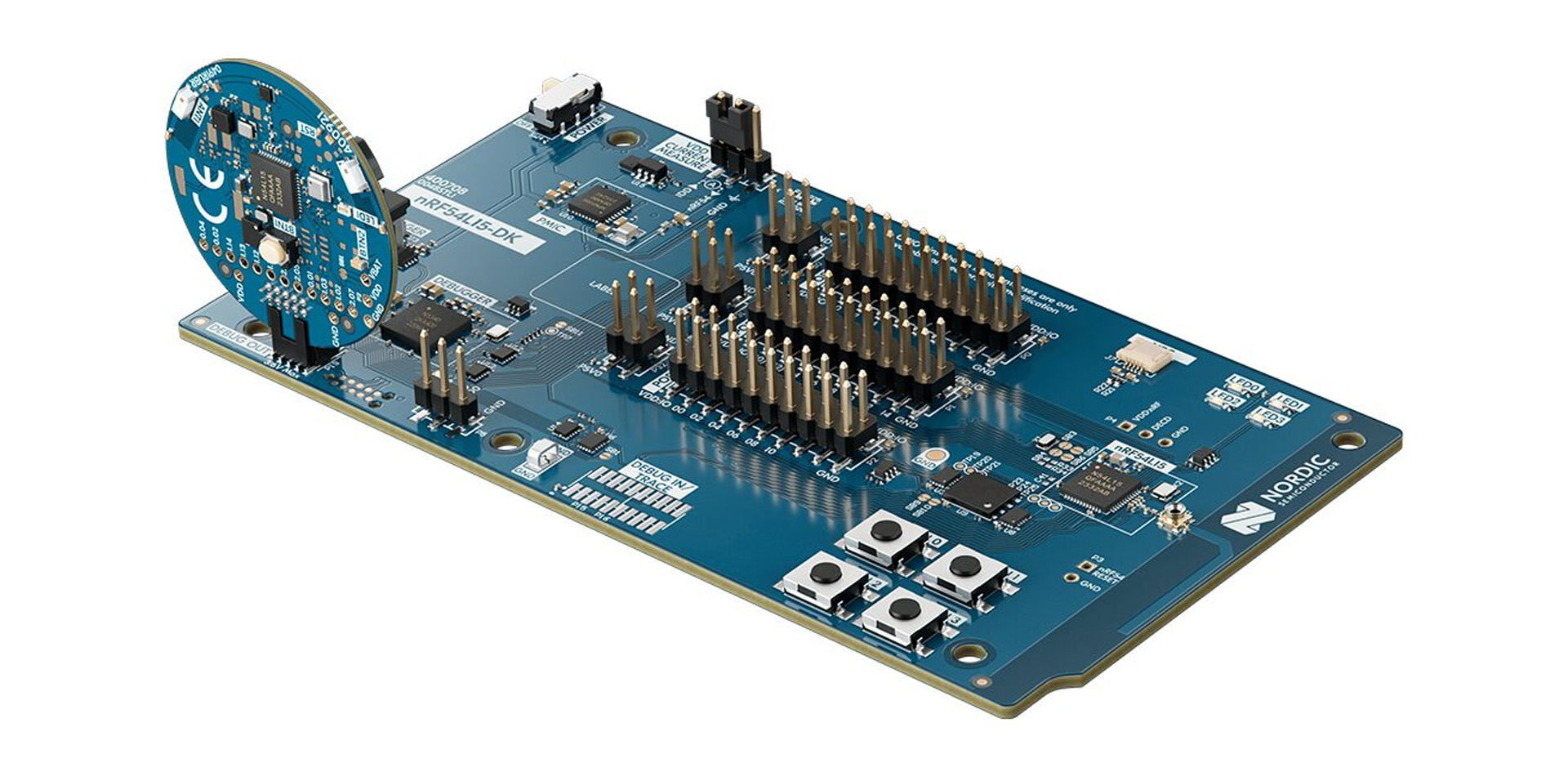

nRF54L15 Tag mounted on the nRF54L15 development kit for prototyping and testing.
