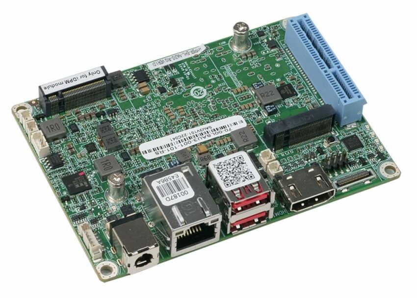

PICO-ITX board with Elkhard Lake processor
The high-performance Hyper-EHL board from ICP Germany is a cost-effective solution for applications requiring high reliability, such as industrial automation, machine control, traffic engineering and display systems. The Hyper-EHL board can be purchased with two different Elkhard Lake CPUs: Variant one with Intel® Celeron J6412 offers four processor cores, a base clock frequency of 2.00 GHz, 1.5 MB cache and an Intel® processor graphics unit with 400 MHz, while variant two with Intel® Celeron N6210 brings two processor cores, 1.20 GHz base clock frequency, 1.50 MB cache an Intel® processor graphics unit with 250 MHz.
The Hyper-EHL board can be purchased with two different Elkhard Lake CPUs: Variant one with Intel® Celeron J6412 offers four processor cores, a base clock frequency of 2.00 GHz, 1.5 MB cache and an Intel® processor graphics unit with 400 MHz, while variant two with Intel® Celeron N6210 brings two processor cores, 1.20 GHz base clock frequency, 1.50 MB cache an Intel® processor graphics unit with 250 MHz. An LPDDR4 working memory with 4GB is soldered onto the board. Optionally 8GB are possible from 100 pieces. An iSATA slot and an M.2 slot with M Key are available for mass storage.
Specifications
  • Pico-ITX board with Intel® Celeron J6412 or N6210 CPU
  • LPDDR4 4GB memory (optional 8GB)
  • Three independent displays: HDMI, Display Port and optional IDPM
  • 2.5 GbE Intel® I225V
  • Two USB 3.2, two USB 2.0, one iSATA, one COM interface
  • Extensions: one M.2 M slot, one PCIe x4 slot
The Hyper-EHL has numerous connectors, including HDMI, Display Port, optional iDPM, a 2.5 GbE Intel® I225V LAN interface, two USB 3.0, two internal USB 2.0 and an internal RS232/422/485 interface. With a voltage input of 12V DC, the wafer EHL can be used in environments from 0°C to 60°C.
ICP Germany supplies the Hyper-EHL with appropriate memory and CPU on request.
