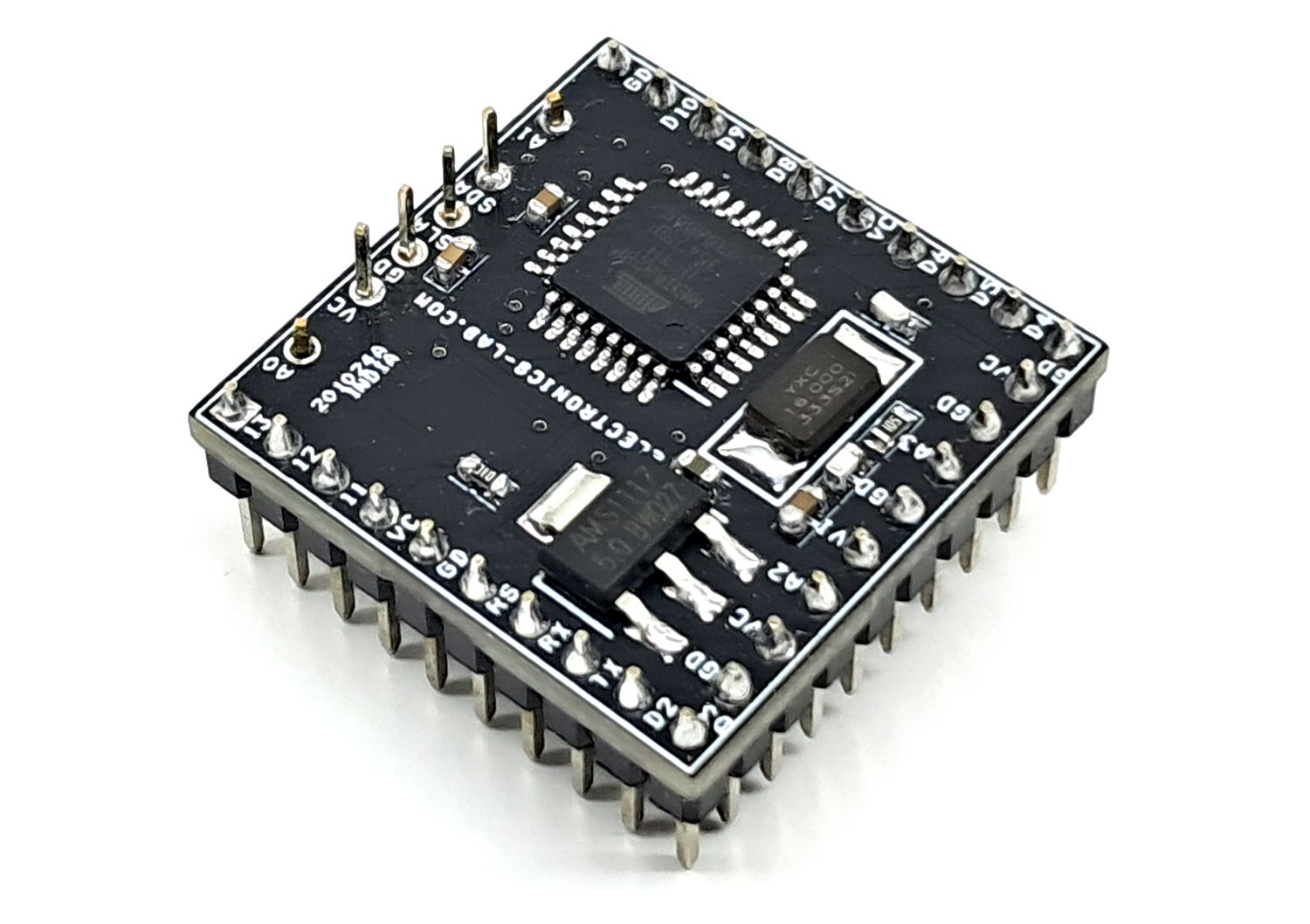

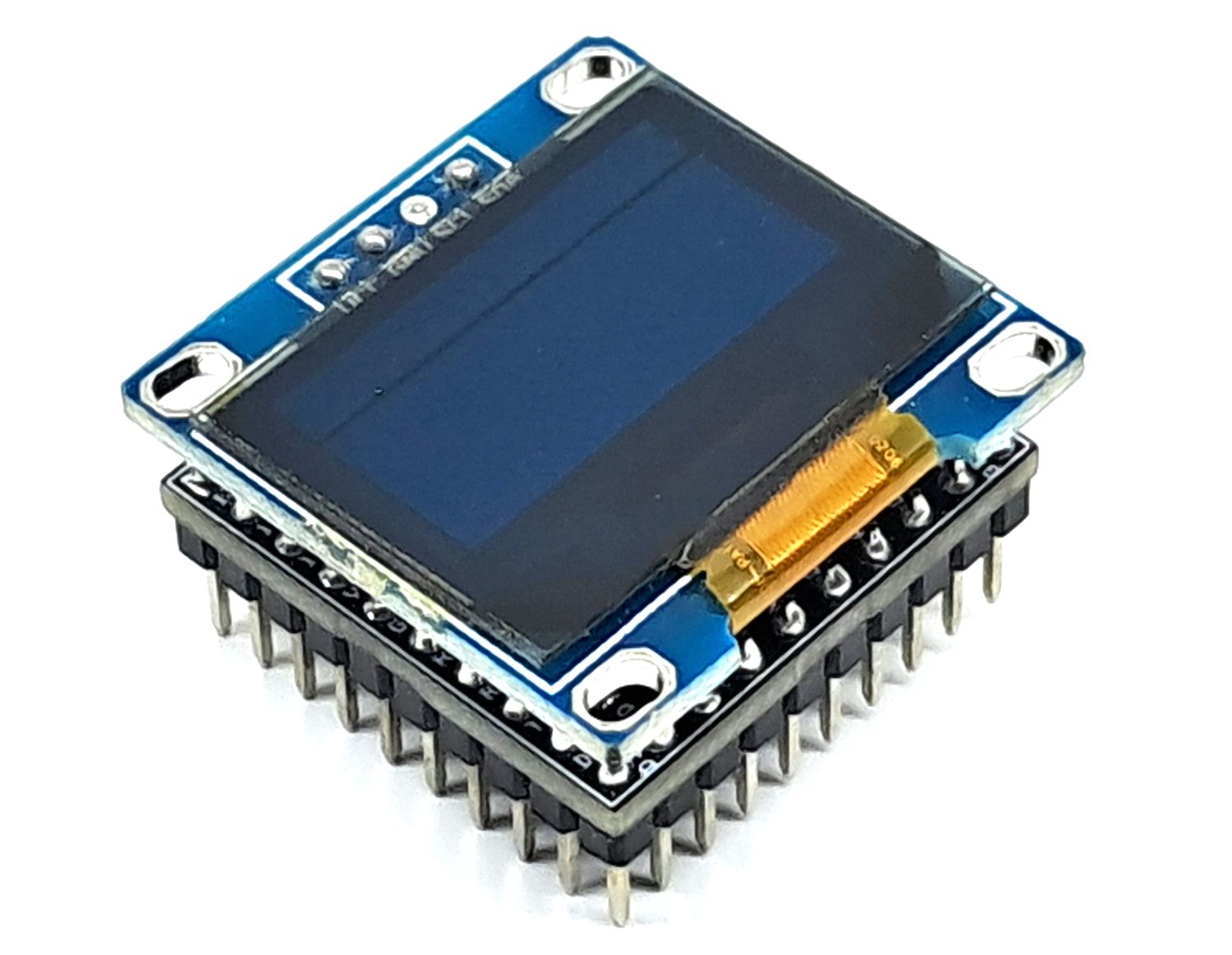

OLEDUINO – Arduino compatible OLED display

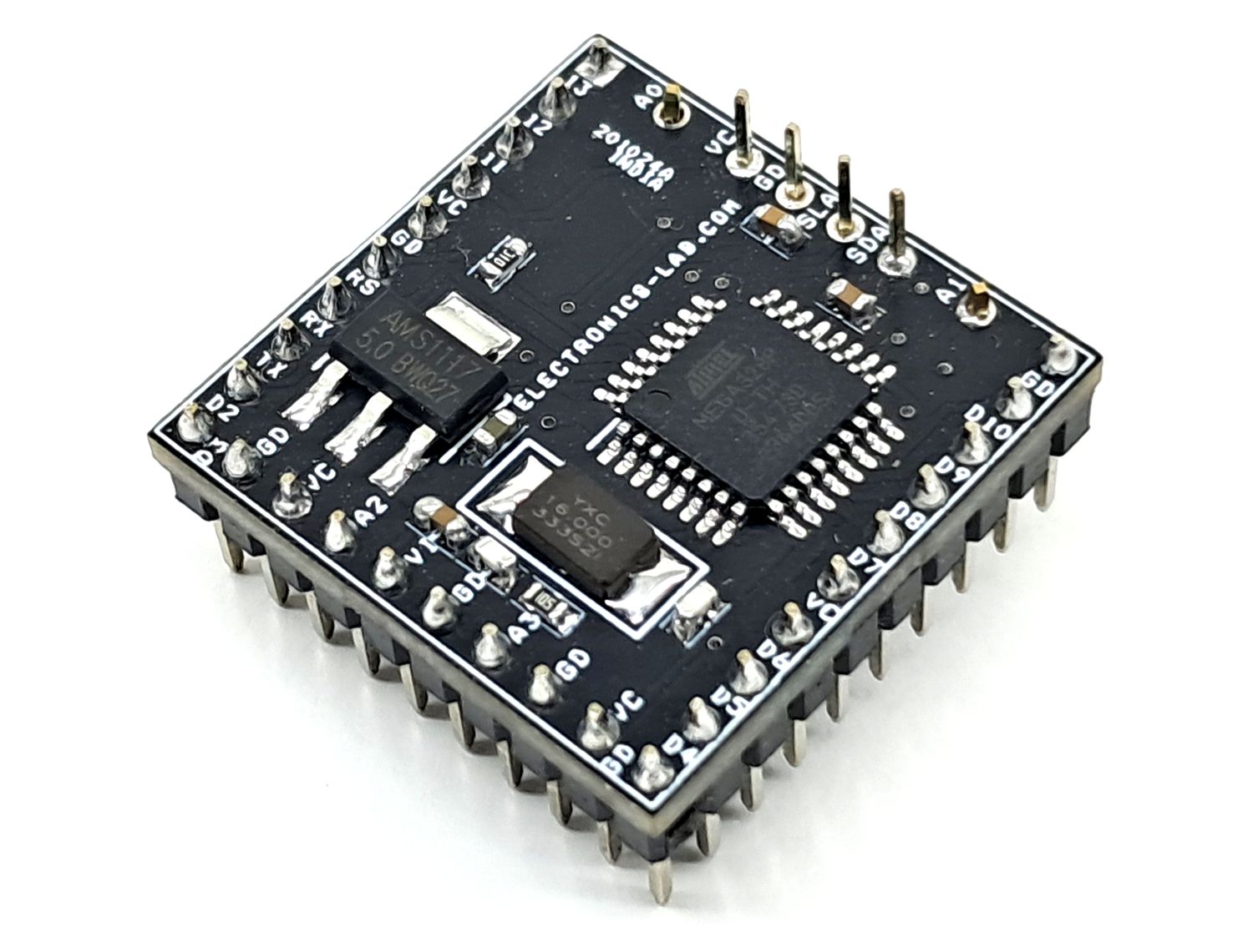

This OLEDUINO Board is a compact, feature-rich board that incorporates the ATMEGA328 Arduino microcontroller, a 0.96-inch 128x64 OLED display (SSD136), a 5V regulator, and headers connectors that provide access to all Arduino I/O lines. Notably, the board's size is smaller than the OLED display, and an onboard connector is supplied for bootloader burning and Arduino programming.
This OLEDUINO Board is a compact, feature-rich board that incorporates the ATMEGA328 Arduino microcontroller, a 0.96-inch 128×64 OLED display (SSD136), a 5V regulator, and headers connectors that provide access to all Arduino I/O lines. Notably, the board’s size is smaller than the OLED display, and an onboard connector is supplied for bootloader burning and Arduino programming.
Note: This project works as a standalone or along with the Smart Soldering Iron Controller – Precision Heater Controller board published previously.
Key Features
  • Power Supply: 6V to 11V (VIN)
  • Power Supply: 5V-VCC
  • Connector for Bootloader and Arduino Programming
  • 4-Pin Connector for OLED Display (0.96 Inch)
  • Board Size: 25.72 x 25.56 mm

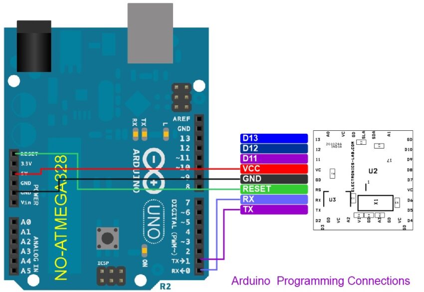

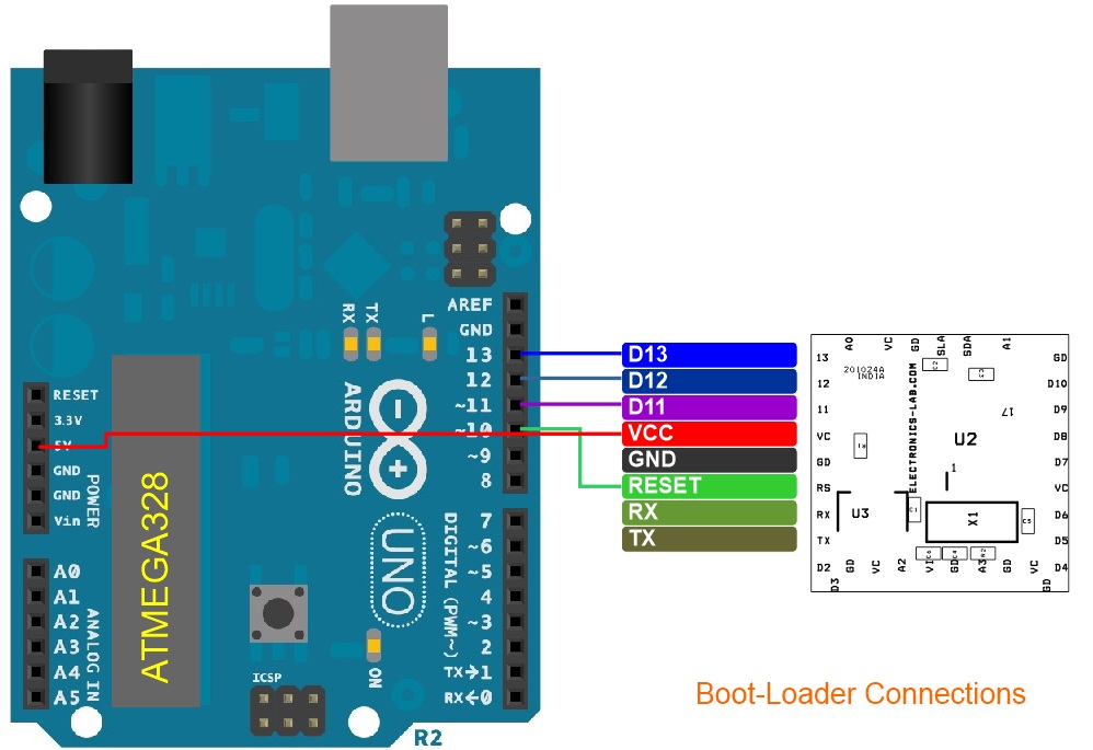

Arduino Programming
For more information on Arduino programming and bootloader installation, users can refer to the official Arduino documentation, specifically the “Arduino to Breadboard” example.

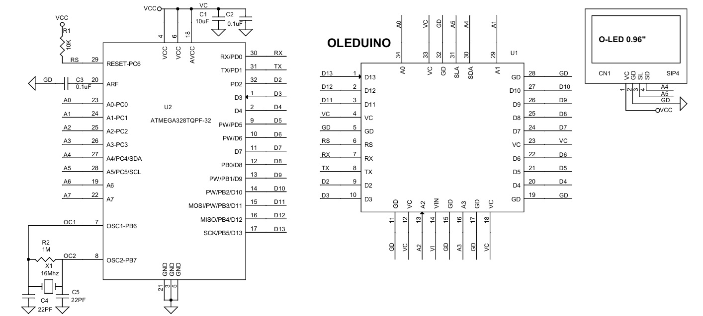

Schematic
Parts List
NO.QNTYREFDESCMANUFACTURERSUPPLIERSUPPLIER PART NO
11CN14 PIN MALE HEADER PITCH 2.54MMWURTHDIGIKEY732-5317-ND
21C110uF/16V CERAMIC SMD SIZE 0603YAGEO/MURATADIGIKEY
32C2,C30.1uF/16V CERAMIC SMD SIZE 0603YAGEO/MURATADIGIKEY
42C4,C522PF/16V CERAMIC SMD SIZE 0603YAGEO/MURATADIGIKEY
51R110K 5% SMD SIZE 0603YAGEO/MURATADIGIKEY
61R21M 5% SMD SIZE 0603YAGEO/MURATADIGIKEY
71U1OLED DISPLAY 0.96INCH 128X64MIDASDIGIKEY3086-MDOB128064V2V-YI-ND
81U2ATMEGA328TQPF-32MICROCHIPDIGIKEYATMEGA328P-AU-ND
91X116MhzECSDIGIKEYXC1776CT-ND
102CN10 PIN MALE HEADER PITCH 2.54MMWURTHDIGIKEY732-2670-ND
111CN9 PIN MALE HEADER PITCH 2.54MMWURTHDIGIKEY732-5322-ND

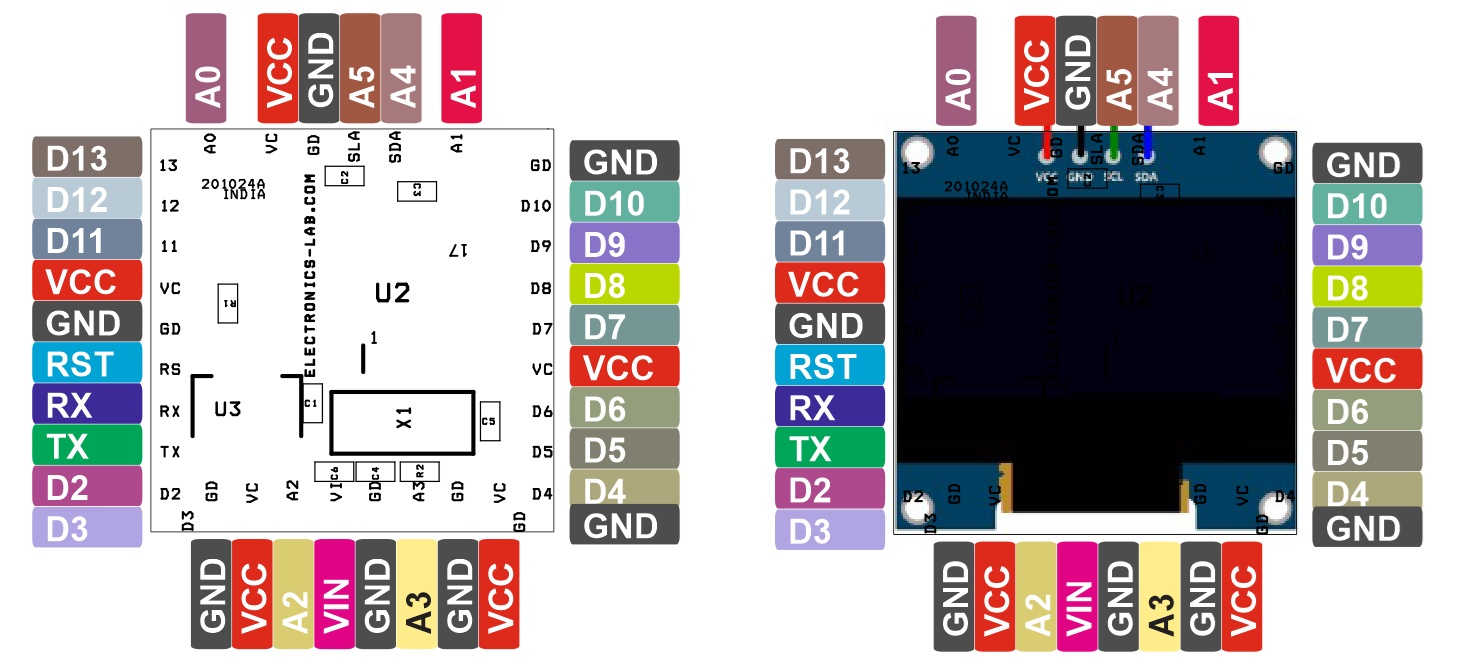

Connections
