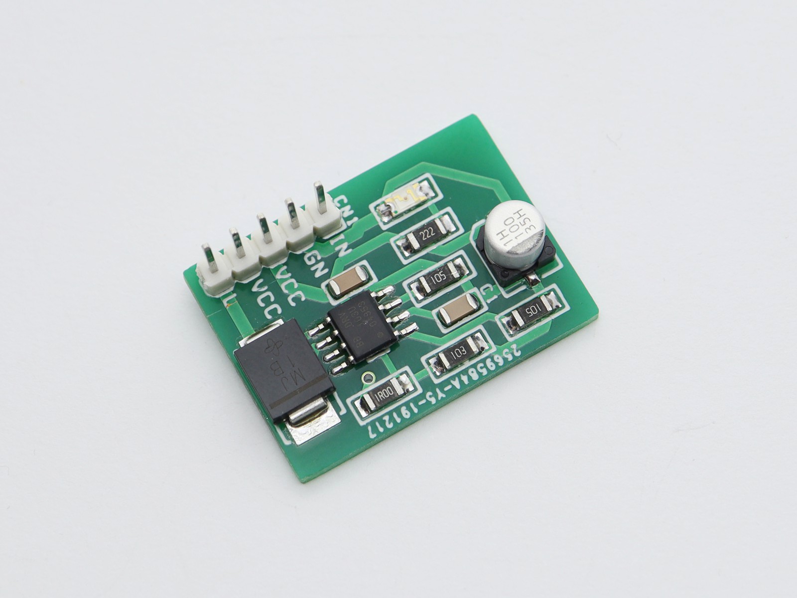

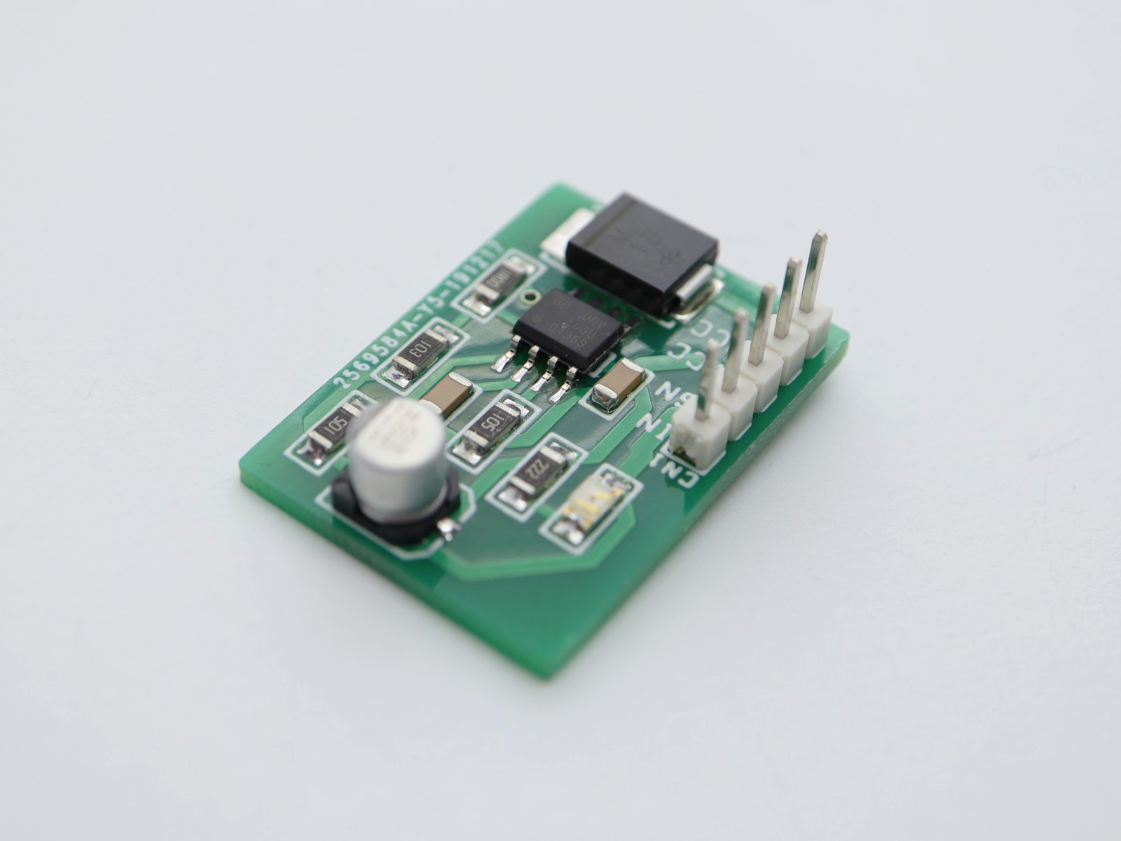

This tiny module is a PWM Solenoid and Valve driver using the Texas instrument’s DRV103 low-side DMOS power switch, employing a pulse-width modulated (PWM) output. Its rugged design is optimized for driving electromechanical devices such as valves, solenoids, relays, actuators, motors, and positioners.
This tiny module is a PWM Solenoid and Valve driver using the Texas instrument’s DRV103 low-side DMOS power switch, employing a pulse-width modulated (PWM) output. Its rugged design is optimized for driving electromechanical devices such as valves, solenoids, relays, actuators, motors, and positioners. This board is also ideal for driving thermal devices such as heaters, coolers, lamps etc. PWM operation conserves power and reduces heat rise, resulting in higher reliability. In addition, adjustable PWM allows fine control of the power delivered to the load. Output delay time and oscillator frequency are also externally adjustable.
The DRV103 can be set to provide a strong initial closure, automatically switching to a “soft” hold mode for power savings. A resistor, analog voltage, or Digital-to-Analog(D/A) converter can control the duty cycle. An output OK flag indicates when thermal shutdown or over current occurs.
- Supply 8V to 32V DC
- Load Capacity 1.5A
- Trigger Input Voltage 1.5V to 5V DC
- Thermal and Current Limit Shutdown
- On-Board Power LED
- PCB dimensions: 28.25 x 20.63 mm

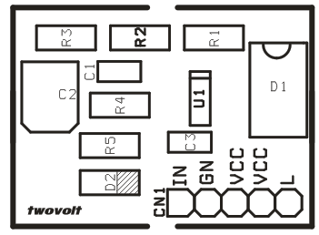

- Oscillator Frequency range 500Hz to 100Khz, the default set to 5Khz, Frequency can be altered by changing R4 ( Refer to Datasheet for more details)
- Delay Output: Default delay set to approx. 100 ms, Delay can be adjusted by changing Capacitor C1
- Duty Cycle is adjustable 10% to 95% , the default set to 95% can be altered by changing R3 (Refer to Datasheet for more details)
Schematic

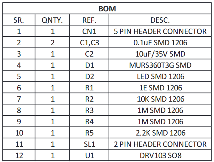

Parts List
| SR | QNTY | REF | DESC | MOUSER |
| 1 | 1 | CN1 | 5 PIN HEADER CONNECTOR | 523-G800W303018EU |
| 2 | 2 | C1,C3 | 0.1uF SMD 1206 | 80-C1206C104K6RACTU |
| 3 | 1 | C2 | 10uF SMD 35V | UWT1V100MCL1GB |
| 4 | 1 | D1 | MURS360T3G SMD | 78-VS-4ECU06-M3/9AT |
| 5 | 1 | D2 | LED RED SMD 1206 | 710-150120RS75000 |
| 6 | 1 | R1 | 1R SMD 1206 | RT1206FRE071RL |
| 7 | 1 | R2 | 10K SMD 1206 | RT1206FRE0710KL |
| 8 | 2 | R3, R4 | 1M SMD 1206 | 603-RT1206FRE071ML |
| 9 | 1 | R5 | 2.2K SMD 1206 | 603-RT1206FRE072K2L |
| 10 | 1 | U1 | DRV103 SMD SOIC8 | 595-DRV103U/2K5 |

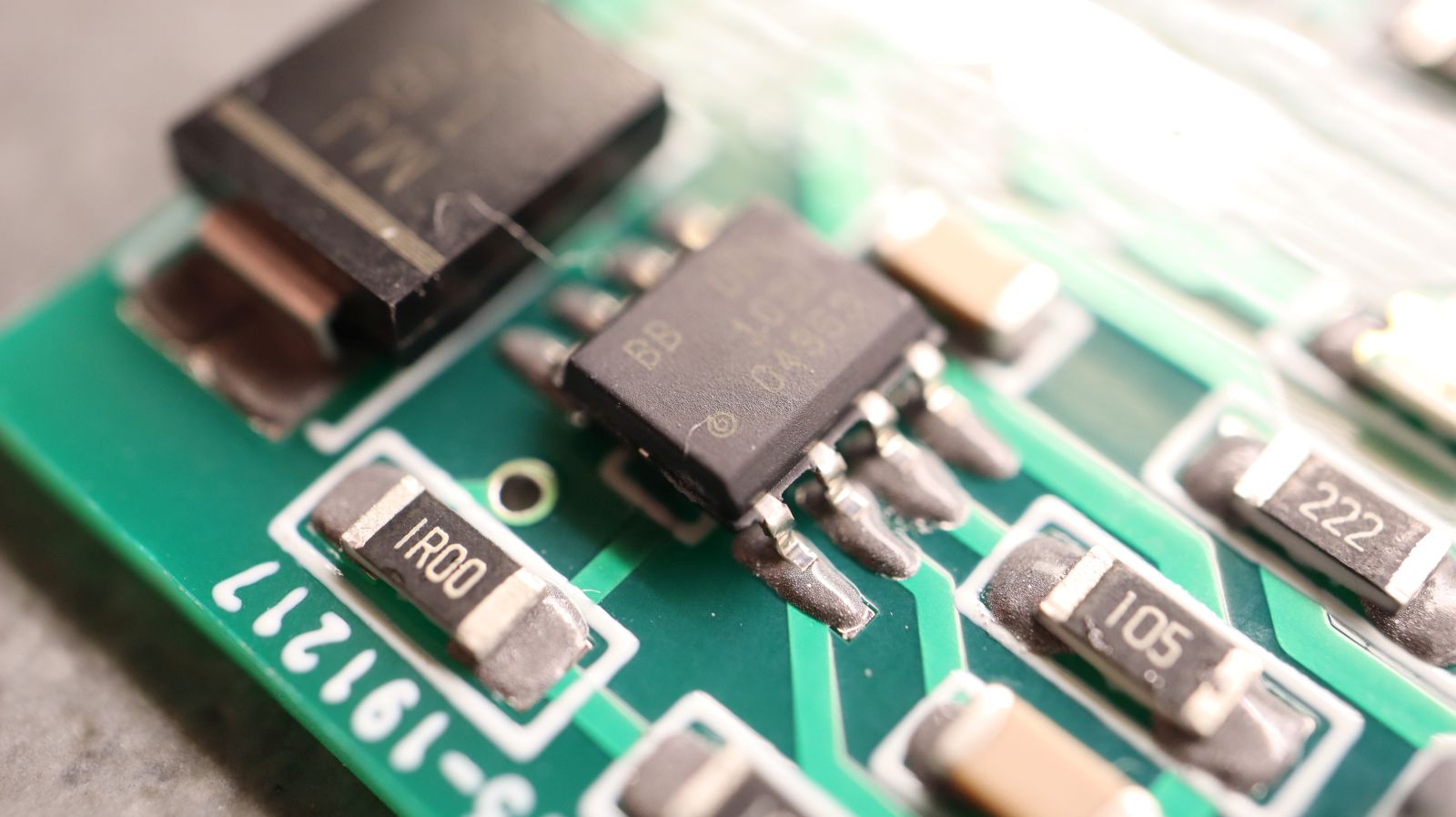

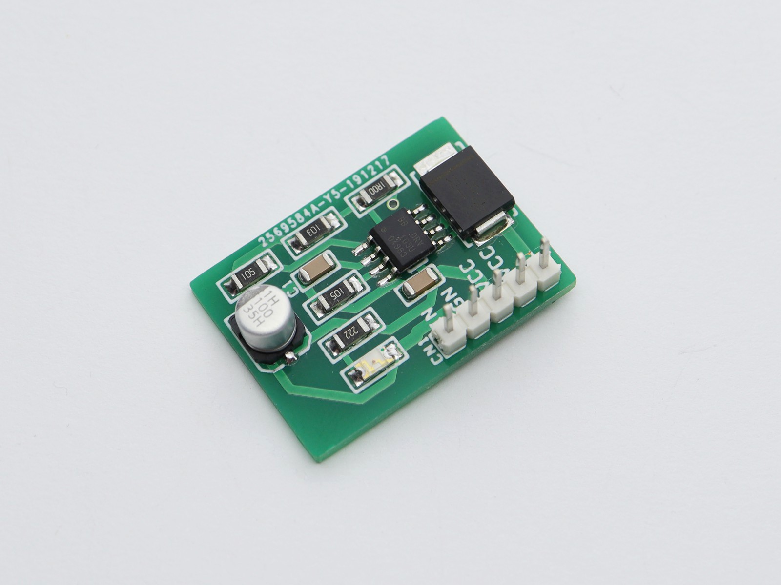

Photos

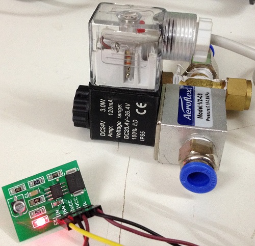

Measurements

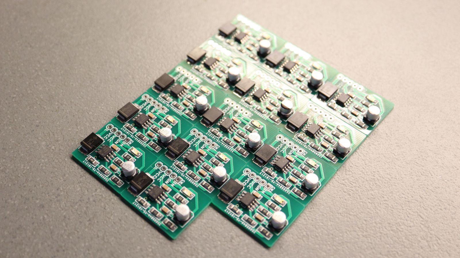

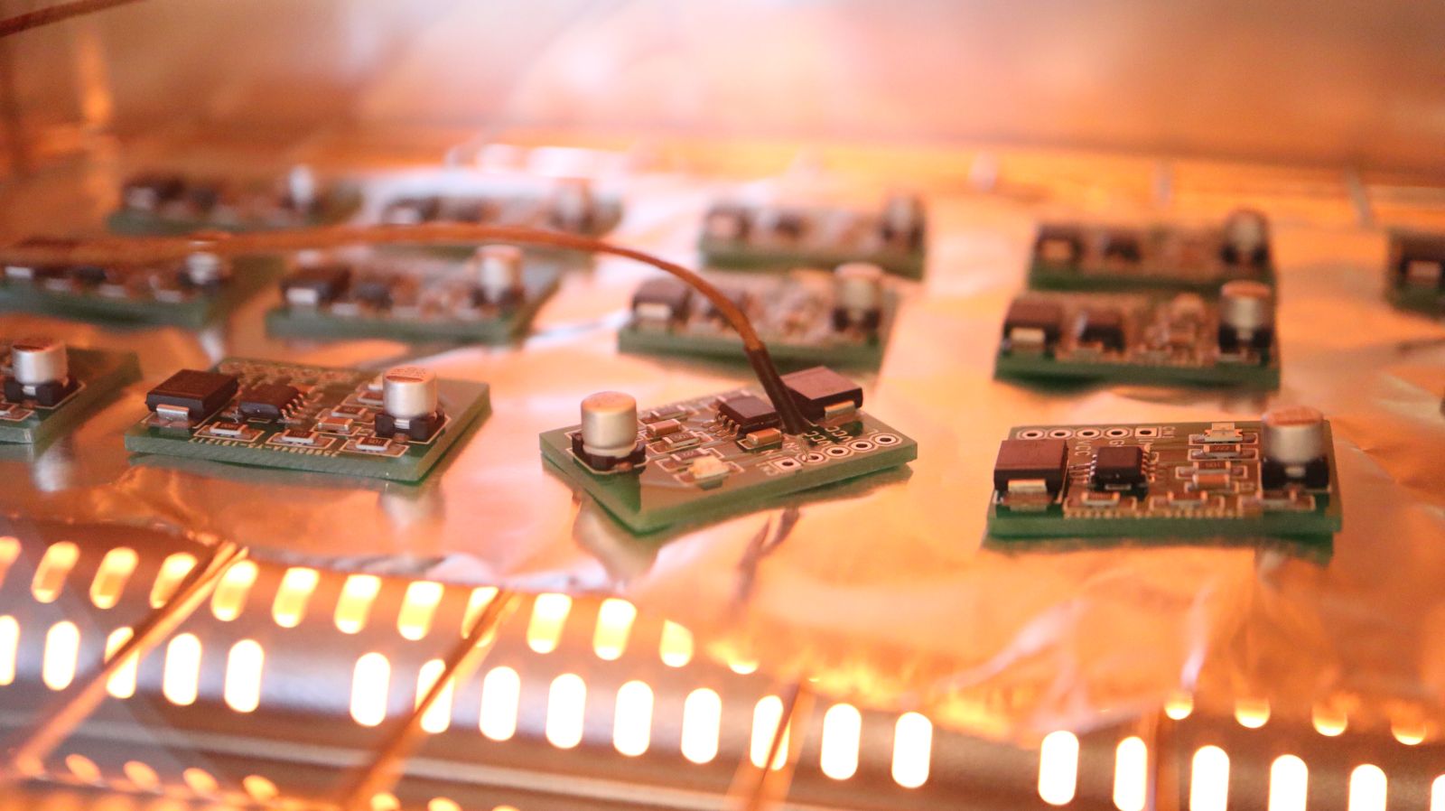

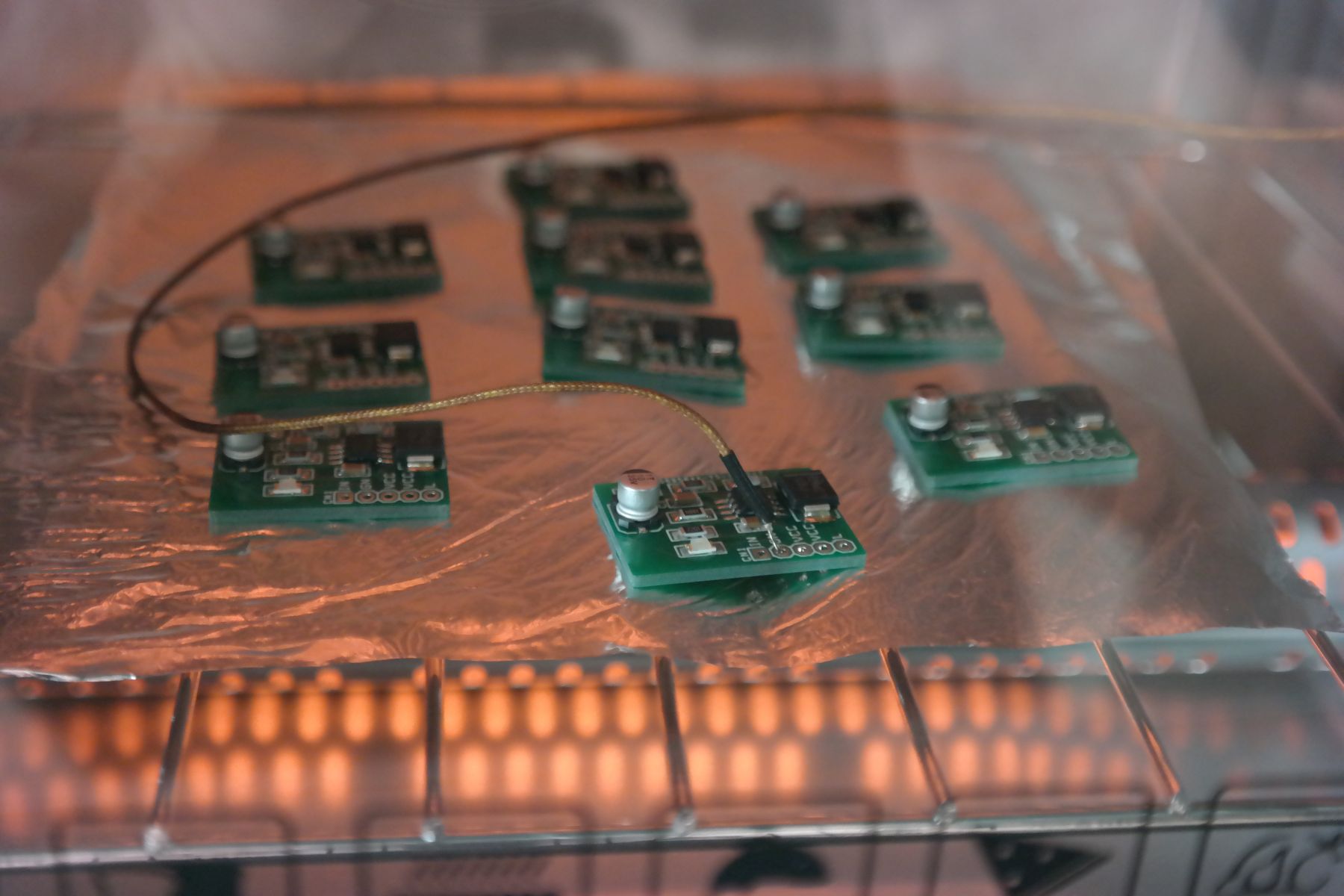

Manufacturing
