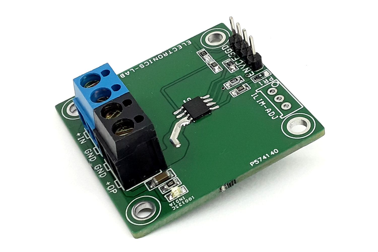

Variable Over-Current Detection Load Switch

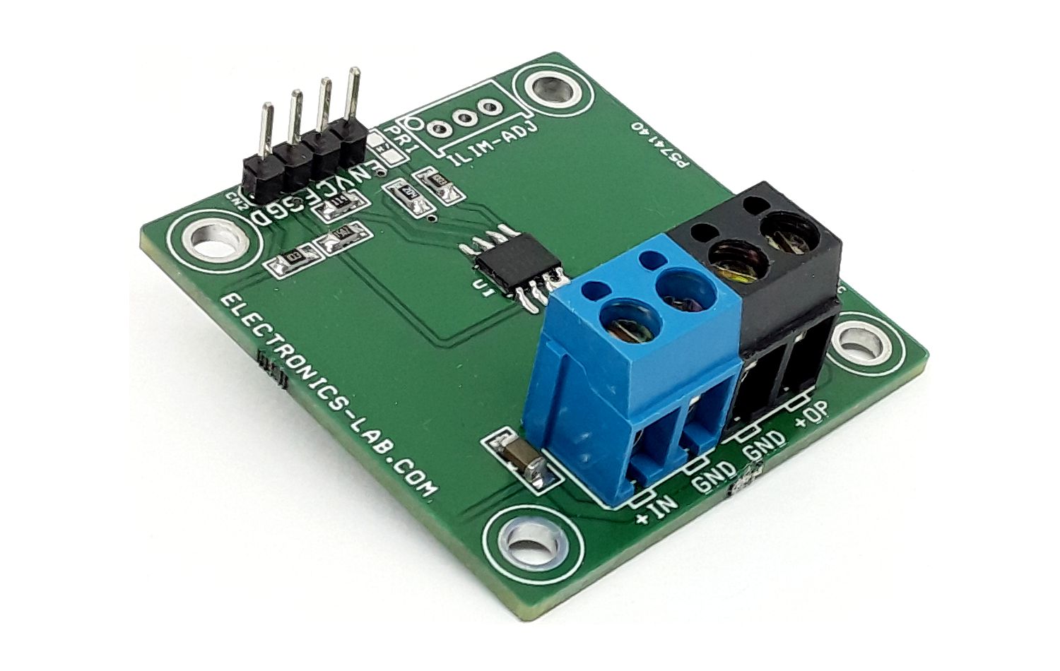

This over-current latch load switch provides over-current protection, thermal shutdown protection, soft-start function, and low power OFF function. The Overcurrent protection function is activated when the load is shorted.
This over-current latch load switch provides over-current protection, thermal shutdown protection, soft-start function, and low power OFF function. The Overcurrent protection function is activated when the load is shorted. This protection function is effective in preventing damage due to sudden and unexpected incidents. It is also equipped with an error flag notification pin which indicates thermal shutdown and over-current condition. The project can help to protect the connected device from overcurrent, monitoring of various power lines, and power management. The board operates from 12V DC to 24V DC. The power LED indicates the output. Screw terminals provided for an easy connection of input and output supply. For the Fault function, additional 5V VCC DC input is required, otherwise, the VCC is not required. The circuit is normally enabled, and you can connect enable pin to GND to disable the output. Output is latching type; power is OFF when a fault condition occurs and sequence can be reversed with power OFF or Disable/Enable Pin.

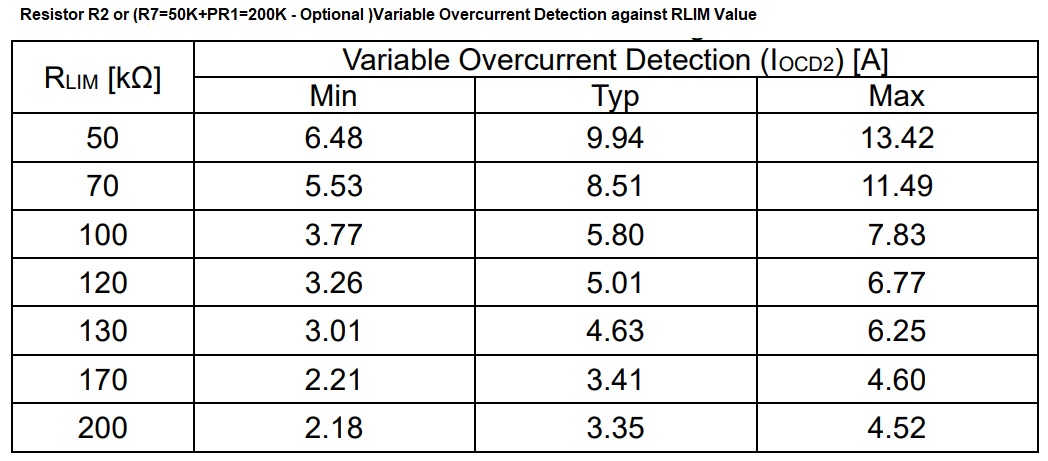

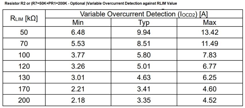

Note1: Default over current threshold = 3.35A, this can be increased by changing the value of resistor R2 (Between 3.35A to 10A/ R2=200K Ohms to 50K Ohms), Optional Onboard multiturn potentiometer is provided for easy adjustment of the current range, Use R7=50K, PR1=200K Ohms- Bourns Inc Type 3296, and do not install R2 in this case.
Note2: PCB has a small thermal area for power dissipation for current loads up to 3.35A, it is important to use Fan when a higher current threshold is selected.
  • Operating Supply 12V DC to 24V
  • Operating Current 3mA + 5mA LED = 8mA Approx
  • Load Current 3Amps
  • Output Load Voltage 12V-24V DC
  • Output On Resistance 45mOhms
  • Over Current Threshold 3.35A (Adjustable 3.35A to 10Amps, Read Note)
  • Over Current Protection Function (Latch OFF)
  • Thermal Shutdown Protection Function (TSD)
  • Low Voltage Output OFF Function (UVLO) Threshold 6V
  • Standby Current 5uA + LED Current
  • Operating Temperature -40C to +85C
  • Error Flag Notification Output, Normally High ( VCC=5V)

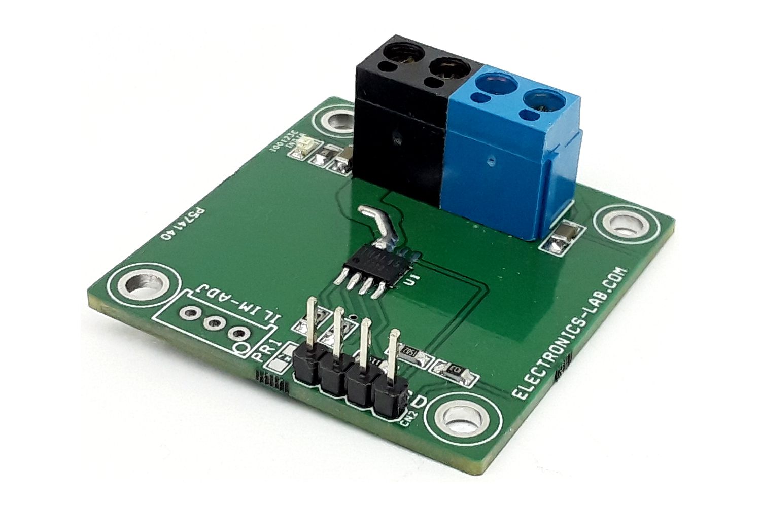

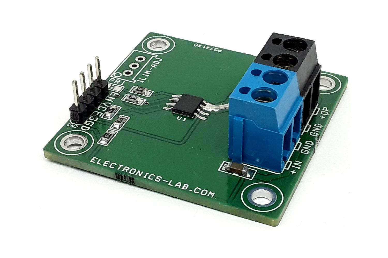

  • PCB Dimensions 40.64 x 39.69mm
  • 4 X 3MM Mounting Holes

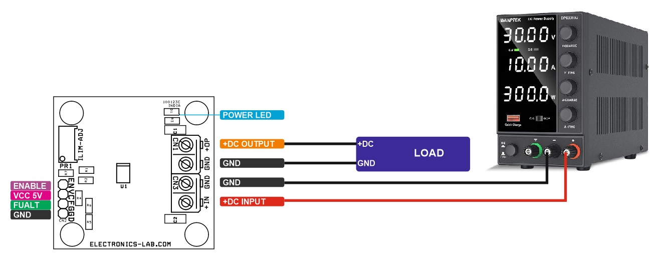

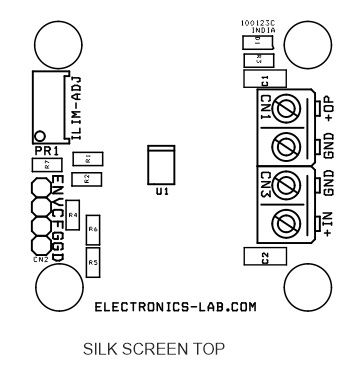

Connections and Other Details
  • CN1: Pin 1 = +12V to +24V DC Output, Pin 2 = GND
  • CN2: Pin 1 = Enable (Default Enabled, Connect to GND = Disable), Pin 2 = VCC 5V DC Flag Pull-Up Supply, Pin 3 = Flag Output (Default High, Low= When Fault Condition Occurs), Pin 4 = GND
  • CN3: Pin 1 = +12V to +24V DC Input, Pin 2 = GND
  • D1: Output Power LED
  • R2: Current Limit Adjust, Refer Figure
  • PR1 + R7: Optional for Adjustable Current Limit

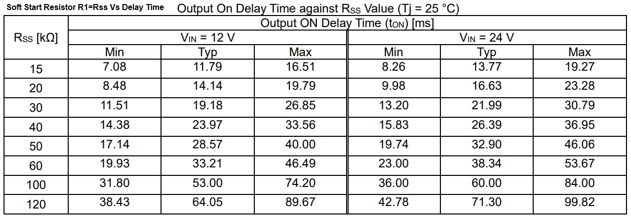

  • R1: Soft Start Delay 50mS (Refer Figure to change Delay)

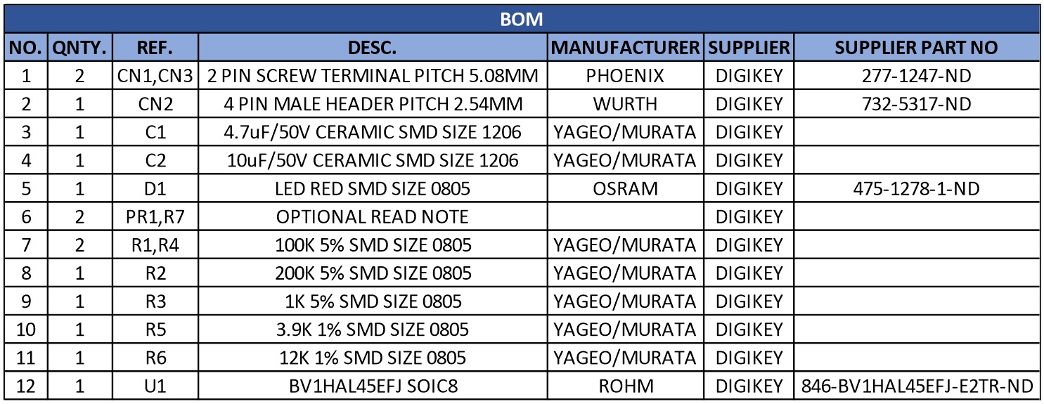

Parts List
NO.QNTY.REF.DESC.MANUFACTURERSUPPLIERSUPPLIER PART NO
12CN1,CN32 PIN SCREW TERMINAL PITCH 5.08MMPHOENIXDIGIKEY277-1247-ND
21CN24 PIN MALE HEADER PITCH 2.54MMWURTHDIGIKEY732-5317-ND
31C14.7uF/50V CERAMIC SMD SIZE 1206YAGEO/MURATADIGIKEY
41C210uF/50V CERAMIC SMD SIZE 1206YAGEO/MURATADIGIKEY
51D1LED RED SMD SIZE 0805OSRAMDIGIKEY475-1278-1-ND
62PR1,R7OPTIONAL READ NOTEDIGIKEY
72R1,R4100K 5% SMD SIZE 0805YAGEO/MURATADIGIKEY
81R2200K 5% SMD SIZE 0805YAGEO/MURATADIGIKEY
91R31K 5% SMD SIZE 0805YAGEO/MURATADIGIKEY
101R53.9K 1% SMD SIZE 0805YAGEO/MURATADIGIKEY
111R612K 1% SMD SIZE 0805YAGEO/MURATADIGIKEY
121U1BV1HAL45EFJ SOIC8ROHMDIGIKEY846-BV1HAL45EFJ-E2TR-ND
Connections
Load Current Adjustment
Softstart Delay Adjust

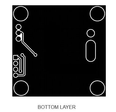

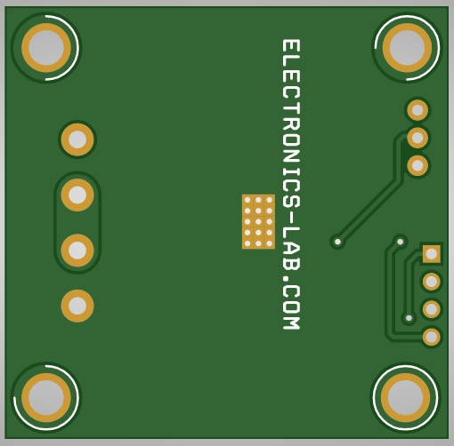

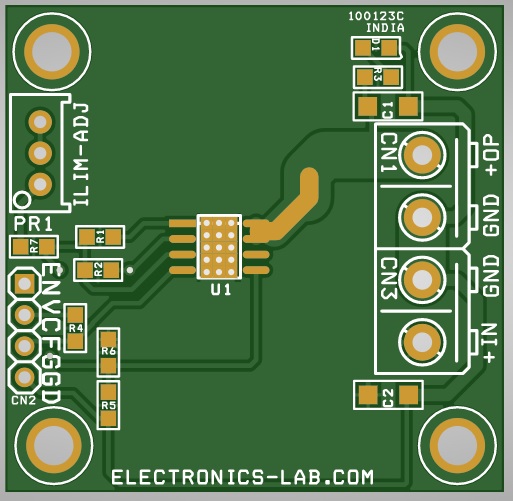

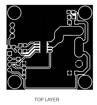

Gerber View

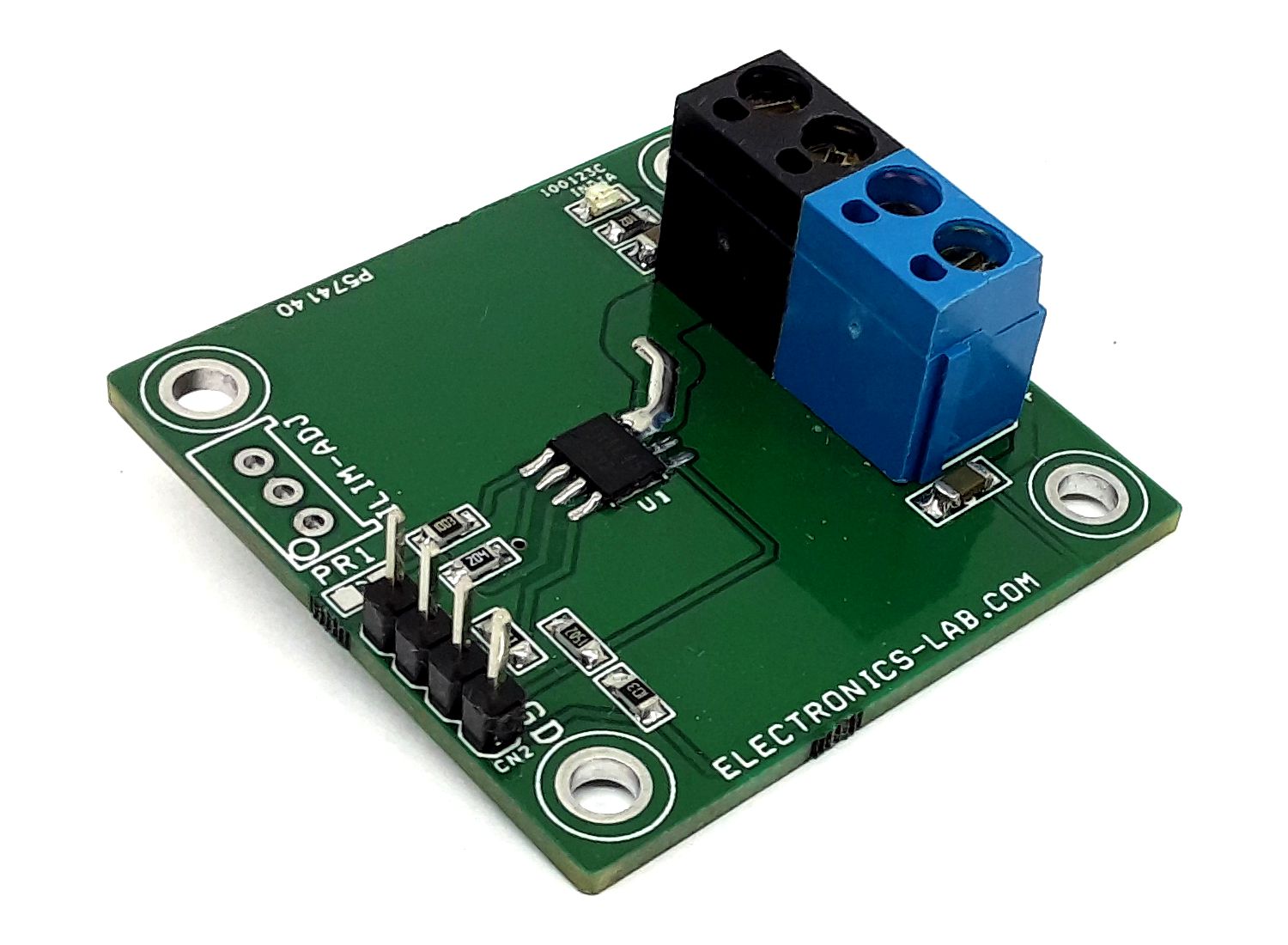

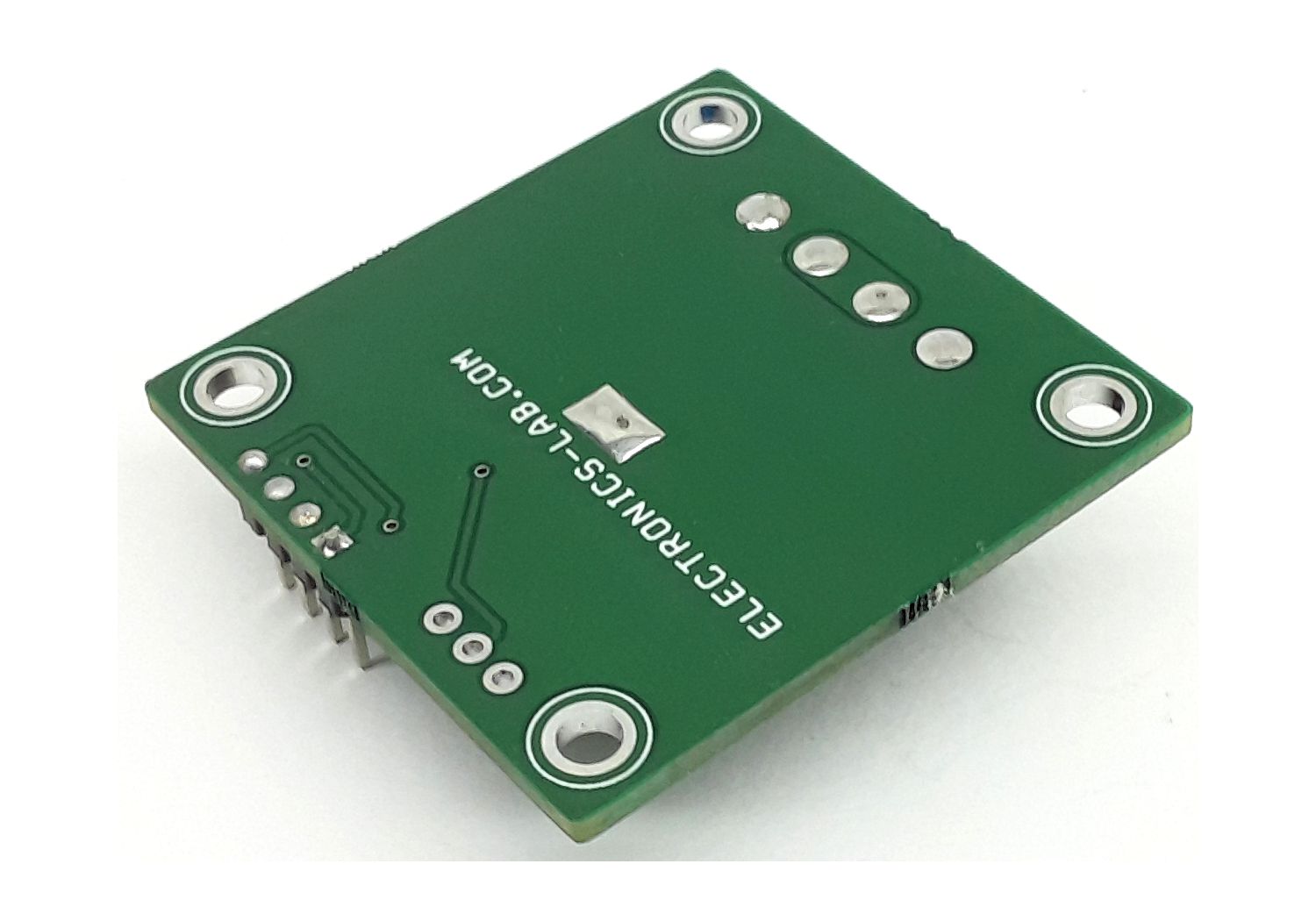

Photos
