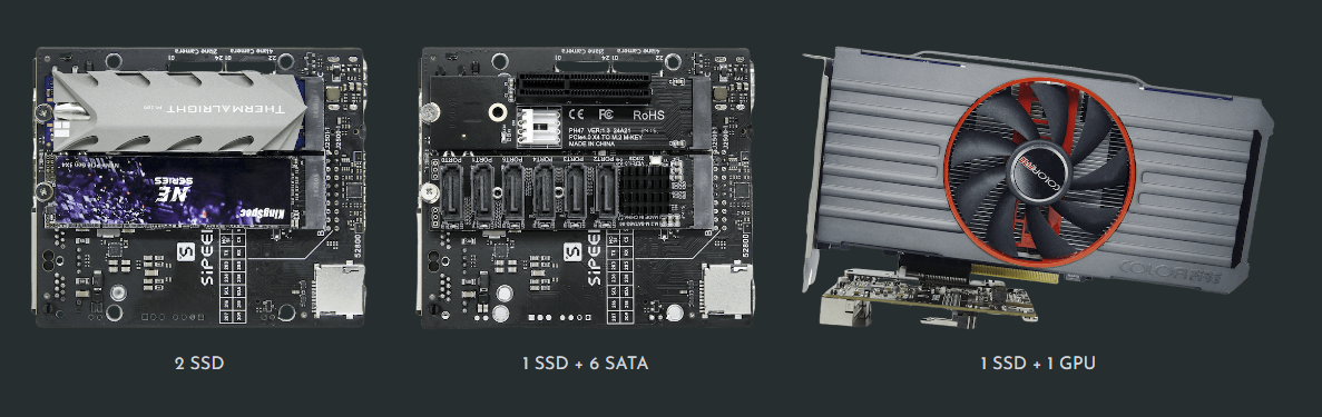

The Lichee Pi 3A supports flexible storage solutions with options for a MicroSD Card, 32GB eMMC, or NVMe SSD. It features two M.2 M-Key slots with PCIe 2.0 x2 each, allowing for the addition of high-speed peripherals and storage devices, offering fast data access. Camera support includes a 4-lane MIPI CSI and a 2-lane MIPI CSI, capable of up to 4K resolution at 60fps. Video capabilities feature H.265 and H.264 encoding and decoding at 1080p and 60fps, making it suitable for multimedia applications. The integrated GPU, an IMG BXE-2-32@819M, supports OpenGL ES 3.2, OpenCL 3.0, and Vulkan 1.3, delivering 20 GFLOPS of performance for graphics-intensive tasks.
Lichee Pi 3A PCIe Options
