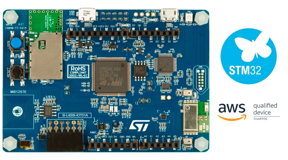

STM32L4+ Discovery kit IoT node, low-power wireless, BLE, NFC, WiFi
With the B-L4S5I-IOT01A Discovery kit for IoT node, users develop applications with a direct connection to cloud servers. The Discovery kit enables a wide diversity of applications by exploiting low-power communication, multiway sensing and Arm® Cortex®-M4 core-based STM32L4+ Series features.
With the B-L4S5I-IOT01A Discovery kit for IoT node, users develop applications with a direct connection to cloud servers. The Discovery kit enables a wide diversity of applications by exploiting low-power communication, multiway sensing and Arm® Cortex®-M4 core-based STM32L4+ Series features. The support for ARDUINO® Uno V3 and Pmod™ connectivity provides unlimited expansion capabilities with a large choice of specialized add-on boards.
Key Features
  • Ultra-low-power STM32L4+ Series STM32L4S5VIT6 microcontroller based on the Arm® Cortex®-M4 core with 2 Mbytes of Flash memory and 640 Kbytes of RAM in LQFP100 package
  • 64-Mbit Quad-SPI Flash memory from Macronix™
  • Bluetooth® 4.1 module (SPBTLE-RF) from STMicroelectronics
  • 802.11 b/g/n compliant Wi-Fi® module (ISM43362-M3G-L44) from Inventek Systems
  • Dynamic NFC tag based on ST25DV04K with its printed NFC antenna
  • 2 digital omnidirectional microphones (MP34DT01) from STMicroelectronics
  • Capacitive digital sensor for relative humidity and temperature (HTS221) from STMicroelectronics
  • High-performance 3-axis magnetometer (LIS3MDL) from STMicroelectronics
  • 3D accelerometer and 3D gyroscope (LSM6DSL) from STMicroelectronics
  • 260-1260 hPa absolute digital output barometer (LPS22HB) from STMicroelectronics
  • Time-of-flight and gesture-detection sensor (VL53L0X) from STMicroelectronics
  • Highly-secure solution (STSAFE-A110) from STMicroelectronics
  • 2 push-buttons (user and reset)
  • USB OTG FS with Micro-AB connector
  • ARDUINO® Uno V3 expansion connector
  • Pmod™ expansion connector
  • Flexible power-supply options: ST-LINK, USB VBUS or external sources
  • On-board ST-LINK/V2-1 debugger/programmer with USB re-enumeration capability: mass storage, Virtual COM port, and debug port
  • Comprehensive free software libraries and examples available with the STM32Cube MCU Package
  • Support of a wide choice of Integrated Development Environments (IDEs) including IAR™, Keil®, and STM32CubeIDE
