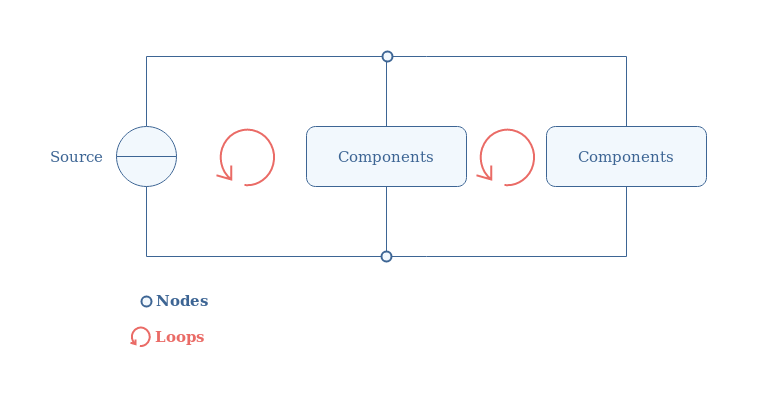

The framework to apply Kirchoff’s laws is electrical circuits, which consist of a power source or generator with both poles connected with the intermediate of components in a closed-loop configuration. Electrical circuits are drawn according to the lumped-element model, which assumes the components to be ideals, and the associated representation is shown in Figure 1 below:
fig 1: Lumped-element model of an electrical circuit
We can give some specific details concerning the topology of the circuits. The straight lines are ideal connections/wires between the different elements of the circuits, which means that they present no resistive or reactive behavior, hence there are no power loss or phase-shift phenomena.
The source provides the circuit with power, which consists of voltage and current signals (either DC or AC). The components are passive, they consist of associations of resistor, capacitor, and inductor. They can either be connected in parallel, such as in Figure 1, or in series. Active components such as amplifiers are not considered in this tutorial since an external source of power is associated with them. A group of components connected at both terminals with wires is called a branch.
Two important topological definitions are important in order to fully understand Kirchoff’s laws later on: the nodes and loops. Nodes represent the junctions between branches, and they are highlighted in Figure 1 by blue circles. The loops are highlighted by red circle arrows in the previous Figure, and it represents a closed path of branches.

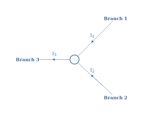

The current law is also known as nodal or junction law and states that the algebraic sum of the currents meeting at a node is equal to zero. A simple example can be illustrated with a node connecting three branches:
fig 2: Node junction of three branches
The law states therefore that the sum of the currents entering the node is equal to the current(s) exiting the junction. In our example, this sentence mathematically translates to I1+I2=I3 or I1+I2-I3=0, the current I3 is negative because it is exiting the node.

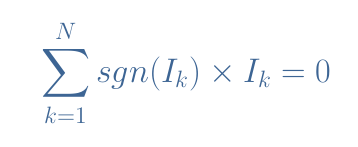

In the general case, a nodal junction of N branches which currents are labeled I1, I2,…, IN satisfies the following Equation 1:
eq 1: Kirchoff’s current law
The sign function sgn is equal to +1 if the current Ienters the node or -1 if it exists it.
The nodal law is directly written from the observation that the charge in a closed system is invariant. This assumption is also known as the charge conservation principle.

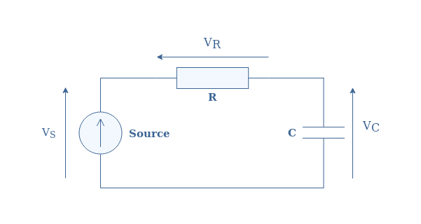

The voltage law is also known as the loop rule, it is very similar to the nodal rule but applies to loops instead of the nodes. This second law states that the algebraic sum of voltages in a circuit loop is equal to zero. A simple example can be illustrated with a DC source powering a series RC filter:
fig 3: Loop with three different voltages
The sign of the voltages is determined with the direction of the arrows, usually, the source is considered positive so that the clockwise arrows are positive and the counterclockwise are negative. The Kirchoff voltage law states therefore that VS=VR+VC or VS-VR-VC=0.

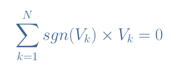

For a loop with N generation and drop of voltages V1, V2,…, VN, Equation 2 is satisfied:
eq 2: Kirchoff’s voltage law
The sign function sgn is equal to +1 when a voltage is generated (the source in our example) or -1 when a drop is observed (with the passive components in Figure 3).

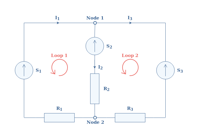

In this section, we show the resolution process of typical problems that can be solved by using KCL. Consider three sources S1, S2 and S3 connected with resistors R1, R2 and R3 in the configuration shown in Figure 4:
fig 4: Example of circuit configuration
The sources are DC and ideal, meaning that they present no internal resistances. We take S1=4 V, S2=3 V, S3= 10 V, and R1=3 Ω, R2=2 Ω, R3=1 Ω.
From Kirchoff’s current law, we can write the following equalities for Nodes 1 and 2:
  • Node 1: I1=I2+I3
  • Node 2: I2+I3=I1 which is similar than the equation of Node 1
From Kirchoff’s voltage law, we write the equalities for Loops 1 and 2:
  • Loop 1: S1=S2+R2×I2+R1×I1
  • Loop 2: S2+R2×I2=S3+R3×I3
We can differently write these equations to obtain the following system of 3 equations with 3 unknown parameters I1, I2 and I3:
eq 3: KCL linear system of equation
This system can be solved with the elimination method which consists of replacing I1 by I2+I3 in the second line (L2) and eliminate the term I3 by doing the addition R3×L2+R1×L3.
We find directly I2=4.2 A, we can then find I3 by replacing I2 in L3 which gives I3=1.4 A and finally we get I1=I2+I3=5.6 A.
