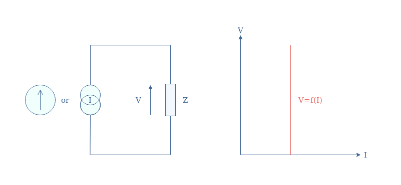

Presentation
An ideal current source is a device that can supply a constant and stable value of current regardless of the voltage that must be provided to a specific output load. The ideal current sources are represented by a double circle or an arrow within a circle such as illustrated in Figure 1 below:
fig 1: Ideal current source supplying a load of impedance Z (left) and its associated voltage/current characteristic (right)
The characteristic of an ideal current source is sometimes represented I=f(V) as the representation above in Figure 1 is, strictly mathematically speaking, not a function but a distribution.

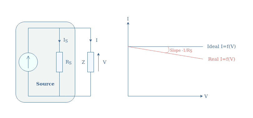

Real current sources
The internal power losses that take place in a current source can be modelized by a resistor (RS) associated in parallel. The I/V characteristic is not anymore flat but, such as for voltage sources, is corrected with a slope of value -1/Rs such as illustrated in Figure 2:
fig 2: Real current source supplying a load of impedance Z (left) and its associated current/voltage characteristic (right)
We can note that an ideal current source is equivalent to a real source which resistance RS tends to +∞ (open circuit).

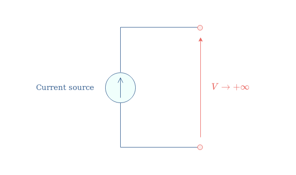

First of all, the terminals of a current source must not be placed in an open circuit:
fig 3: Current source in open circuit, forbidden connection
The resistance of an open circuit is +∞, when the source provides a current that is not equal to zero, the voltage quantity tends to +∞, which is not possible. In practice, the voltage will increase until its breakdown value, forcing the air/vacuum between the source terminals to become conductive. This phenomenon often leads to the destruction of the source or at least one of its components.

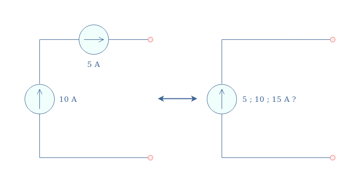

Moreover, the series connection of two or many current sources is also proscribed, even if both sources supply the same current value.
fig 4: Current sources in a series configuration, forbidden connection
The reason why this type of connection is not allowed is that an equivalent circuit cannot be predicted: will the sources add, or only one will effectively work?
The current in a branch of a circuit can only take one value, there cannot be an overlay of many currents.

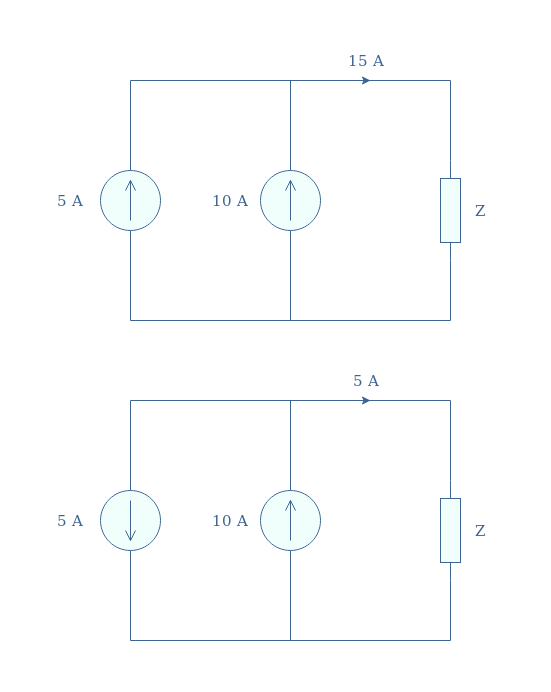

Finally, the parallel association of current sources is absolutely allowed and recommended to obtain a higher output current:
fig 5: Current sources in a parallel configuration, allowed connection
As shown in the second circuit in Figure 5, the values can also be subtracted if one of the sources is oriented in the opposite direction.
In a parallel configuration, the output current is the algebraic sum of the current sources involved in the supply process.

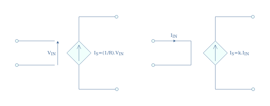

The current value of dependent current sources can be tuned with an external parameter. There are two types of dependent current sources: Voltage Controlled Current Sources (VCCS) and Current Controlled Current Sources (CCCS). In a circuit diagram, current dependent sources are symbolized by an arrow shape (in the direction of the current) surrounded by a diamond pattern:
fig 6: VCCS (left) and CCCS (right)

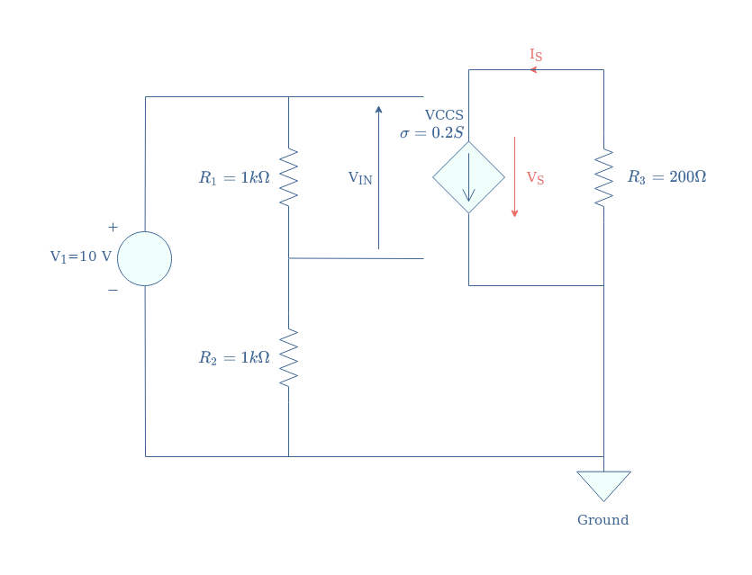

For this type of dependent current source, the nature of the input (voltage) is different than the output (current), the linking factor is labeled σ=1/R and represents a conductivity in Siemens (S) or Ω-1.
We illustrate what a simple circuit containing a VCCS can look like in Figure 7 and show how to compute its input.
fig 7: A VCCS circuit
Since the voltage source V1 supplies a voltage divider 1 kΩ/1 kΩ, the input of VCCS is given by VIN=V1/2=5 V. Since the gain of the VCCS is 0.2 S, the output current of the dependent source is IS=0.2×VIN=1 A. The output voltage is simply computed by applying Ohm’s law to the resistor R3, we obtain VS=IS×R3=200 V.

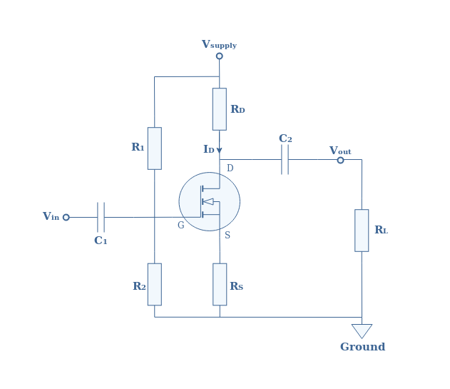

An example of VCCS is the MOSFET amplifier which is a voltage-effect-based transistor:
fig 8: Example of VCCS, the MOSFET supplies an output load RL
As a VCCS, the MOSFET amplifier takes as input a voltage known as gate voltage and delivers an output current known as drain current.

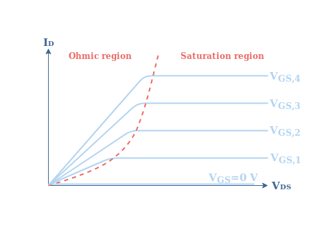

We can affirm that a MOSFET is indeed a current source after looking at its characteristic ID=f(VDS):
fig 9: Output characteristic of a MOSFET
Depending on the command gate voltage (VGS), the characteristic of the MOSFET amplifier becomes flat after a certain value of the output voltage VDS. This characteristic in the saturation region is typical for a current source.

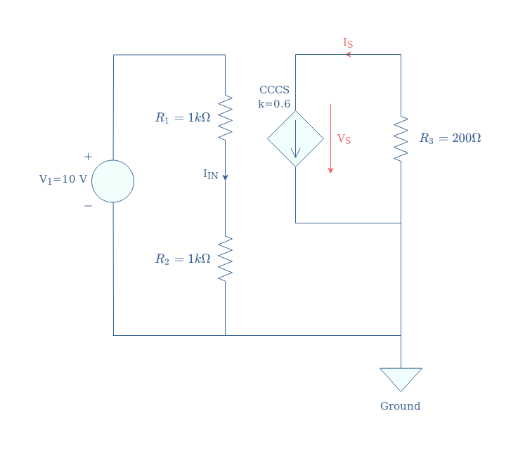

We illustrate again a similar circuit that integrates a CCCS in order to clarify how to retrieve the output quantities:
fig 10: A CCCS circuit
The input current controlling the CCCS is here given directly by Ohm’s law: IIN=V1/(R1+R2)=5 mA. The output current is obtained by multiplying the input current by the gain k, IS=k.IIN=3 mA. Finally, the output voltage is again given by applying Ohm’s law to the resistor R3, VS=IS×R3=0.6 V.

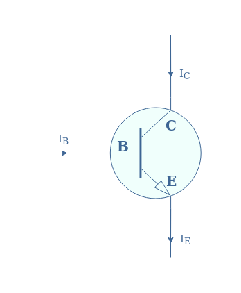

Examples of CCCS are bipolar junction transistors (BJT)-based amplifiers, the reader can refer to the tutorials about Common Emitter Amplifier and Common Collector Amplifier in order to get more details.

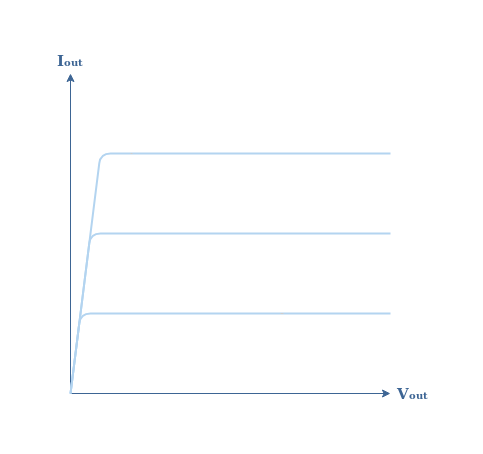

Figure 11 is a plot of the output characteristic in the collector branch (C) for several command base currents (IB):
fig 11: BJT I/V characteristic
We recognize again a flat I/V function after a certain value of voltage, typical for a current source, exactly such as for the MOSFET amplifier.
