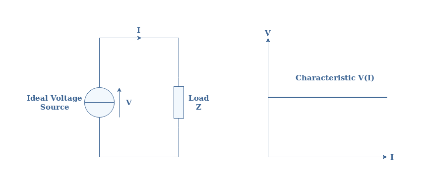

An ideal voltage source consists of a generator that delivers a constant value of voltage regardless of the current flowing in the circuit. This means that the same ideal source will always deliver the same voltage Vs for any circuit connected at its terminals. This property ensures that the voltage/current characteristic of an ideal voltage source is constant and therefore is linear.
fig 1: Representation of an ideal voltage source along with its voltage/current characteristic

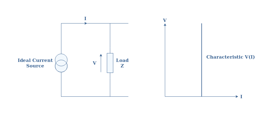

Ideal current sources can also be found in LEC and consist of generators that provide a constant value of current regardless of the voltage at their terminals. A representation of an ideal current source along with its and voltage/current characteristic is proposed in Figure 2 below:
fig 2: Representation of an ideal current source along with its voltage/current characteristic

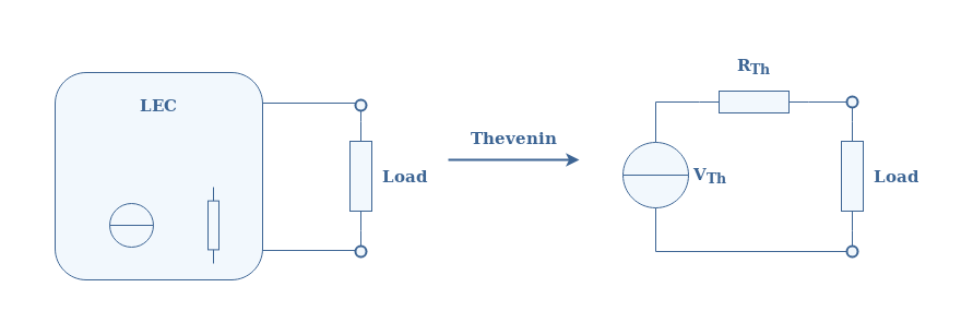

Now that these various definitions have been detailed, we can illustrate Thevenin’s theorem with the following Figure 4:
fig 4: Illustration of Thevenin’s transformation
The simpler circuit obtained from the Thevenin transformation is known as the Thevenin model. The equivalent source and resistance are labeled with the subscript Th as a reference to the name of the theorem.

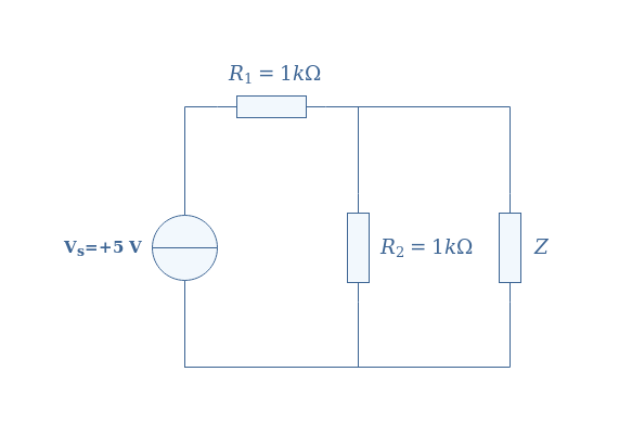

For the first example, we consider a basic LEC composed of only one voltage source and two resistors in a parallel configuration:
fig 5: Single voltage source LEC

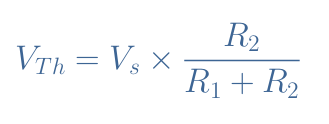

In order to determine Thevenin’s model, first of all, we proceed to steps number 1 and 2 explained in the previous section. When disconnecting the load Z from the circuit, we compute the voltage at the terminals of the LEC, that is to say across the resistor R2, by applying the voltage divider method:
After replacing the parameters by their values, we obtain VTh=2.5 V.

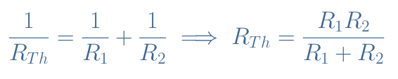

We consider now the circuit by replacing the voltage source by a wire. The equivalent Thevenin resistance is the parallel association of the resistors R1 and R2:
The numerical application gives RTh=500 Ω.

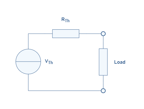

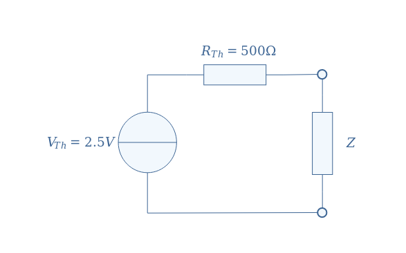

The circuit presented in Figure 5 can, therefore, be simplified by the equivalent Thevenin’s model presented in Figure 6:
fig 6: Thevenin’s model of the single voltage source LEC
The voltage and current across any load Z are now much easier and faster to compute. As an example, if Z=100 Ω, we can use again the voltage divider formula to find VZ=0.4 V. The current is obtained by applying Ohm’s law to the resistance Z: I=VZ/Z=4 mA.

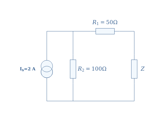

For the second example, we consider a similar circuit than in Figure 5, but replacing the voltage source by an ideal current source and rearranging the resistors:
fig 7: Single current source LEC
First of all, we disconnect the load Z from the circuit in order to determine VTh:
When applying Kirchoff’s Voltage Law in the loop highlighted with the red symbol, we find VTh=V2-V1. However, since the circuit is opened, no current is observed across R1 and therefore VTh=V2. The current flowing in R2 is thus equal to the current source, we finally apply Ohm’s law to R2 in order to find VTh=100×2=200 V.

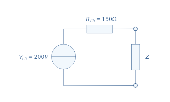

Thevenin’s resistance RTh is found by replacing the current source by an open circuit, the equivalent resistor is determined by the series association of R1 and R2: RTh=R1+R2=150 Ω.
Figure 8 below illustrates the Thevenin model of the circuit presented in Figure 7:
fig 8: Thevenin’s model of the single current source LEC

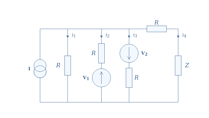

For this last example, we propose a more complex circuit that includes both current and voltage sources:
fig 9: Multi-source LEC
We disconnect the load in order to determine the voltage VTh. It comes automatically that i4=0 since the circuit becomes open. Kirchoff’s current law affirms that I=i1+i2+i3, moreover, we can assert thanks to Kirchoff’s voltage law that:
  • i1=i2+V1/R
  • i1=i3-V2/R

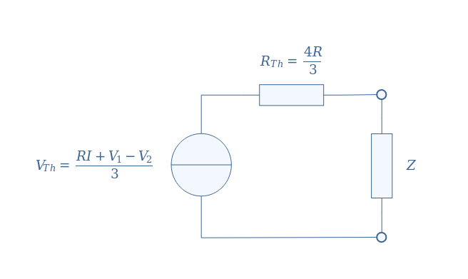

After rearranging these three equations, we can isolate i1=(I+V1/R-V2/R)/3. Thevenin’s voltage is simply given by R×i1, therefore, VTh=(RI+V1-V2)/3.
We replace the current source by an open circuit and shorten the voltage sources in order to determine RTh:
The equivalent resistance is given by the parallel association of 3 resistors in series with R, which leads to RTh=R+R/3=4R/3.
Thevenin’s model of Figure 9 is finally given by:
fig 10: Thevenin’s model of the multi-source LEC
