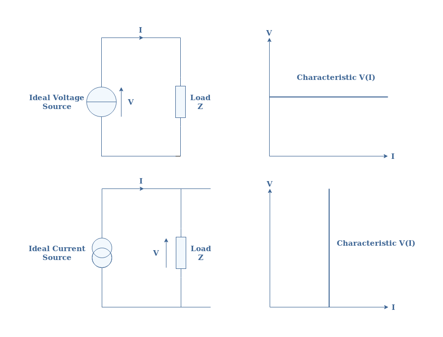

Ideal voltage (resp. current) sources provide a constant value of voltage (resp. current) regardless of the current flowing (resp. voltage) in the circuit. Their representation and behavior are illustrated in Figure 1 below:
fig 1: Representation and characteristics of the ideal sources

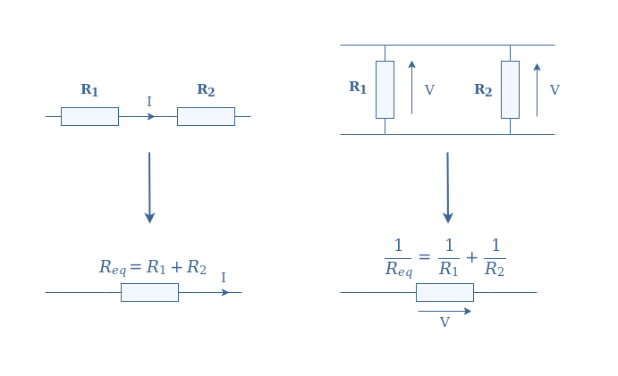

An equivalent resistor Req represents an association of a set of interconnected resistors. The rules to associate resistors together are illustrated in Figure 2 below:
fig 2: Series and parallel resistor associations

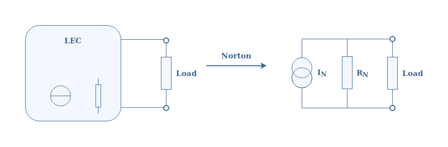

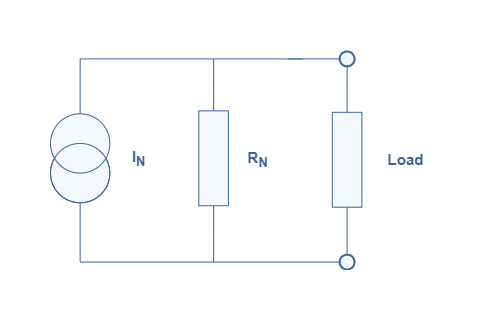

The framework and definition being now clear, we illustrate Norton’s theorem with the following Figure 3:
fig 3: Illustration of Norton’s transformation
Using Norton’s theorem on a LEC leads to a simple circuit known as Norton’s model composed of an ideal current source in parallel with resistors. The equivalent current source and resistor are labeled with the subscript N as a reference to the name of the theorem.

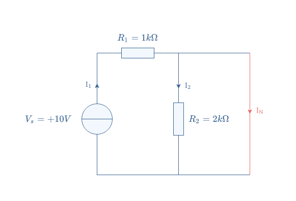

In order to determine the Norton model of this circuit, we remove the load Z and shorten the terminals of the circuit:
We can now determine the Norton current IN, Kirchoff’s current law states that I1=I2+IN. Since IN does not cross any impedances, which means that the resistor R2 is shortened, we can affirm that I2=0.
Norton’s current is therefore equal to the current delivered by the voltage source, it can be computed by applying Kirchoff’s voltage law: Vs=R1I1+R2I2=R1I1 ⇒ IN=Vs/R1=10 mA.

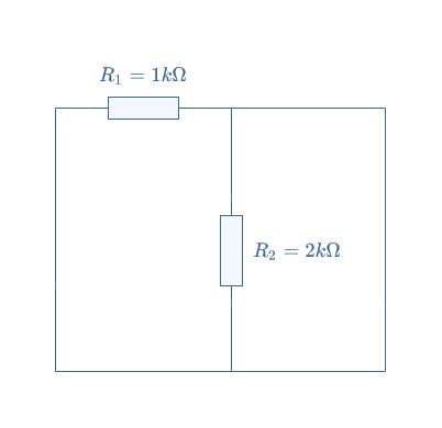

To find Norton’s resistance RN, we replace the voltage source by a wire:
In this configuration, R1 and R2 are in parallel, the equivalent resistance is therefore given by RN=(R1×R2)/(R1+R2)=666 Ω.

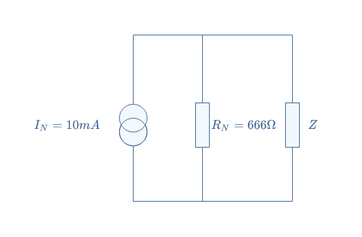

We can now give the Norton model of the circuit presented in Figure 4:
fig 5: Norton’s model of the single voltage source LEC

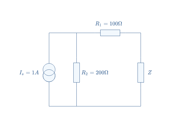

Single Current Source
We consider a similar example than in the previous subsection by replacing the voltage source by a current source:
fig 6: Single current source LEC
We proceed first by removing the load and shortening the terminals of the LEC. We label I2 the current across the resistor R2 and I1=IN the current across the resistor R1. We simply find the Norton current by applying the current divider formula: IN=(R2/(R1+R2)×IS=0.7 A.

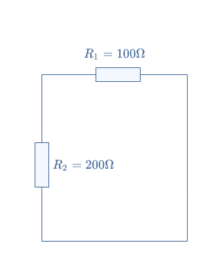

We replace the ideal current source by an open circuit in order to find Norton’s resistance:
The equivalent resistance is simply given by the series associations RN=R1+R2=300 Ω.

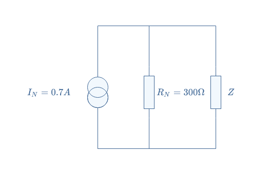

The Norton model of the LEC presented in Figure 6 is finally given by the following circuit:
fig 7: Norton’s model of the single current source LEC

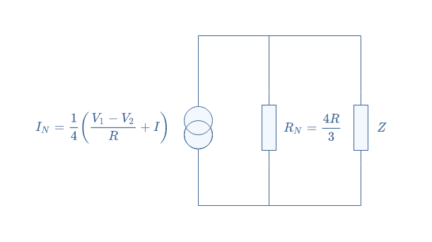

After rearranging these equations to express IN as a function of i1, i2, and i3 in each line, we can finally isolate Norton’s current and find: IN=(V1-V2)/4R+(I/4).
We have already demonstrated in the Thevenin theorem article that RTh=4R/3 and since RN=RTh, the Norton resistance is thus already known.
Norton’s model of this complex circuit is given in Figure 9 below:
fig 9: Norton’s model of the multi-source LEC
