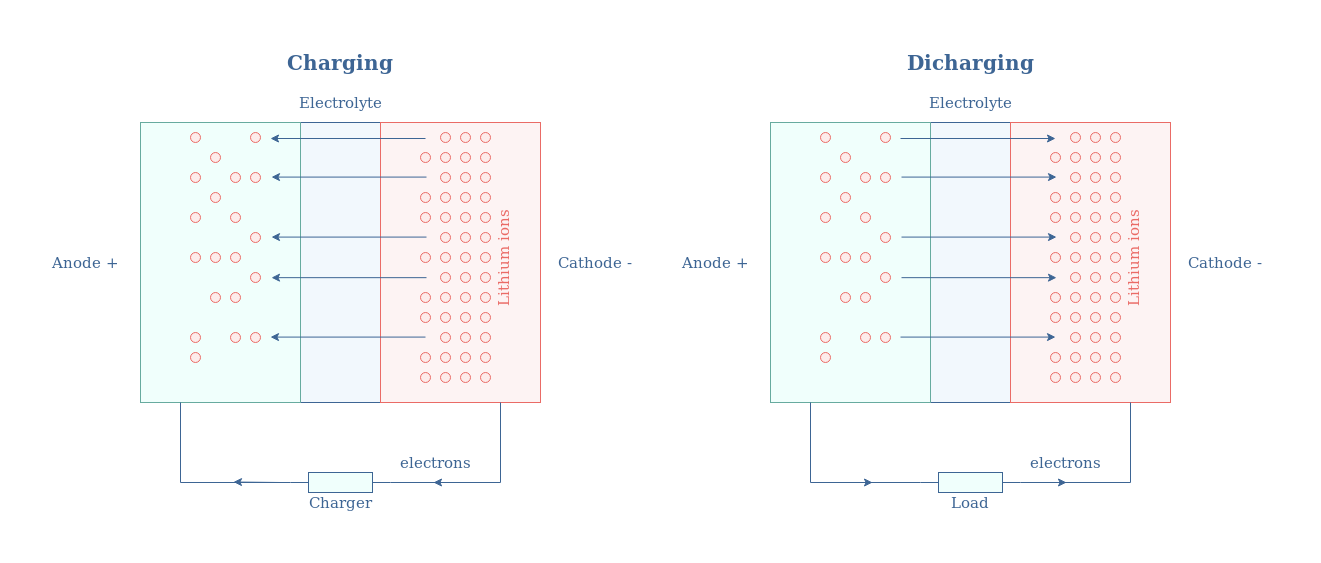

On the other hand, batteries convert chemical energy into a DC signal thanks to a reduction-oxidation reaction. One of the most common types is certainly the lithium-ion battery which function schematic is presented in Figure 2 below:
fig 2: Charging/discharging functioning of a Li-ion battery

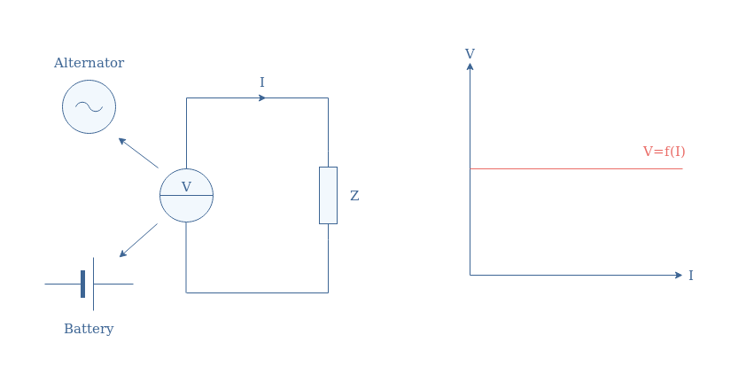

An ideal voltage source is an element that can supply a constant value of voltage regardless of the current flowing through the output load. This definition is both valid for DC or AC voltage sources, in the AC case, it is the RMS value that is kept constant.
The following Figure 3 illustrates how a voltage source is usually drawn in a circuit diagram and its related voltage/current characteristic. Note that no distinction is made between a DC or AC source, the labels V and I can therefore both refer to the DC or RMS values.
fig 3: Ideal voltage source supplying a load of impedance Z (left) and its associated voltage/current characteristic (right)
It is important to remember that ideal voltage sources are characterized by a flat V/I characteristic. The consequence of such a characteristic is that an ideal source can theoretically supply any amount of power (V×I) without any losses.
This affirmation is of course not true, in real sources the power supplied is limited by losses which origins are internal to the source as we will see in the next section.

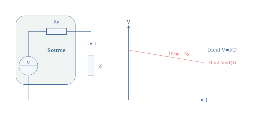

Real voltage sources
As stated previously, real voltage sources do not present a flat V/I characteristic. These power losses affecting the source are modelized by an internal resistance (or source resistance) noted RS and placed in series with the voltage source.
Figure 4 illustrates the circuit diagram of a real voltage source along with its voltage/current characteristic:
fig 4: Real voltage source supplying a load of impedance Z (left) and its associated voltage/current characteristic (right)
The value of RS is an important parameter to characterize voltage sources, it is also known as the voltage regulation.

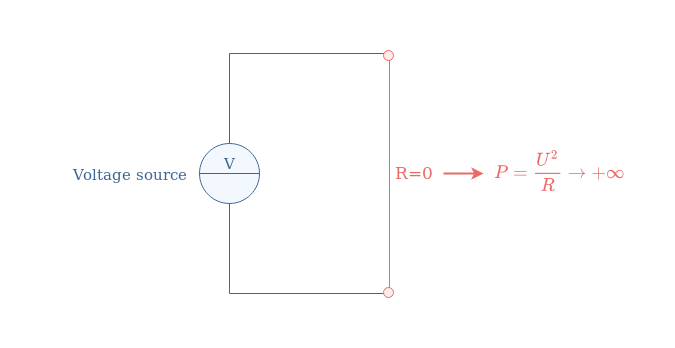

The first and most important one is to not place the voltage source in a short-circuit, we can also say to not short the source, such as illustrated in Figure 5.
fig 5: Voltage source shorted, forbidden connection
Shortening a voltage source is actually equivalent to imposing a potential difference V on a resistance equal to zero, which results in an active power tending to infinity. In practice, the internal resistance of the source and the connection wires will simply be submitted to a strong current resulting in their melting or irreversible damage to the source.

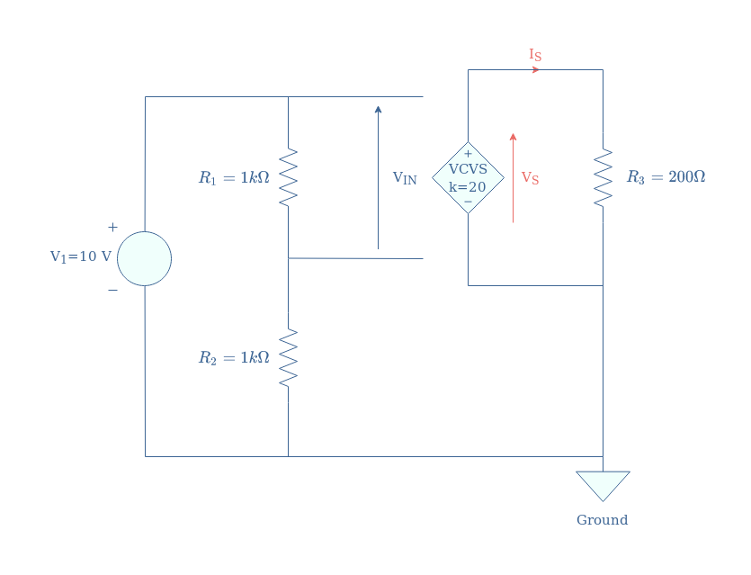

A VCVS is always controlled by a more or less complex circuit that provides an input voltage which will generate an output voltage to power an output load. A typical VCVS circuit is illustrated in Figure 9:
fig 9: A VCVS circuit
In this example, we want to show how to obtain the unknown output parameters VS and IS.
First of all, we can comment that the controlling stage consists of an ideal voltage source providing 10 V to a voltage divider circuit (R1 and R2). Since R1=R2, the output voltage of the voltage divider (or input of the dependent voltage source) is half of Vand equal to VIN=5 V.
Since the gain of the VCVS is set to be 20, we can conclude that VS=20×VIN=100 V. The output current is simply computed with Ohm’s law: IS=VS/R3=0.5 A.

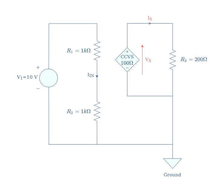

For CCVS, the factor linking the input current to the output voltage is labeled R, which is not a coincidence since it is expressed in Ohm unit (Ω).
A typical CCVS can be designed similarly to the architecture presented in Figure 9 for the VCVS:
fig 10: A CCVS circuit
The input current IIN of the dependent voltage source is simply given by Ohm’s law: IIN=V1/(R1+R2)=5 mA.
The voltage delivered by the CCVS is found by multiplying this input current by the factor R: VS=R×IIN=0.5 V. We apply against Ohm’s law to find the output current IS=VS/R3=2.5 mA.
