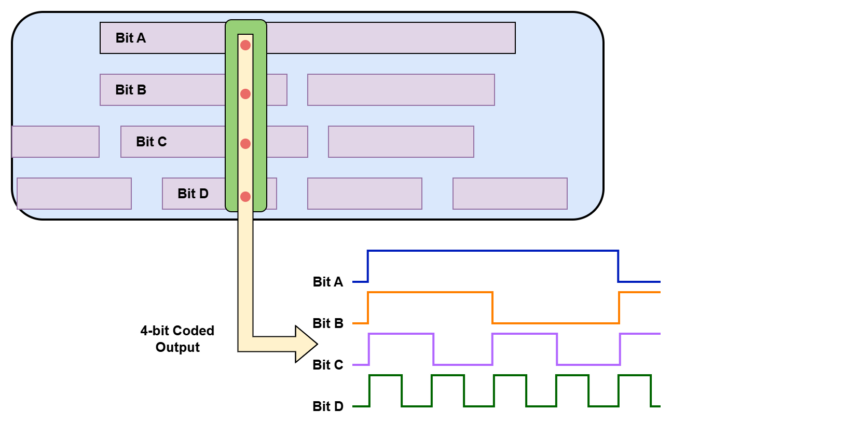

Absolute Position Encoder
Compared to quadrature encoders, Absolute Position Encoders are more complicated. They offer a distinct output code that indicates both position and direction for each rotational position. Multiple concentric “tracks” of light and dark segments make up their coded disk. To concurrently read a distinct coded position value for every angle of movement, each track has its separate light detector. A 12-bit absolute encoder would have 12 tracks, and the same coded value would only show once every revolution. This is because the number of tracks on the disk is correlated with the binary “bit”-resolution of the encoder.
4-bit Binary Coded Disc
Fig-10: 4-bit Binary Coded Disc
One major benefit of an absolute encoder is its non-volatile memory, which keeps the encoder in its precise location without requiring it to return to its “home” position in the event of a power outage. The majority of rotary encoders are classified as “single turn” devices; but there are also multi-turn systems that use additional code disks to collect feedback across several rotations.
