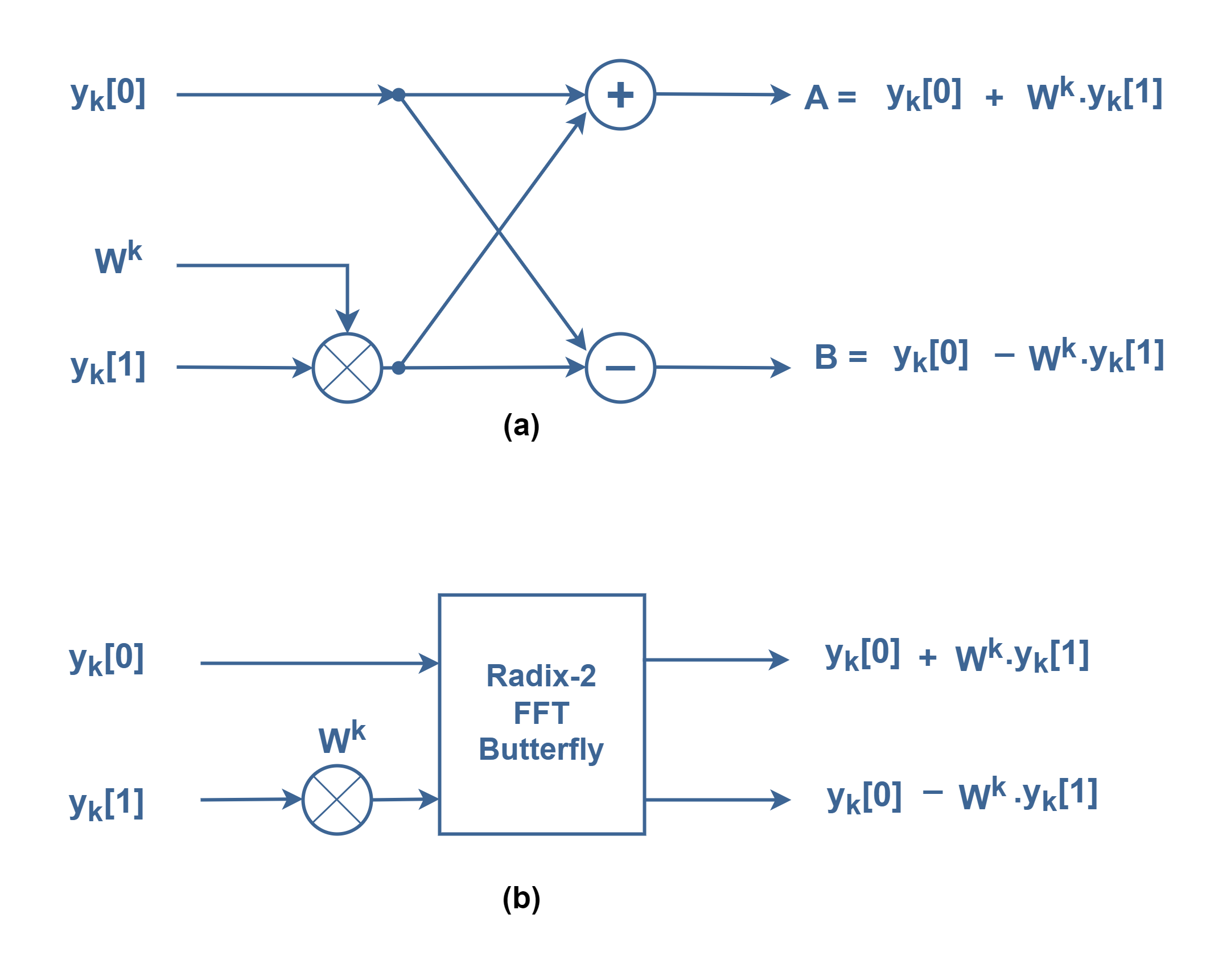

Figure 4 shows the FFT butterfly. This is the basic calculation element in the FFT, taking two complex points and converting them into two other complex points by addition and multiplication operations. This simple flow diagram is called a butterfly due to its schematic shape.
Figure 4: (a) The FFT butterfly operation schematic diagram (b) The simplified diagram

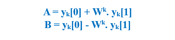

This typical FFT butterfly operation involves two complex numbers as inputs, denoted as yk[0] and yk[1]. The operation transforms these two values into two new values, (yk[0] + Wk. yk[1])  and (yk[0] – Wk. yk[1]), following specific mathematical rules. We can call the results, for example, A and B. Then, the butterfly operation computes new values for sum and difference as described in Equation 4.
Equation 4: A mathematical description of the butterfly operation
In Equation 4, W is a complex root of unity. In the Cooley-Tukey Radix-2 FFT, W is a twiddle factor that depends on the size of the FFT and the stage of computation.
The butterfly operation is then repeated recursively in different stages of the FFT algorithm, ultimately leading to the efficient computation of the DFT. Understanding the butterfly operation is crucial for grasping the inner workings of the FFT algorithm, and it provides insight into how the FFT efficiently decomposes and combines frequency components during its computation.

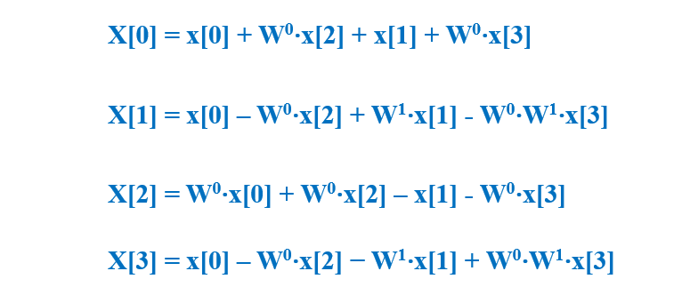

The final sequence X which contains {X[0], X[1], X[2], X[3]}, is the Fourier Transform of the original sequence x. The method of computation is explained by Equation 5. The results are equal to the DFT results.
Equation 5: The set of equations of the FFT algorithm for the example N= 4

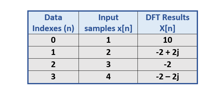

We can consider a realistic example by calculating the FFT for the input sequence x = {1, 2, 3, 4}. Based on the above-mentioned Equation and using (W0 = 1) and (W1 = -j), we can find the solution as explained in Table 1.
Table 1: An example of FFT calculation with N =4
This simple example illustrates the basic steps of the FFT algorithm for N= 4. In practice, for signals with many more elements (N >> 4), the FFT algorithm efficiently performs the transformation of these operations using a recursive strategy, reducing the overall computational complexity.

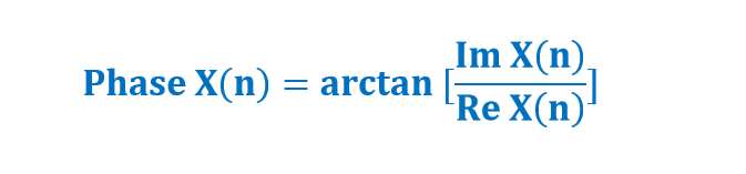

To generate a frequency domain plot from this data, the magnitude and the phase of each complex sample must be calculated using Equations 6 and 7.
Equation 6: Calculation of the magnitude of spectral components
Equation 7: Calculation of the phase of spectral components

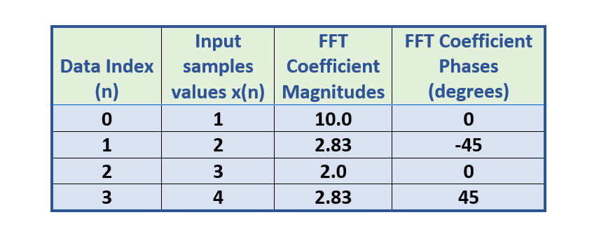

The results of the calculation are summarized in Table 2.
Table 2: The example of FFT calculation with N = 4 in terms of magnitudes and phase angles

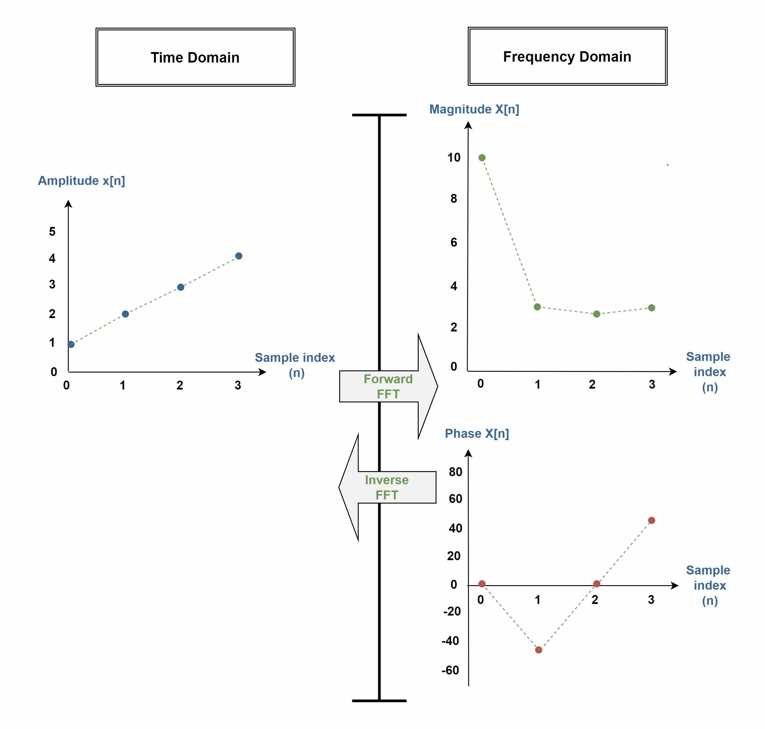

The results are then plotted in Figure 7. In the graph, the horizontal axis is the frequency in terms of sample indexes, and the vertical axis is the amplitude. A 0 frequency component indicates the amplitude of the DC component of a signal which is the sum of all the sample values in the sequence.
Figure 7: The FFT complex frequency spectrum with N = 4 in terms of the magnitude and the phase

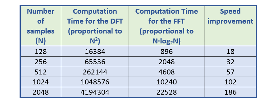

Comparison Of Computational Complexities Between DFT And FFT Methods
If N samples are given to a DFT, the time it takes to compute the amplitudes of the sinusoids is proportional to N2. But, the Radix-2 FFT algorithm requires only N·log2N complex operations. For example, for a 1024-point transform, the DFT requires 1,048,576 complex operations compared to only 10,240 for the FFT.
Table 3 shows the speed improvement of the FFT over that of the DFT in terms of different values of N.
Table 3: Comparison between the computational speeds of the DFT and the FFT for various values of N
It is clear that the speed improvement is quite significant for larger values of N and this is the main efficiency of the FFT for real discrete signals with large sizes, like N = 1024 and so on.
