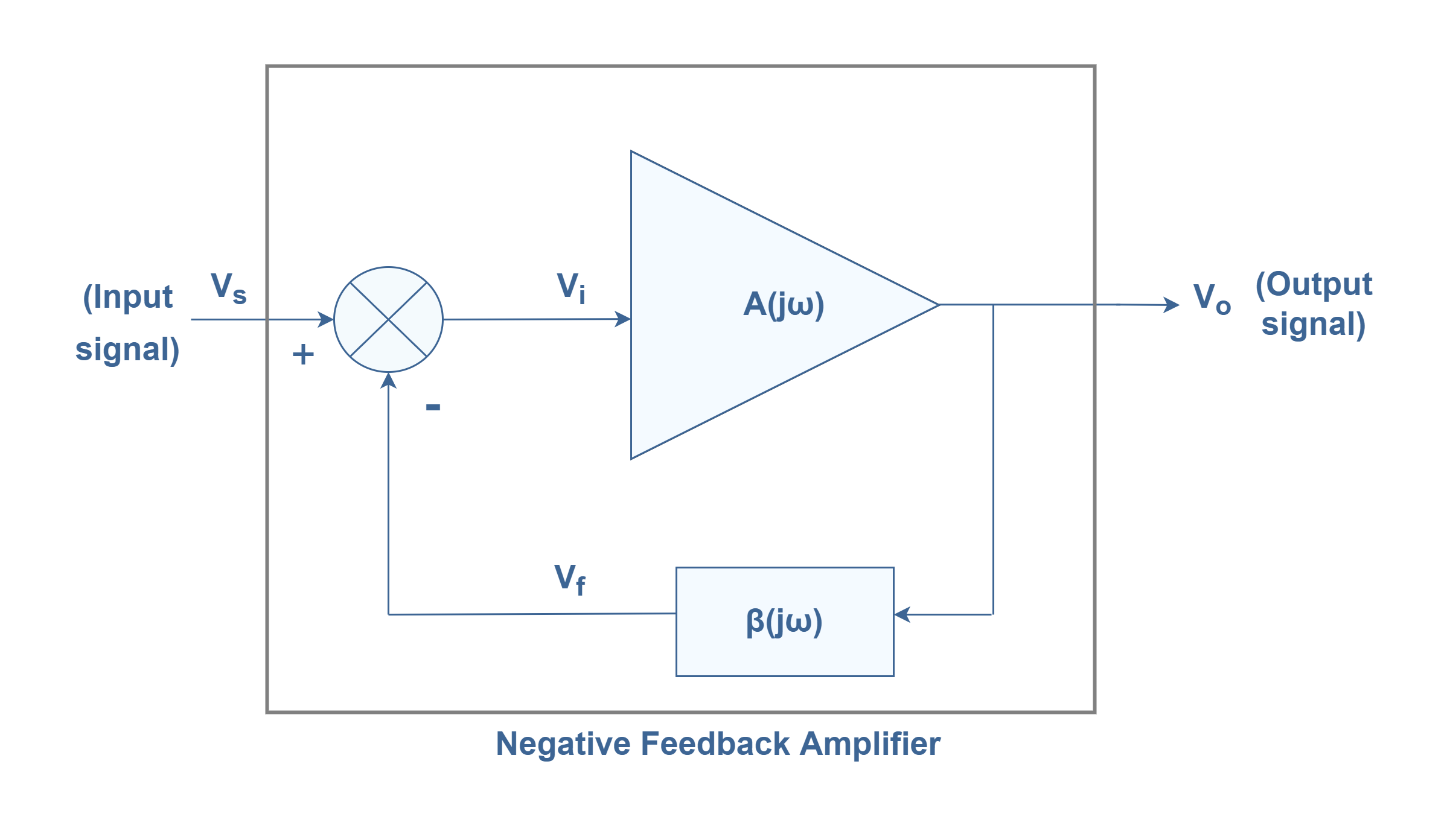

Feedback comes in two varieties: positive, and negative. Negative feedback is a connecting technique where some of the output signal (e.g. voltage) is sent back to the inverting terminal and then it is added to the input signal there. It means the signal fed back from the output to the input is 180° out of phase with the applied excitation in the input. This feedback signal can be “sent” back through a resistor, capacitor, complex circuit, or simply through a wire.
A typical feedback block diagram is shown in Figure 1. The input signal Vs is applied to a summing circuit, where it is combined with a feedback signal Vf. The difference of these signals (Vs – Vf) as Vi then becomes the input voltage to the amplifier network with the gain of ‘A’. A portion of the amplifier output Vo is connected to the feedback network ‘β’, which provides a reduced portion of the output as a feedback signal to the input summing circuit.
Figure 1: Block diagram of a feedback amplifier system
We can write the Equation 1 as the total transfer function or feedback amplifier gain in terms of frequency for this configuration:
Equation 1: Feedback amplifier transfer function
where the product of A(jω)β(jω) is called the loop gain.

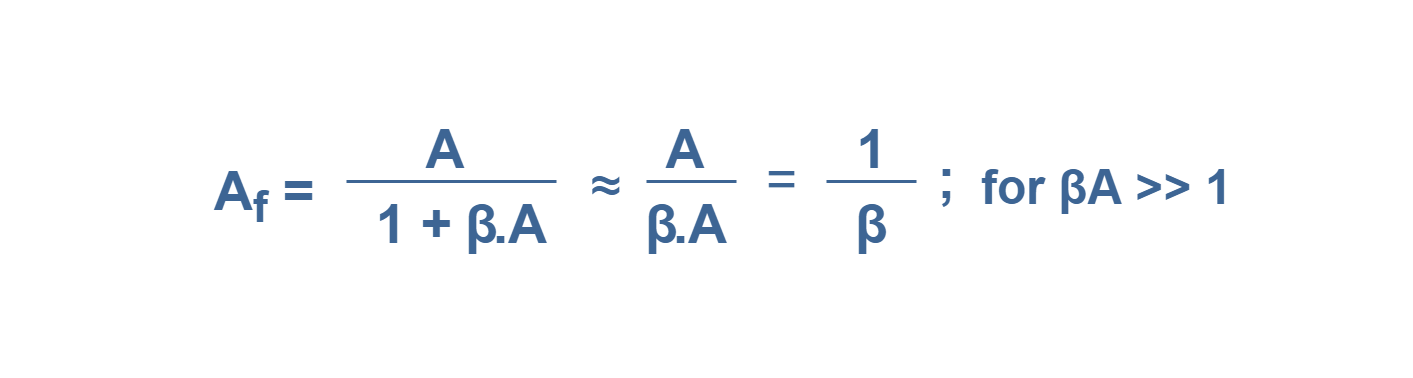

In Equation 1, the overall gain with negative feedback is shown. In the condition that the loop gain is large enough, the expression of the formula becomes simplified as shown in Equation 2:
Equation 2: Conditional expression of the total gain
As long as βA >> 1, the overall gain is approximately 1/β. the gain or transfer function of the feedback amplifier essentially becomes a function of the feedback network only. This part of the system can be a very simple resistive circuit, as a voltage divider.

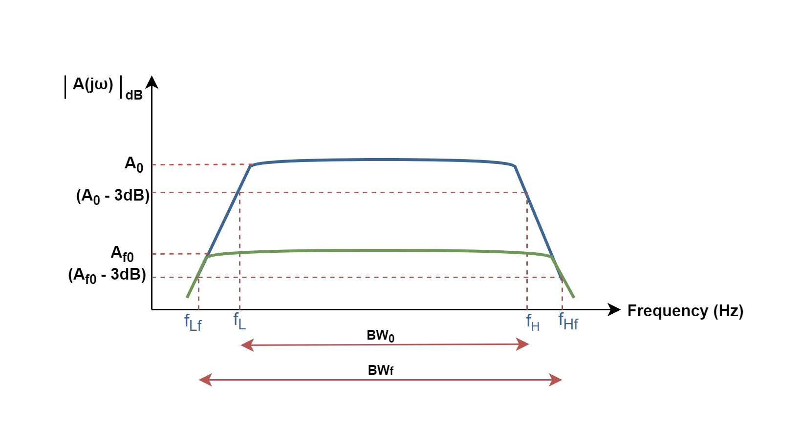

Figure 2: Increasing bandwidth in feedback amplifier
As a matter of fact, the gain-bandwidth product of the basic amplifier is the same value as the feedback amplifier. It is also interesting to note that although the use of feedback has the result of lowering the gain, it provides an increase in bandwidth particularly. It means the range of frequencies the amplifier can operate is extended in the feedback system. Figure 2 shows that the amplifier with negative feedback has more bandwidth (BWf) than the amplifier without feedback (BW0), while its gain has decreased from A0 to Af0.

Figure 3: comparison between transfer functions of a system with and without feedback
Figure 3 roughly (not in scale) shows the comparison between the transfer functions of an open-loop system (blue curve) and a closed-loop system (green curve). While the gain of the open-loop system has a big change from A0 to A1, the gain of the feedback system changes from Af0 to Af1 more smoothly.

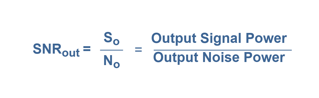

The output signal-to-noise ratio is defined in Equation 3, where So is the power of desired output signal and No is the power of the noise (unwanted) signal at the output.
Equation 3: Definition of signal-to-noise ratio

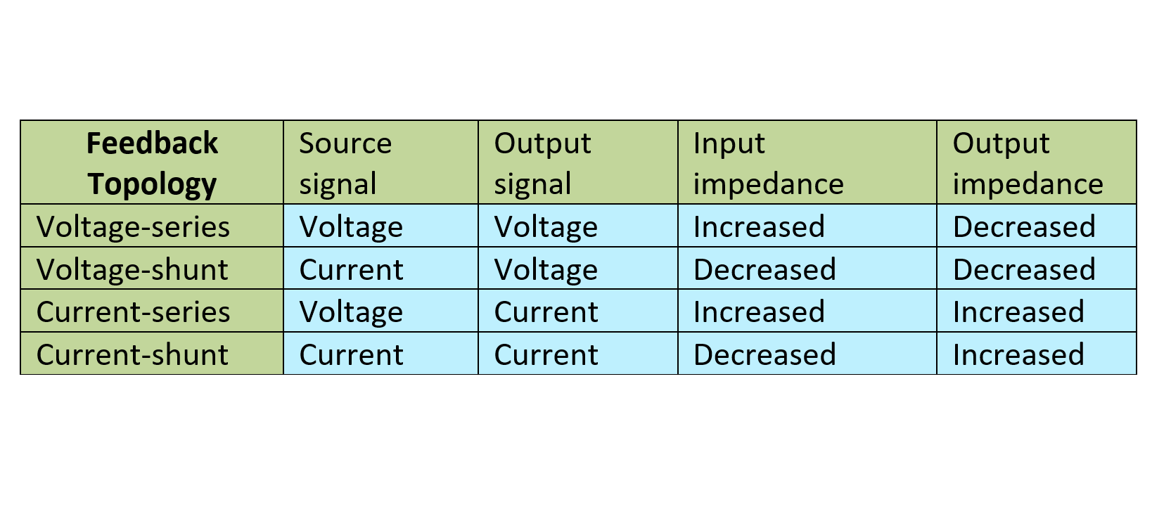

Input And Output Impedances With Feedback
A summary of input and output impedances with feedback configurations in Figure 4 is provided in Table 1. The source and output signals in the table are referred to as the feedback stage (circuit) while input and output impedances are referred to as the overall network.
Table 1: Properties of feedback amplifier configurations
It is clear that series feedback connections tend to increase the input resistance, whereas shunt feedback connections tend to decrease the input resistance. Voltage feedback tends to decrease the output impedance, whereas current feedback tends to increase the output impedance. The factor by which the impedance changes is (1 + βA).

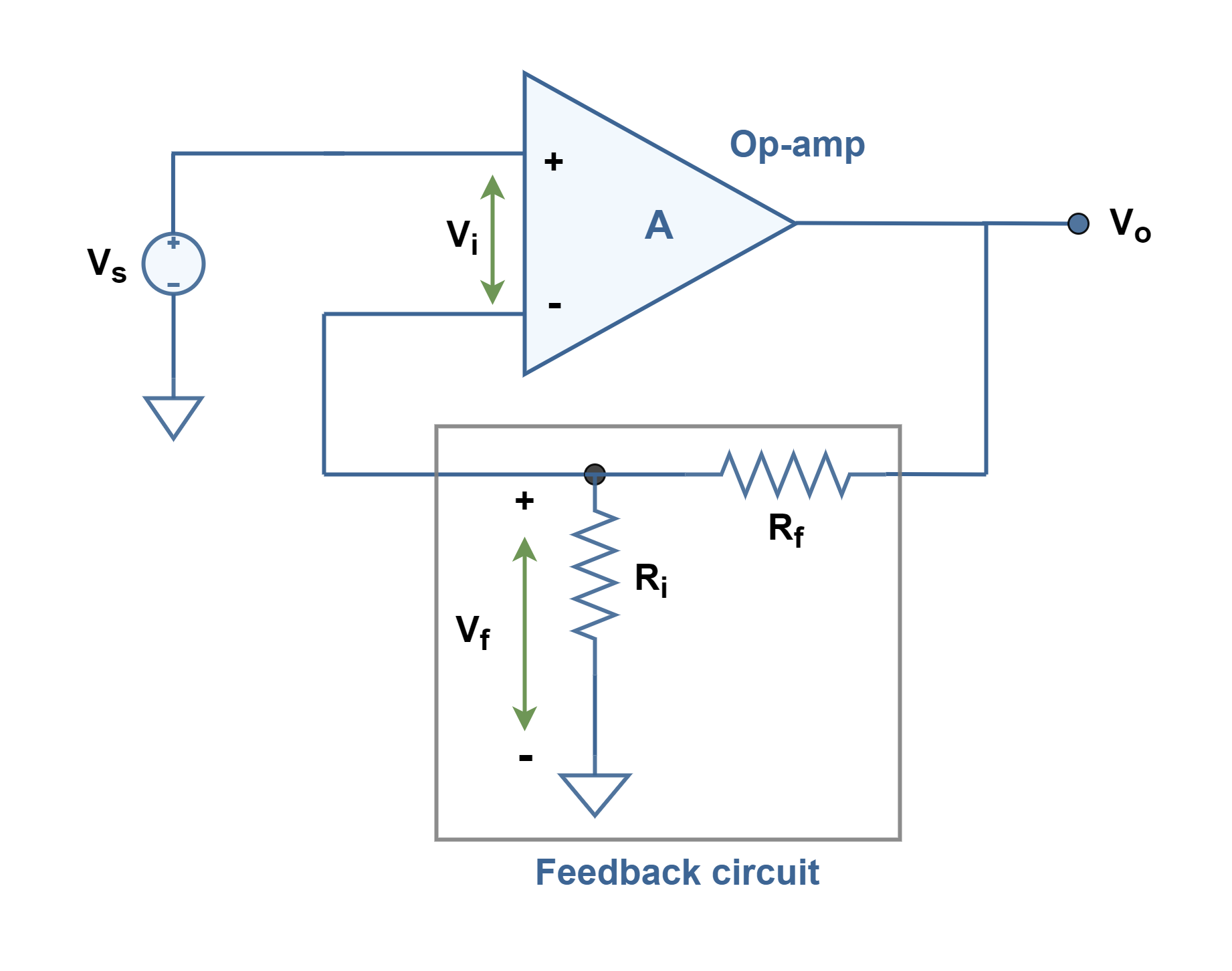

The basic circuit connection using an op-amp is shown in Figure 5.
Figure 5: A basic feedback connection using an op-amp
To achieve loop-gain of larger than 1, we should set β less than 1. The type of configuration of this circuit is a voltage-series feedback connection. In the set of Equations 4, the relationship between parameters are expressed. Vo is the op amp’s output voltage as a function of its input voltages V+(noninverting) and V(inverting) and of its open-loop voltage gainA’ (Equations 4-a). The high gain of the op-amp ‘A’ without feedback, is reduced by the feedback factor of β which is calculated for a simple resistive voltage divider (Equations 4-b). Finally, Equation 4-c shows the overall voltage gain with feedback based on values of 2 resistances.
Equation 4: Sets of relations about the feedback op-amp circuit
Let us consider a numerical analysis. If we have A = 100,000 as the open-loop gain, and  Rf = 2 kΩ and also Ri = 200 Ω, then we can find the parameters as:
β = feedback factor= 200 / (2000 + 200) = 0.09
βA = loop-gain = (0.09)(100,000) = 9000
Af = close-loop gain = 100,000 / (1 + 9000) = 11.10
Note that since βA >> 1, we can also calculate with suitable approximation:
Af  ≈  1/ β = 11.11
It is obvious that two simple resistors control the gain of this circuit. The op-amp circuits are sometimes easier to analyze and calculate than transistor amplification circuits.
