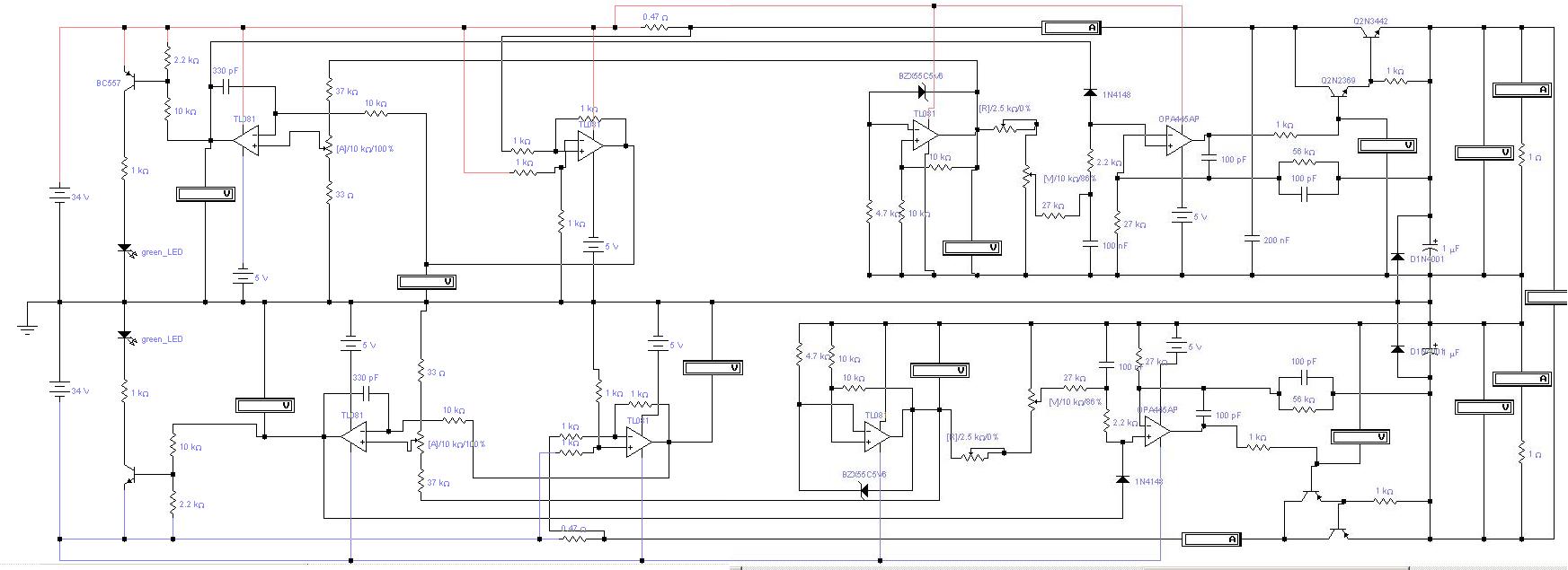

narog Posted September 4, 2005 Report Share Posted September 4, 2005 Hello.I am electronic engineering student and for 3 weeks I have been studding this power supply. Now I understand 98% of the PSU, and I decided to design a symmetric PSU. Here is my schematic. This is not a finished job, but maybe can help you. If you have Electronics Workbench you can simulated and maybe understand how it works.Right now this schematic has a big problem in the current limiter. The problem is very simple the current limiter only works if the load is connected to ground. If you have a load connected to +32 -32 V the PSU don’t work very well. Maybe some one can help and figure the solution out. Sorry I am Portuguese and my English is not the best.PSU.zip Quote Link to comment Share on other sites More sharing options...
audioguru Posted September 5, 2005 Report Share Posted September 5, 2005 Hi Narog,Welcome to our forum. ;DI don't have Electronic Workbench so I didn't see your zipped file.I like the way you added an opamp then sensed the current in the active supply, instead of sensing the ground current in our project. ;DBut the opamps sensing both supply's currents have their inputs reversed. Or the opamps they are driving have their inputs reversed. :(I would use red LEDs instead of green to warn that current regulation is reducing the output voltage.These and the opamps they drive are operating with a 39V supply, but their absolute max rating is only 36V. >:(Where did you find little 2N2369 VHF transistors? I have some that are about 40 years old! They are rated for only 15V Vce, and will quickly melt if your circuits supply 5A at a low voltage. :'( ;D Quote Link to comment Share on other sites More sharing options...
audioguru Posted September 5, 2005 Report Share Posted September 5, 2005 Hi Again,I think your output transistors will also quickly melt if your circuits supply 5A at a low voltage. :'( Quote Link to comment Share on other sites More sharing options...
narog Posted September 5, 2005 Report Share Posted September 5, 2005 Hi, the transistor/Ampops in the schematic are not the final ones. These components are there only for simulation. The Electronics Workbench has a big library but is a little old. The power transistor has to be symmetric so I have been search the web and I found:NPN 2n5631 PNP 2n6031 16A 140V 200WNPN 2n3772 PNP 2n6609 16A 140 V 150WNPN 2n3055 PNP MJ2955 15A 90V 114WFor current sense and voltage reference generator ampops you can use tl081 if you build a regulated power supply of 15V 0V -15V, “LM7815 LM7915” this is because the opa445AP cost 8.40euros “Portugal Price”.For the 2n2369 sorry, my mistake….. But the opamps sensing both supply's currents have their inputs reversed. Or the opamps they are driving have their inputs reversed. :(The positive current sense is well connected, but in the schematic you cant see that. The wires are very close, sorry. For the negative one I need a negative output. If you invert the inputs the ampop will not give you – X.XX V because -31.74V – (-34V) = 2.26V and not -2.26V. Thanks audioguru. Quote Link to comment Share on other sites More sharing options...
audioguru Posted September 5, 2005 Report Share Posted September 5, 2005 Hi Narog,Your positive current sensor opamp has positive feedback and therefore won't work. :(Your negative current sensor opamp circuit is correct. ;DThe 1k resistors in the current sensor circuits will get mighty hot. Use 10k.The 0.47 ohm current sensor resistors will also get mighty hot and waste valuable voltage. Use 0.27 ohms or less, then re-do the current setting voltage divider.The output transistor will dissipate 170W if its circuit has a low (shorted?) output voltage at 5A. With a huge heatsink a power transistor might be able to dissipate only 60W. Therefore at least 3 paralleled output transistors are needed like our proposed circuit.When the output transistors are paralleled, their individual current is lower, therefore their gain is higher and the driver transistor won't need to supply them with as much current and will be cooler. ;D Quote Link to comment Share on other sites More sharing options...
