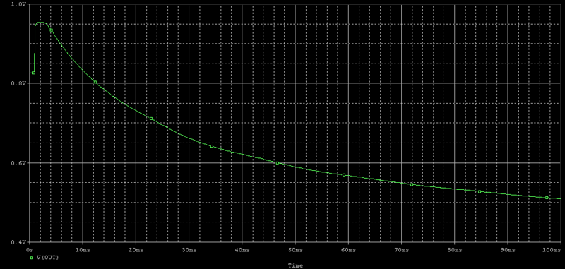

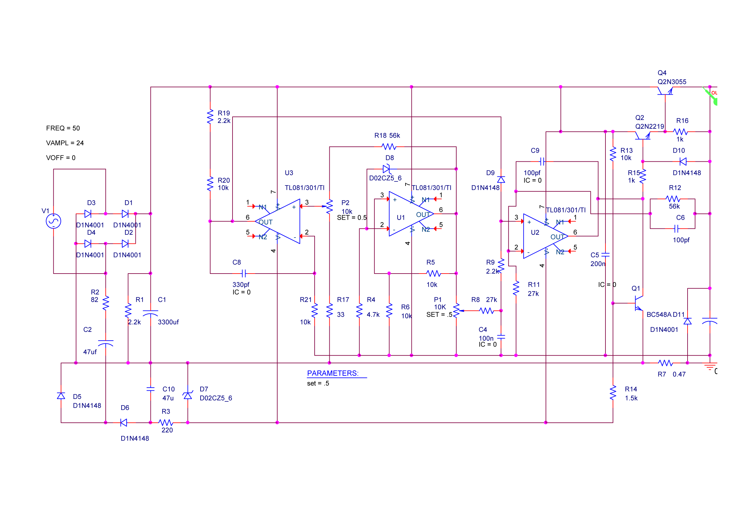

Guest 4017555 Posted June 4, 2011 Report Posted June 4, 2011 Hello and Sorry for Bad English ..i draw this circuit with Orcad 16.3 & multisim 11 But Output is 0v !! why ??Please Help Me ...I Need It ...Thanks Quote
audioguru Posted June 4, 2011 Report Posted June 4, 2011 i draw this circuit with Orcad 16.3 & multisim 11 But Output is 0v !! why ??Many things will cause the output to always be 0V.Post a PNG file of your schematic so I can see if something is wrong.Maybe your SIM software does not know the details of the special opamps that are used in the fixed version. Quote
Guest 4017555 Posted June 4, 2011 Report Posted June 4, 2011 Many things will cause the output to always be 0V.Post a PNG file of your schematic so I can see if something is wrong.Maybe your SIM software does not know the details of the special opamps that are used in the fixed version.Thanks for answer . I cant use Rv1 Pot because Orcad TL081 Not supported !See this images : Quote
audioguru Posted June 4, 2011 Report Posted June 4, 2011 I cant use Rv1 Pot because Orcad TL081 Not supported !You have sketched part of tthe original schematic but transistor Q3 is missing. It drives an LED that warns when the current regulator is reducing the output voltage. The current regulator does not do anything when there is no load so it is not reducing the output voltage.The original project has many errors and is not reliable because many parts are overloaded.We have fixed it a few times for about 6 years.You should use the latest version of the schematic that has been posted in this thread many times (see page #55 of this thread on Jan 27/2011).You should also use modern SIM software that supports modern opamps. Quote

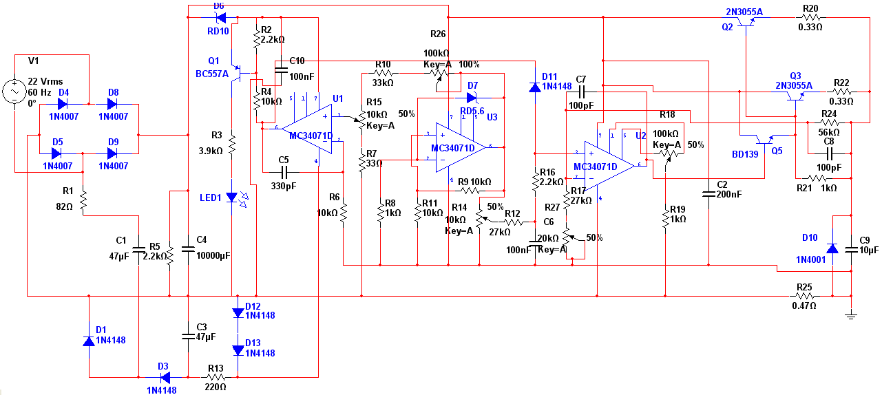

audioguru Posted June 6, 2011 Report Posted June 6, 2011 Thanks PNG AttachedYour Multisim schematic is a nightmare of crossed wires going all over the place. You changed all the parts designation numbers so it is too time-consuming to see if anything is wrong.If you SIM it in Multisim then it probably will not work.But if you build it from the corrected schematic then it will work perfectly. Quote
maciek1234 Posted June 7, 2011 Report Posted June 7, 2011 Hello.I also tried to simulate circuit in multisim 11 and couldn't make it work.Could someone have a look at the circuit if its ok?All the components are numbered as in oryginal circuit (latest version)Has any one managed to simulete circuit using any simulation software and got it worked correctly??If yes could you tell what software you used and could you upload simulation file please.Many thanks! Quote
