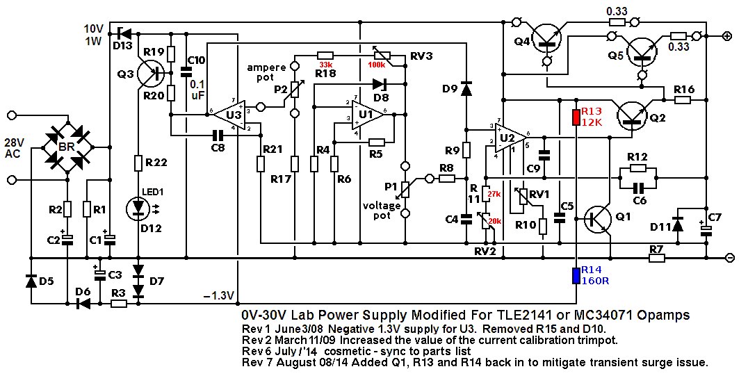

Sorry, I made a mistake converting the original schematic to the fixed and improved one.
You do not want the negative supply pin 4 of U2 to be negative -1.3V because then U2 will have its total supply voltage very close to its maximum rating of 44V (+42.6V plus -1.3V= 43.9V).
U2 does not need a negative supply so connect its pin 4 and R10 to the 0V from the unregulated power source.
Most little NPN silicon transistors have avalanche breakdown (like a zener diode) of their base-emitter junction when it is reverse biased more than about 6V so maybe you have the emitter and collector pins of Q1 reversed?
Here is my corrected schematic:
Moved pin 4 of U2 and R10 back to the original locations and we're good.  You were right about the transistor being in backwards.  I think the datasheet I looked up must have had the pins backwards from the transistor I was using because it was in right according to the datasheet but as soon as I swapped the collector and emitter pins it started working beautifully.
With your help, we have just solved the transient issue.  I'm now getting 30V with no spikes.  I'm going to redesign my boards to reflect this change and redo redwire's version for him as well.  His outputs are the smoothest thing I've seen on my scope so there must be some real value to the voltage regulator he added in to replace U1.  I think a rev. 7 is in order.  Would you like to do it or should I?

I didn't build this project so please can you show a 'scope photo of the output noise from U1 and a comparison to the output noise of a voltage regulator? I think the old zener diode is a noise source.
Can you also show a 'scope photo of a comparision in time of when the power is turned off and when the collector of Q1 drags down the output voltage? I think there will be a delay while C3 discharges.
Please update the schematic to Rev.7 showing the new voltage regulator as the reference voltage. My copy of Redwire's schematic is 2008 with at least one error so I do not know what he has done lately. Please post his updated schematic too.

We'll have to see if redwire can add these mods to one of his boards and post screenshots of his scope.  I only have an old Conar 255 from way back in the day and therefore has no hold function or screenshot export.  I'd have to use my wife's phone to do a movie and try and grab frames to post which wouldn't be very easy or fun to try.  He has a new Rigol scope that can do this better than I ever could.
I'll hack this mod into my boards and do a full load test at various voltages and currents watching the scope for issues but I think it should work just like it did on redwire's board.  I'll redo redwire's schematic later but I have redone rev. 6 to a rev. 7 with Q1 and R13 and R14 added back in.  I'll do a proper schematic and board of this version at a later date as well with proper screenshots.
Quick edit:  Some other engineers over at eevblog forums seem to think that D10 and R15 may be important in the grand scheme of things.
Dont forget D10 and that R15 (or some scheme) for your Q2 Veb(max)protection.
I'm not sure how to even go about testing this as a valid assumption and I'm sure I'd destroy something in the process if I started mucking around with it.

Hi Liquibyte,
Your Rev7 looks good. You have R13 as 10k but I calculated with 12k but it doesn't make much difference. Leave it as 10k.
When Q1 shorts the output of U2 and the base of Q2 to ground then R15 and D10 will prevent the charge on C7 (and on an external load capacitor) from causing excessive reverse voltage on the base-emitter junction of Q2.
But Q1 causes a nightmare:
1) Q1 shorts the output of opamp U2 to ground.
2) When the output of U2 is externally forced to ground then its feedback forces its output to go high with all the current the opamp can provide.
A nice fight.
R15 reduces the current in the fight to a safe amount but causes a voltage drop so the output of the project might not go as high as 30V when it is loaded with 3A.
It might be better if Q1 shorted the input pin 3 of U2 to ground then there will be no fight and R15 is not needed.
Test it with Q1 shorting the input of U2 to ground to see if there is still no spikes.
I went ahead and changed it.  I used a 12K 160R but forgot to modify that when I redid the picture.
A nice fight.
I'll change it tomorrow and do a test and let you know what I find out.

I've tested with the collector of Q1 at pin 3 and pin 6 of U2.  Given my meters error rate (and that of my eyes), the results are roughly the same.  There is definitely a voltage rise happening on power on.  Once I get above 1V the auto resolution of the meter probably hides the rise I get on power off but starting at 800mV and under I can see a definitive rise to around 1.25V - 1.5V as the caps drain out over many seconds.  I wouldn't want to keep something that required very low power levels hooked up on power off because all control seems to be lost.
To test consistently, I waited to power on once my meter settled to under 200mV as the caps drained and then turned on.  I did this several times to make sure it was consistent and to compensate for my brain not registering the number the first go around.
[pre]   Pin 3 Pin 6
30V 36.75 36.6
25V 33.06 32
20V 29 28
15V 23.56 23
10V 16.23 16.69
5V 7.95 8.56
3.3V   5.49 5.6
2V     3.6   3.9
1.5V   3.2   3.4
1.2V   3 2.8
1V     2.7   2.6
.8V 2.2   2.2
.5V 1.6   1.5
.2V .9   .3
.1V .36   .3
0V Too small and quick to see (39.2mV == 0)[/pre]

Hi Liquibyte,
On your measurements it looks like Q1 turns on a little too late to completely squash the voltage spike but it reduces it a little.
Are we barking up the wrong tree?? (I haven't said that for about 50 years)
Without Q1 the 'scope photo from Redwire shows 24MHz ringing when the power is turned on and when it is turned off. But in post #? (this site does not have post numbers) he shows no ringing when he replaced U1 with a voltage regulator. I don't think he uses Q1.

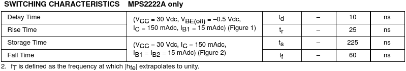

Here's the fun part.  The board he sent me and the one I'm doing this testing on is the one with the linear regulator on it in place of U1.  I've added Q1 into this board but perhaps I'm not using a fast enough transistor.  The one I'm using is from Radio Shack which is marked on the package as a 2N2222A but is more than likely a MPS2222A made by either Motorola or ON Semi.  I found the datasheet here, sorry they zipped this one for some reason.  The package came with 3 types, 2N4401, 2N3904 which is actually a MPS3904, and the above 2222.  I have a few others laying around that I got in a grab bag from Jameco to play around with but would have to look up datasheets to see if I can find something faster.
From oldest reference of the added regulator to the newest that I could find quickly.
http://www.electronics-lab.com/forum/index.php?topic=19066.msg1016994#msg1016994
http://www.electronics-lab.com/forum/index.php?topic=19066.msg1017015#msg1017015
http://www.electronics-lab.com/forum/index.php?topic=19066.msg1017302#msg1017302
MPS2222A_datasheet_2.pdf

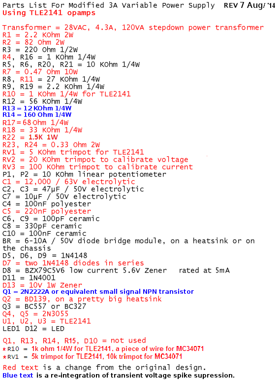

Hi guys, I haven't visited for a few weeks but see that the discussion has taken a new turn.
Liquibyte, would you mind to correct the png Parts list  (top right corner) to show Rev7 and delete the "cosmetic" line, just to keep things less confusing.
[easy way...right click the .png ; edit; add text to a blank spot; use Select tool to drag/place "7" over the "6" and "Aug" over "July"; select a rectangle over a blank spot on page - right click copy - drag over the 2nd line to blank it].
Edit your posting on the Sticky blog with this corrected one.
Thank you, forgot to edit that part.  As soon as I get things worked out and tested to make sure this isn't going to cause issues I'm going to redo my Eagle files too.  After having to remove my board to add in Q1, I've found that my design isn't as user friendly as I thought it would be.  In my defense, it was the first board I ever designed and had made.

@liquibyte
Could you edit your preamble statement in the "Sticky" page.
I could have PM'd you but I want to note it here that 90% credit goes to AudioGuru for his huge contribution to this forum's answers.
amend ".....the troubleshooting guide was written by peterk" to read "collated by peterk". Thankyou.

I put "collated and assembled from the two very large threads", twas no small feat to go through those threads and pick out those issues and put them all in one place.
I also gave credit for the "redesign that works" to audioguru because it does work rather well even if it has a few quirks and also to redwire for sending me the board I was testing for him for the issue of the spikes and that gave me the leap to Q1 being needed.  Some of the credit for that goes to David Hess over at eevblog forums for mentioning the Tektronics PS-503A and a discussion he had a week earlier about this issue.  While I was trying to figure out how to shoehorn something like that into this circuit it hit me that Q1 was this circuit.  If I didn't have redwire's board, I may have procrastinated taking out one of mine because they are a pain in the ass to get out and back in again.
I think a lot of credit goes to several other builders and testers as well.  I just realized that xristost had basically some of the same thoughts I had on it.  I'm still learning so it was important that I made the leap myself to understand the circuit better.  I've not really read his page over at http://diyfan.blogspot.com/2013/03/adjustable-lab-power-supply-take-two.html until just now.  One other thing I just noticed is that in this version, he's removed RV1.  I also wonder why it's there because in my build there's no measurable effect on the circuit.  I know it's are supposed to zero the voltage but, as far as I can tell, it doesn't do anything.  I also don't like the idea of adding voltage regulators unless they do something special that discrete components can't, the op amps themselves for instance.  I'm not against it per se, I just think that nothing is learned by adding black boxes to the mix.  That makes me wonder if it would be possible to do this in an all discrete version.  I need to quit thinking now.

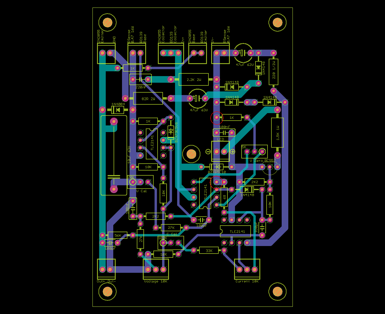

Why does Texas Instruments show the RV1 circuit we are using for nulling the input offset voltage of their TLE2141 opamp then?
Please double-check your pcb that pin 4 of U2 and R10 both connect together and to the 0V of the main filter capacitor.
If C7 is an electrolytic then its dielectric absorption will produce a positive output of the project when there is no load.
Since U2 no longer has a negative supply then it cannot cause an output negative offset voltage so adjusting the output offset should be zero to positive only.
I think the output of U2 should be monitored when RV1 is adjusted because it should never go below about +1V (two low current base-emitter voltage drops) when the voltage pot is zero. With too much negative input offset adjustment on U2 then the output of the project will be 0V (it can't go negative) but the output of U2 will saturate at close to 0V instead of being linear at about +1V.
Also check that adjusting RV1 slightly increases or slightly decreases an output voltage.
Link to comment
Share on other sites
Guest liquibyte
Yep.
C7 is a polyester film type on both mine and redwire's version.
Adjusting RV1 and monitoring the output of the PS with P1 set to zero the voltage never goes above or below 31.7mV.
Adjusting RV1 and monitoring the output of pin 6 on U2, the lower half of RV1's range does nothing.  From about half to full, the voltage goes from 73.6mV to a fluctuating 124-125mV.  I get nowhere near 1V.
Link to comment
The maximum input offset voltage of a TLE2141C is only 1.4mV so the input offset adjustment should change the output plus and minus 1.4mV or more.
The minimum output voltage of the TLE2141C (when the output is saturated as low as it can go) is about +100mV.
U2 has no negative feedback when the output of this project has no load. A small leakage current in the driver or output transistors will cause the output voltage to rise then the negative feedback will force the output of U2 to go as low as it can go and maybe oscillate up to 1V and back down over and over. We should add a low current load from the output of the project to ground. Maybe 2.7k at 1W.
Link to comment
Guest liquibyte
With a 2.965K load, I get down to around 15mV + or - using five 15k resistors in parallel so I can get a good power rating.  If I add one more to get 2.467K I get exactly the same if I recalibrate max at 30V.  I could be getting an error in reading here due to my meter.  Regardless, I'm still get voltage spike at turn on.  I've been testing at 10V to make the mental calculations easier.  Without the load, I get around a 7V spike.  With the load, I get around 6.5V.  Q1 has eliminated the spike at power off.
From David Hess:
That answers that then.  The output from U1 is actually the problem.
The inverting input should follow the non-inverting input if the operational amplifier is acting as an operational amplifier.
My WAG (wild ass guess) is that U1 operating open loop during startup before D8 conducts results in overshoot caused by windup of its internal compensation capacitor.  If U1 had a negative offset voltage, then I think it could latch off but we need not worry about that since it is not happening at the moment.  In a production design I would want to test for that.
Try adding a capacitor across D8.  I am not sure what the value should be but a .1 microfarad ceramic or film would be a good place to start.  This will force U1 to operate closed loop during startup and lower noise from the reference as a side effect.
My answer over there:
I've added a 0.1uF ceramic across D8 but I'm still getting about 16.7 volts on startup before it settles back to 10 volts.  I have a jar of many values of ceramics from 1pF to 100nF that I got off Ebay for doing just this kind of thing.
The funny thing is that the version that I have that has a vreg in place of U1 has the exact same issue and it doesn't have a D8 either.
I've even tried loading the output from 2.5K to 3K (6 & 5 15K parallel resistors) to see if it helped but it didn't.  It does help load enough so that RV1 can get the offset of U2 down to around 15mV though.  I'm not sure if the difference between 35mV and 15mV is worth the trouble considering the transient voltage problem.  If it helped in that regard, I'd definitely keep it.
I can't imagine that U1 is the issue because redwire's version is suffering the same problem and it doesn't have a U1.
Link to comment
Doesn't the linear regulator eliminate the voltage spikes caused by U1? Redwire said it did.
Does the linear regulator produce less noise than the zener diode/U1 circuit?
I proclaimed victory too early.  I found the spike on the posted board with certain settings on the scope.  I replaced U1 with a linear regulator and with the scope on the same settins I did not see a spike ,probably because it was happening at a significantly lower frequency.    I failed do anymore testing thinking the issue was resolved until I sent a populated board to Liquibyte.  He noticed the spike.  Unfortunately, I had already packed up my other board, scope, and test equipment while I'm remodeling a room at my house to work in.  Right now I don't have an adequate workspace to do any testing.
When the mains power is turned off then the 47uF filter capacitor C3 for the negative supply takes time to discharge. The speed of any little NPN transistor is much faster.
Then the slow discharge time of C3 delays activation of Q1. Then the voltage spikes are not completely squashed.
When a powered inductor is suddenly unpowered then it produces a voltage spike.
Then does a powered transformer that is suddenly unpowered when its mains current is at a peak also produce a voltage spike?
I suspect that the transformer is the source of the spike but I don't know how to test or eliminate.
As for the output transistor, I am using a darlington MJ11016 driven by a STN 851 transistor.  I have plenty of headroom so there is no problem reaching 30V and no heatsink is required for the STN851.
You should see the frankencircuit I've made of it.  I've got Q1 bodged back in and have been trying various techniques to tame the spike down but to no avail so far.  One thing I've learned is that I hate working with surface mount components.
I've tried all of the suggestions so far with no luck with one small exception.  On your board it doesn't work but on mine if I load the output a bit, I can get RV1 to pull a little more towards zero.  Not that there's that much difference between 37mV and 15mV but it's something that needs more exploration to see if true zero can be had.  I don't know if it's because I used 10 turn trimmers and they're a good quality but I can see a bit of a result there where as on yours I can't.
