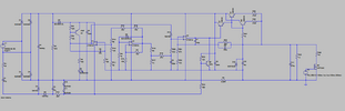

A member (homebrew) over at EEVBlog put together an LTSpice simulation of this circuit.  I've been trying to do this off and on for a little while but was never able to get it to run right.  I'm going to put this up here as well in the hopes that someone might find it useful, I know I will.  The screenshots are what was posted over there and the zip file contains the .asc for the spice simulation.
Maybe a better simulation model might help to debug the circuit. I have attached you a full simulation of your supply in LTSpice. Feel free to mess around :)
It has quite good regulation performance in voltage mode! However, in current mode it starts to oscillate ...

The very old LT1001A opamp is very slow like a lousy old 741 opamp. The TLE2141 is MUCH faster.
You have C6 as only 33pF but it should be 330pF.
Why does the circuit have C11? It is causing the current spike and maybe is causing the oscillation.

Changed C6 to 330p and re-uploaded.  I didn't do this simulation, I'm just putting it here for folks to play around with.  I asked about why some of the stuff, specifically the mosfet, was on the output but haven't heard back yet.  Like I said, I tried to simulate this but couldn't get it to work.  As far as the TLE2141 goes, if someone can get it out of UltraLibrarian from TI's website, I'll gladly add that in too.  I can't get UltraLibrarian to run on my system because it won't work under WINE (it is a VB6 app, ancient and crappy).  I've emailed them about this issue and was basically told to stuff it.  I think that it really shouldn't matter for the most part because the op amps are theoretical parts in spice and what we're looking for in this is a way to tweak the model in ways we like before trying it out in the real world.  In other words, we aren't going to be blowing these up.  If you can get the model out of its "packaging" from TI, I'll certainly use it instead.
