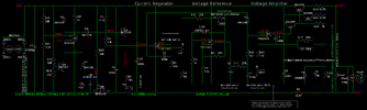

Here it is folks.  I got the soft start stabilized and had to add one component to the circuit to make it work well.  The U1 op amp (U3 original) needed a diode between its output and where U2's (U2 original) non-inverting input connected through D12 (D9 original) headed out to the BD557.  I don't know what effect this diode would have in the real world but it makes the simulation work and stops all the wonky current control issues.  I deleted the other simulations as this is going to be the final version of this with the soft start.  I'm now going to try and fix the circuit without a soft start.

I've done some further testing on the design as I have it already built and I think I've solved the transient issues altogether without a soft start although it might not be a bad idea as it stands.  I even took back out the original Q1 circuit and am getting really good results, at least in the simulation.
The current control op amp needs a diode on its output pin.  That's it.  I think what has been happening is that the voltage control op amp has been destabilizing that part of the circuit where it connects at that point.  I'm going to do some further testing with a behavioral noise voltage on the input to see how it behaves.

It is very confusing when each new schematic has different parts designation numbers.
Your new D10 has backwards polarity then the current regulation will not work.
When the new U1 detects over-current then its output goes low enough to pull down the voltage feeding the voltage amplifier opamp so that the current in the load is reduced.
You're right, I modified it and corrected the screenshots.  Needless to say, it still works better with a diode there.  Before I tried that, it would seriously mess up the output.
Edit:  I added the corrected diode polarity to redwire's board and it didn't do anything to stop the spike.  Would you be willing to build and test one of these to figure out where this issue is coming from if I sent you a board?

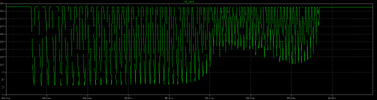

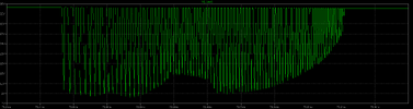

I've been playing around with the output of U3 and have been noticing an oscillation.  After trying various values for C8 from 100n to 10p and caps across the 10V zener and R20 I was able to minimize this to a small spike.  On a whim, I removed C8 altogether and the oscillation went away altogether.  I guess my question would be is C8 entirely necessary if the output of U3 doesn't oscillate without it?
Edit: Nevermind, I think I answered my own question.  The output of the supply drops when C8 isn't there.

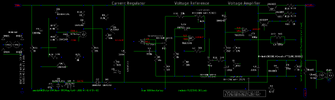

I've been doing some serious tweaking on this circuit over the last few days and I'd like opinions about anything that won't work or what could be wrong.  I've managed to pull out the negative rail completely and I think it might work like this.  I've kept the mosfet that was part of the soft start but it's now a transient protection circuit.  I've also kept the 12V relay because it helps to shut everything down rather fast.  The only issue I've encountered with it in simulation is that when the current is low, the bleed off of the main cap and the other relevant parts of the circuit takes longer than at full current.  I'm still working on how to get these two consistent but haven't been successful to date.  I've tried to pay attention to the limits of the components but may have missed something so if you notice anything odd or off, let me know.
Edit: quick correction to the schematic.
2nd edit: I found a problem with the bleeder resistor and the base/gate of the transistor/mosfet.  I'll update when I get it figured out.
3rd edit: I thought I was right but I was wrong on the shutdown stuff.  I'm still working on it but I can't get low amperage to behave at shutdown.  Having said that, I think I'm on the right track for removing the negative supply and having things work.  Almost but not quite right.

The negative supply is needed for the current regulating opamp to cause the output voltage to drop to zero when the current into a short circuited output exceeds the setting of the current-setting pot. Without the negative supply then the output of the current regulator opamp cannot cause the output voltage to go down to zero volts because it feeds the voltage regulator amplifier though a diode. Short circuit current will be unlimited.
That's what I thought too but the simulations I've been doing say otherwise.  I've modelled in a direct short using a voltage controlled switch and when it kicks in, the current limiting seems to kick in as well.  I obviously screwed up the bleeder part before and I'm still having a bit of trouble getting things to be stable at high voltage and low current but I'm making progress.  Here's a screenshot of 4 seconds worth shorting at 30V and 3A with the current limiting kicking in.  Obviously I've not build this and blown parts up to test it but according to the simulations it should work without the negative rail.  I'll try this out in the real world eventually just to satisfy my curiosity.2014-12-01-232014_1920x2100_scrot.png

Good point.
The current regulating opamp has its negative supply pin at the input of the 0.47 ohms sense resistor and the voltage regulating amplifier has its negative supply pin at the output of the current sense resistor which is 1.41V higher than the current regulator negative pin when the output is shorted and the current is set to 3A. Then the diode between them causes the output voltage to drop until the current is 3A. But when the output is shorted and the current is set lower than 3A then the current regulator will not work properly below a certain setting.
So the negative supply is needed after all.

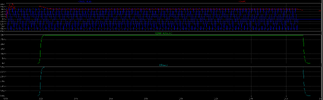

Here's the issue I'm running into currently.  I've got the circuit behaving at high current and high voltage but as I raise the load resistance the input gets unstable and the shutdown doesn't behave as I would expect and I can't figure out why.  For one thing, you'll notice in the 3A pic that shutdown occurs at around 1 3/4 seconds.  This is because I've got the input voltage set at 100 cycles.  In the 1mA pic, nothing has changed other than the load going from 10 ohms to 30k but the shutdown occurs at just over 7 seconds.  You'll also notice that the input voltage sags drastically where shutdown should happen but things don't bleed off as I would expect.  Both output conditions have a 200ms short for testing purposes.  If I could get the low current output to shut down like the higher currents do I'd probably breadboard this to see how it went.
Edit:  I wanted to add that adding in the negative supply doesn't change the behavior of the plots.  I started out with the negative supply and the above configuration and on a whim decided to see what would happen without it.  Since nothing changed whether or not it was there, I decided to try and see if I could get it to work without it.

I have to test out the various components for being within their specs but I think I may have it.  There's about a 200ms difference in shutdown times at the mosfet but taking a page from the original Q1, I'm shunting the residual power to ground from the output cap instead of from the voltage op amp.  It seems to work so only a prototype will tell I guess.  The slope on the lower current is not as tight but I think I'm getting closer.

I've tried to get this to do better but I'm stumped on how to get it to shut down quickly at lower current loads without actually using a separate voltage source for the relay.  In the grand scheme of things I guess I'm being a little anal about it but it still bothers me.
Edit: instead of taking out the current 2.2K 2W bleeder, I've made it 1K to match the output and it seems to help in getting the low current fall off time to be shorter by a couple of seconds or so.
