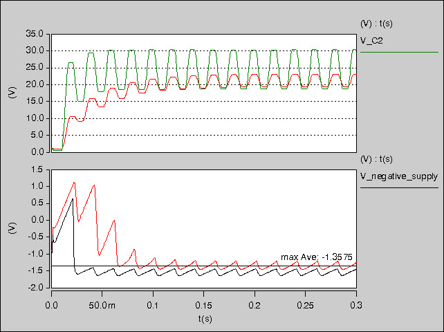

Hi
what happens if I remove R1? what if I increase the value of R2 to say 560 ohm? (in that case I can use a 1/4 watt or 1/2 watt resistor.)
I simulated the circuit, the lower waveform is -1.3V line, the upper waveform is the voltage across C2. the black waveform is for R2=82ohm and the red waveform is for R2=400ohm.
you can see that increasing R2 affects charging voltage of C2 (I think that's because time constant of RC circuit rises and in a short time, C2 cannot charge to its MAX voltage, am I correct?).
can anyone explain to me why discharging voltage level of C2 is independent of R2 ? discharging current of C2 is also goes through R2, so why is that the final value of the voltage across C2 is the same with both small and large value of R2?
R1 discharges C1 when the power is turned off. If C1 is removed then the output voltage might be too high the next time it is turned on which might destroy a circuit it is powering.
R2 limits the charging current for C3. If its value is too high then C3 might not be charged enough.
I don't believe your simulation because C3 and the diodes should filter out most of the ripple.
spur
Apr 26, 2011
8
Apr 26, 2011
8
ooo! i haven't thought of that.
I think I have to build the circuit and test the resistor values in real circuit. I'm having trouble finding OPA445, a friend of mine is going to buy them for me, but he will not come to me until two or three weeks later, so I have to wait  :'(
The -1.3V supply has a very low load current so its ripple is very low. Its voltage is regulated by the two series diodes.
The latest version will not work with the rare and very expensive OPA445 opamps that we used about 6 years ago. It uses common and inexpensive MC34071 or TLE2141 opamps.

spur
Apr 26, 2011
8
Apr 26, 2011
8
The latest version uses common and inexpensive MC34071 or TLE2141 opamps.
but my transformer is 30V 5A (although I'm not sure about 5A), can I use these opamps with this transformer?
the load current ( if you mean negative supply pin of U3 ) is very low, that is correct, but C3 is continuously discharging through R3 (220ohm) . with 10V across C3 the discharging current will be 39mA.
simulation results for current of R3
audioguru2
Apr 6, 2004
12,026
Apr 6, 2004
12,026
The -1.3V supply is regulated by the two series diodes. The voltage will never go as high as -1.5V as you show.
spur
Apr 26, 2011
8
Apr 26, 2011
8
but datasheet of 1N4148(fairchild) shows that with 30mA forward current , forward bias will be 0.8V. so the negative supply will be 1.6. I think 1.5V is reasonable.  ::)
BTW, can I use my 30V 5A transformer with MC34071 or TLE2141? in your part-list the transformer is characterized 28V 4.3A !!?
