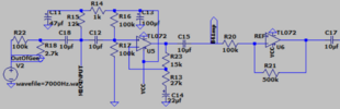

okay found it so now that that is changed to 10uF what should R23 be please? thanks!

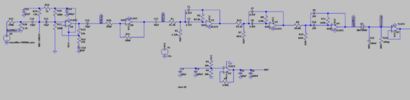

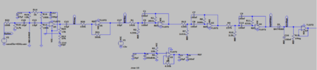

so I have finnished reading the entire thead, I made a start I soldered the bar graph leds on but nothing else yet! kinda got side tracked with another project! I'm back to this now though! thanks! as you can see the 45Hz image uses a 15k resistor for R23 and the 7000Hz uses 820k I want the resistor to be the same value which value would you choose? thanks also can't get the envelope detector working again?

look and see! if you can find fault! thanks

the filters are working in a fashion but don't produce much voltage change (less than 0.1 of a volt0 from what I understand they need to vary by 2.4volts! need some adjustments can you fix it ??

Hello,
When pin 8 is gounded the reference voltage will be about 1.25 Volts.
When pin8 is lifted with a resistor, the reference voltage will be higher.
Have a look at the formulas again.

Hello,
Why do you want such high values?
Audio is not so high.
The 2.4 volts range is already quite high.
You might even need an amplifier between the filter and rectifier.
Bertus
Hello,
In stead of making a complete series of filters twice, you could add a simple amplifier between the filter and rectifier circuit:
That would save you a lot of work.
Bertus
Hello,
Now you have R13 at 4K7 and R23 at 165K.
Change that to R13 at 27K and R23 to 1Meg and see what happens with 45 Hz and 7000 Hz.
With those values C14 will have a factor of 6 less influence on the frequency dependend gain.
Bertus
I changed the R23 resistor to 1meg and on the 7000Hz circuit the signal reaches 8.7v at the top and 6 at the bottom so this is good, now waiting for the program to run and I will screen shot it and do the same for the 45Hz one too!
running the 45Hz now... and it reaches similar voltages!!!

looks complete now with a couple of adjustments to get it in the 2.4volt range with trial and error on the R23 resistor and I'll crack on!! thanks everyone!! seems to be 0.8meg!
