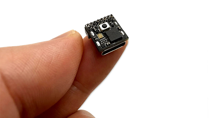

Canada-based Moddo has introduced the Pinch, claiming the title of the smallest Arduino-compatible board available in 2026. Measuring only 10.9 × 10.5 mm, the board combines a 32-bit Microchip SAMD11 microcontroller, native USB-C connectivity, and multiple I/O interfaces in a footprint that is even smaller than many individual electronic components. The compact design targets embedded projects where every millimeter matters.

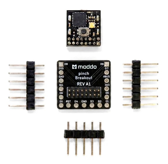

Moddo Pinch PCB and kit

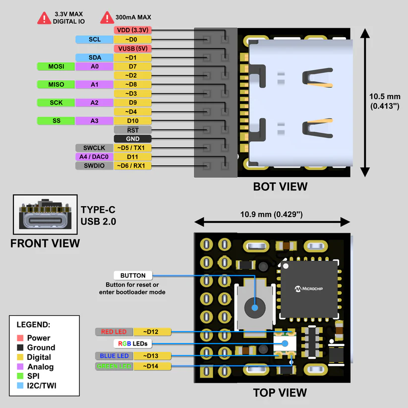

Moddo Pinch specifications:
  • Microcontroller: Microchip ATSAMD11D14A (SAMD11)
    • Arm Cortex-M0+ CPU running at up to 48 MHz
  • Memory:
    • 4 KB SRAM
    • 16 KB Flash (12 KB available for sketches, 4 KB bootloader)
  • USB: 1× USB Type-C for power, programming, CDC serial, and native HID
  • Expansion
    • 16-pin, 1.27 mm pitch header
    • 12× GPIO (D0–D11)
    • 5× analog inputs (A0–A4)
    • 11× PWM outputs
    • 1× DAC
    • 1× I2C
    • 1× SPI
    • 2× UART (multiplexed with USB and D5/D6)
  • Debug: SWD interface on D5 (SWCLK) and D6 (SWDIO)
  • Miscellaneous:
    • Onboard RGB LED
    • Reset/bootloader button
  • Power
    • 5V input through USB-C
    • 3.3V LDO with up to 300 mA output
  • Dimensions: 10.9 × 10.5 mm
  • Weight: TBD
Pinch PCB kit
Pinch PCB kit

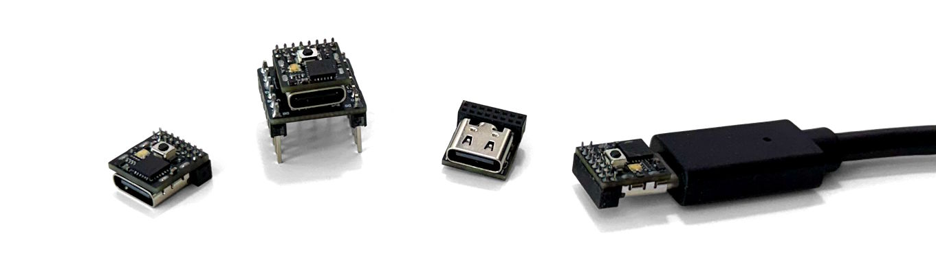

The smallest Arduino-compatible board works directly with the Arduino IDE. Users only need to add Moddo’s Boards Manager URL, install the Moddo SAMD board package, and select the Pinch board before uploading sketches. The board supports existing Arduino libraries, examples, USB CDC serial communication, and native USB HID functionality, making it suitable for projects such as custom keyboards, mice, and other USB peripherals. Developers can also access documentation, schematics, PCB files, 3D models, and additional technical resources through the company’s GitHub repository.
