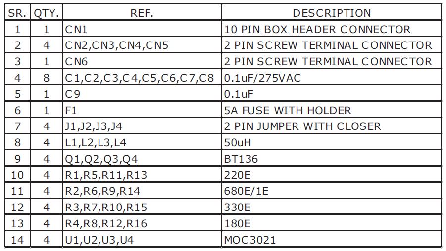

Parts List
4 CHANNEL TRAIC BOARD BOM

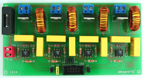

Photos
4 CHANNEL TRAIC BOARD PIC 02

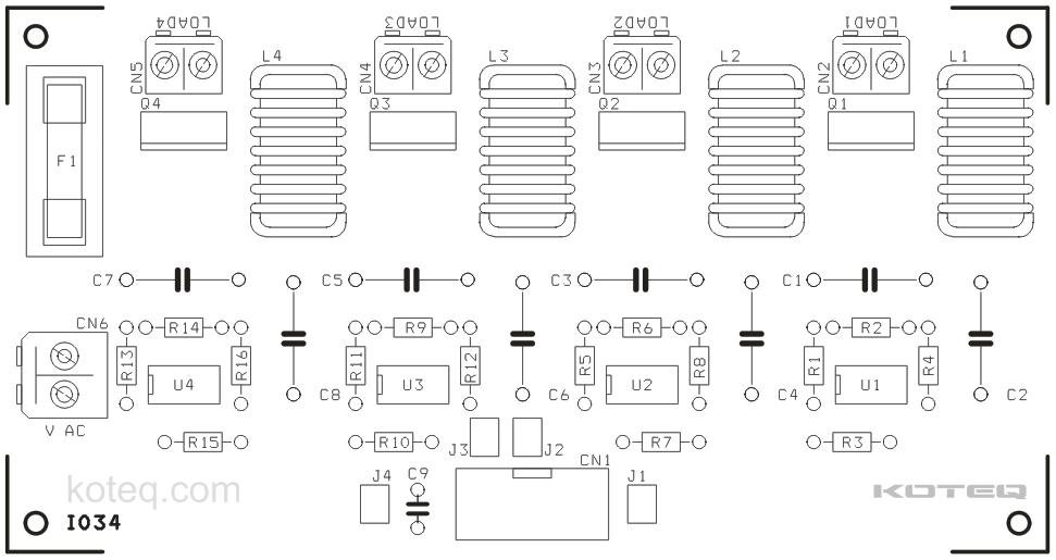

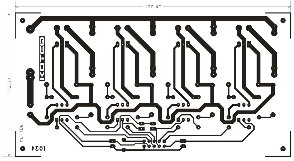

Gerber View

Are you sure the 1ohm value for R2, R6, R9 & R14 is correct for 110V operation? It seems way out of line compared to the value used in similar application circuits..
