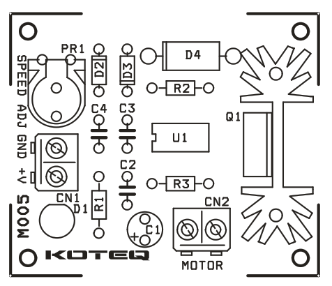

  • Screw terminal connector for easy power supply input and output-Motor connection
  • Four mounting holes of 3.2 mm each

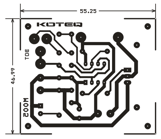

  • PCB dimensions 47 mm x 56 mm
