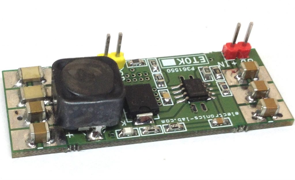

The circuit published here is a compact 60V DC-DC Step down Converter that provides 5V DC output and load current up to 3A in compact size. The project is based on LMR16030.
Power by mixos

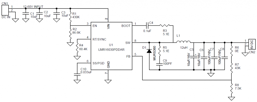

The LMR16030 is a 60 V, 3 A SIMPLE SWITCHER® step down regulator with an integrated high-side MOSFET. With a wide input range from 4.3 V to 60 V, it’s suitable for various applications from industrial to automotive for power conditioning from unregulated sources. The regulator’s quiescent current is 40 µA in Sleep-mode, which is suitable for battery powered systems. An ultra-low 1 µA current in shutdown mode can further prolong battery life. A wide adjustable switching frequency range allows either efficiency or external component size to be optimized. Internal loop compensation means that the user is free from the tedious task of loop compensation design. This also minimizes the external components of the device. A precision enable input allows simplification of regulator control and system power sequencing. The device also has built-in protection features such as cycle-by-cycle current limit, thermal sensing and shutdown due to excessive power dissipation, and output over-voltage protection.
  • Supply 12 TO 60V DC
  • Output 5V DC @ 3A

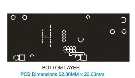

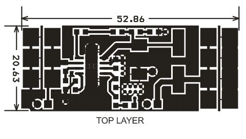

  • PCB Dimensions 52.86mm X 20.63mm
Schematic

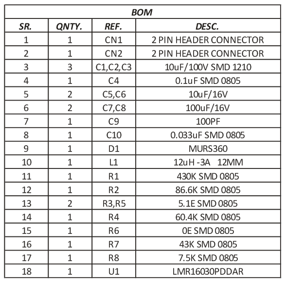

Parts List

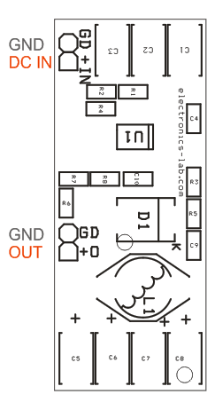

Connections

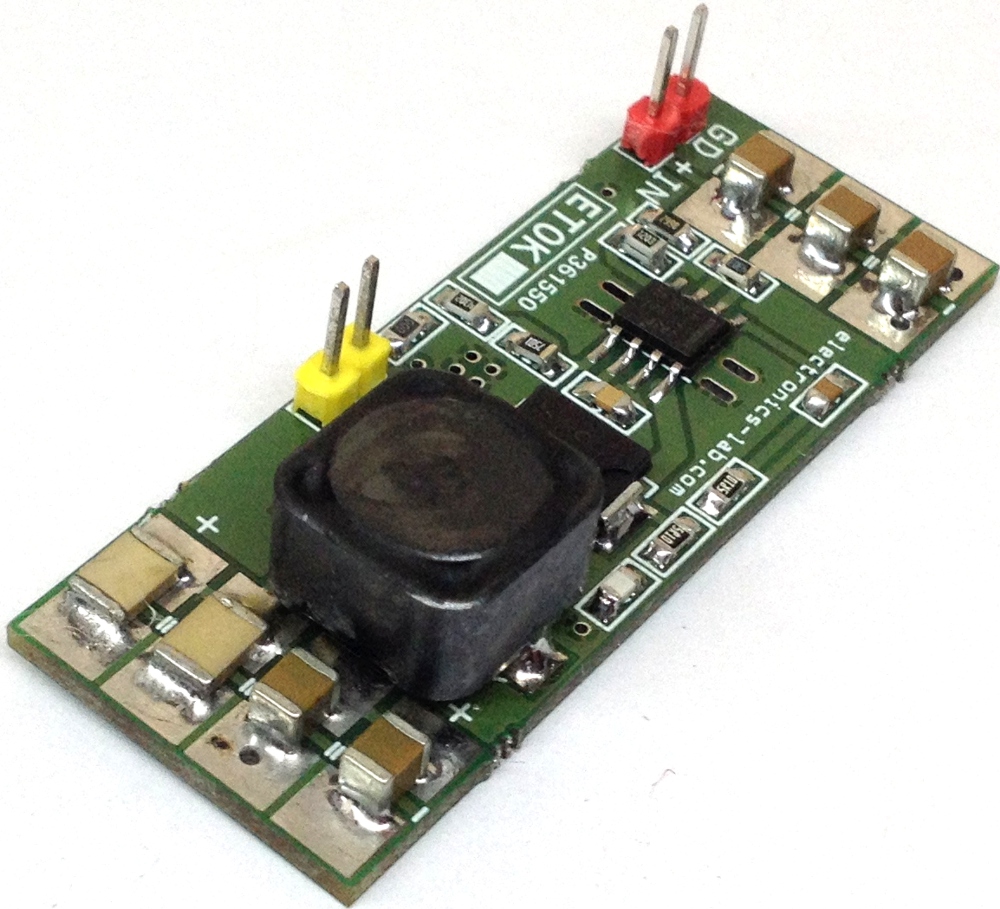

Photos
