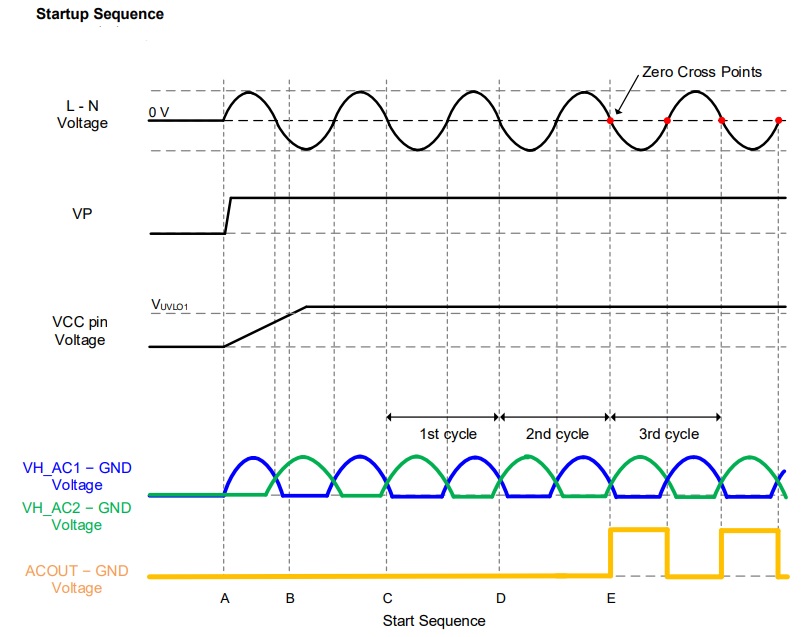

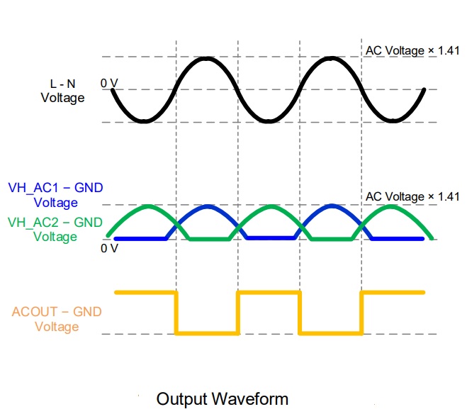

AC Voltage Zero Cross Detection

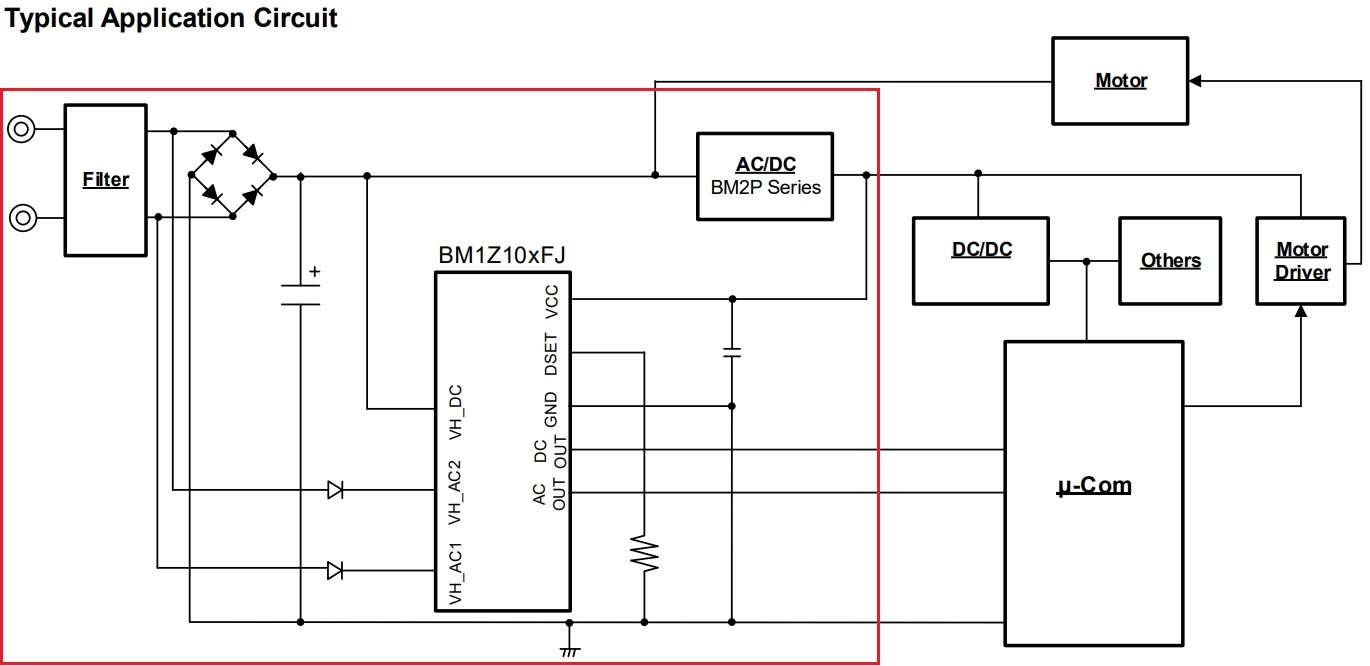

By monitoring the voltage between the VH_AC1 and VH_AC2 pins, this IC outputs the zero-cross point of AC voltage from the ACOUT pin. These pins have a built-in monitor circuit that tolerates 600 V and they realize high reliability and low power consumption. The ACOUT pin performs an N channel open-drain output and this makes it possible to support various applications. It is necessary for the VH_AC1 pin to be connected to the N side of the AC input and for the VH_AC2 pin to be connected to the L side of the AC input

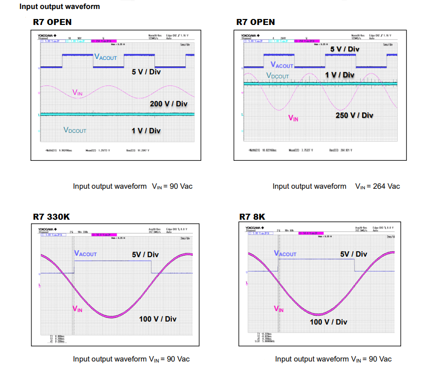

Output Delay Setting (DSET Pin Setting) – Resistor R7
- R7 OPEN DELAY 0uS
- R7 330K 200uS
- R7 68K -200uS
- R7 0 OHMS -480uS

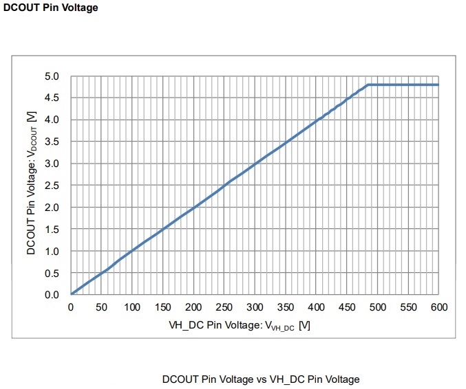

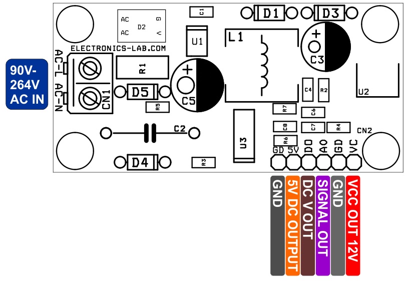

DC Out (DO) CN4 Pin 4
- 110V AC Outputs 1.1V DC
- 230V AC Outputs 3.3V DC

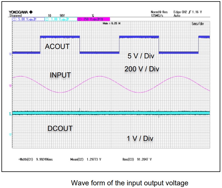

Input-Output Waveforms
- Supply Input 90V AC to 264V AC
- On Board AC to DC Offline Converter (90VAC-264V AC input, 12V DC Output @ 100mA)
- DC Output about 1/100 voltage Approx. 1.1V with 110V AC, 3.3V with 230V AC input
- Input Frequency Response 47Hz to 63Hz
- Provides Accurate 50Hz Square wave with 230V/50Hz AC Input
- Default Output Pulse Delay time = 0uS (Can be Adjust Using R7)

Application Circuit

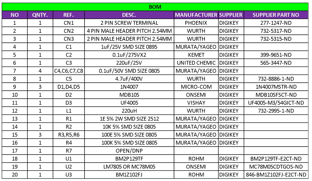

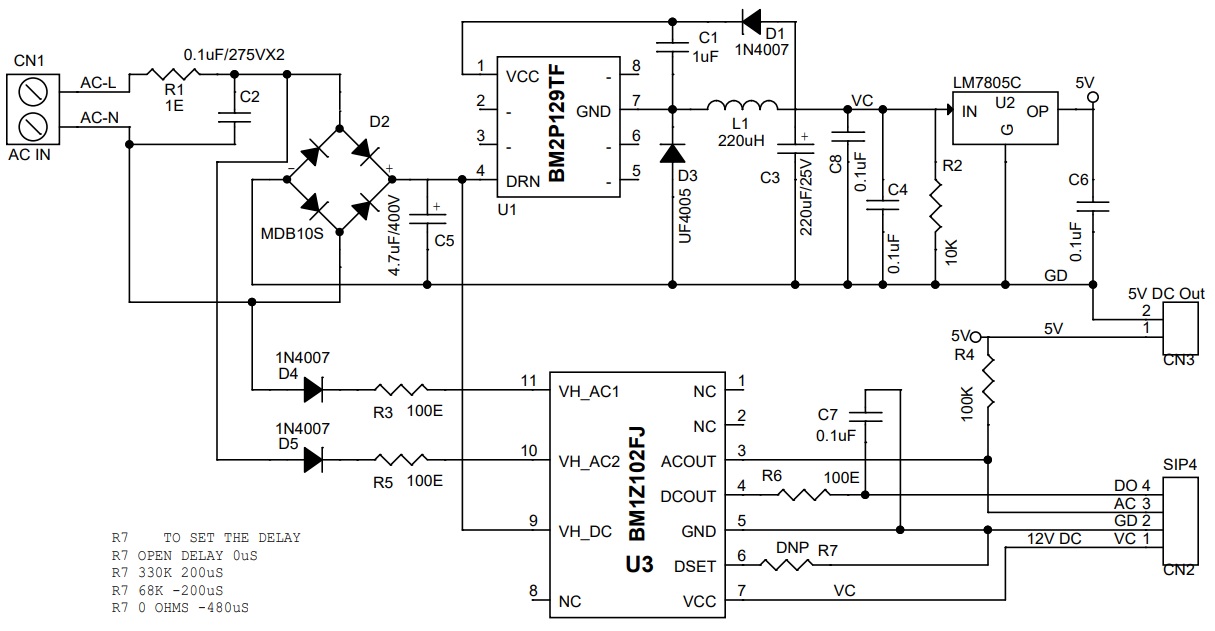

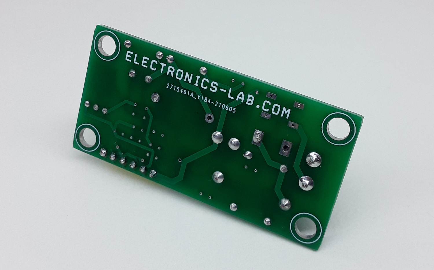

Hello,
The BOM and image are showing an L1 inductance of 68uH (Wurth 732-2995-1-ND) but the schema (and original sample circuit from Rhom) are showing an inductance of 100uH (Wurth 7447471221).
Could you please confirm the correct inductance value and ref ?
Thank you!
Thanks for noticing this issue. The correct Digikey number is 732-1696-1-ND and it’ fixed on the BOM above.
thank you!
Would you happen to have the centroid file (pick and place) ?
Thank you!
Let me check with our engineer and i will get back to you.
Hello,

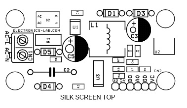

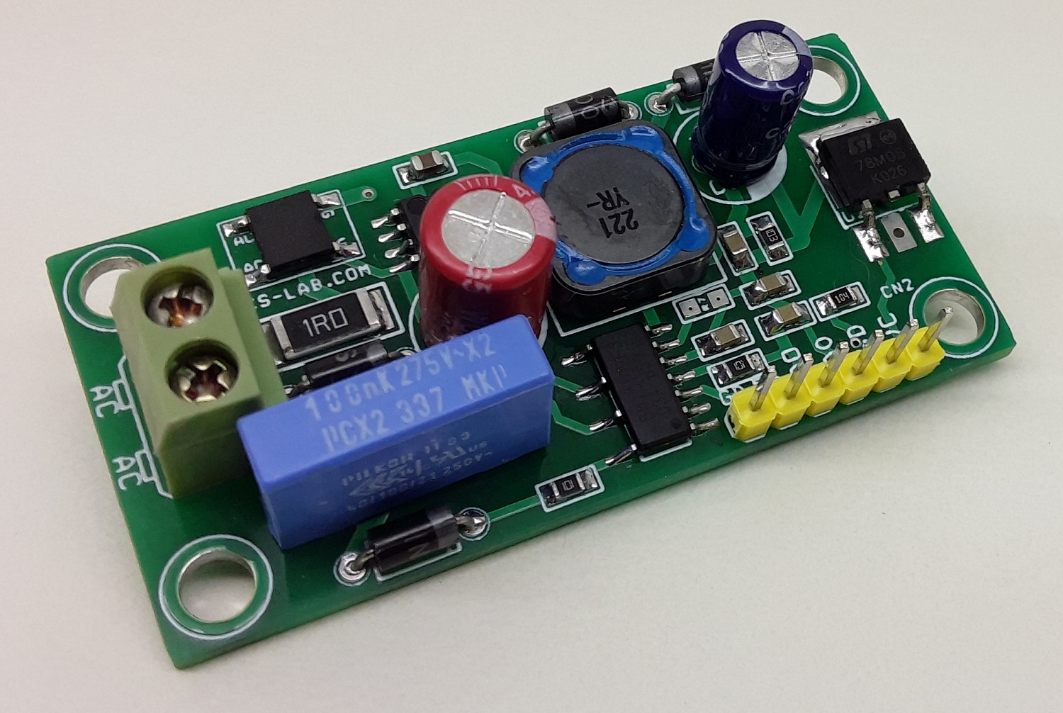

Could you please confirm the orientation of D2 (how it should be soldered) ?
Hello,
I have another question about D2: the component orientation (AC side, + and – side) is OK, but which orientation should be followed to solder on board ?
Image: ZxWN3i0.png

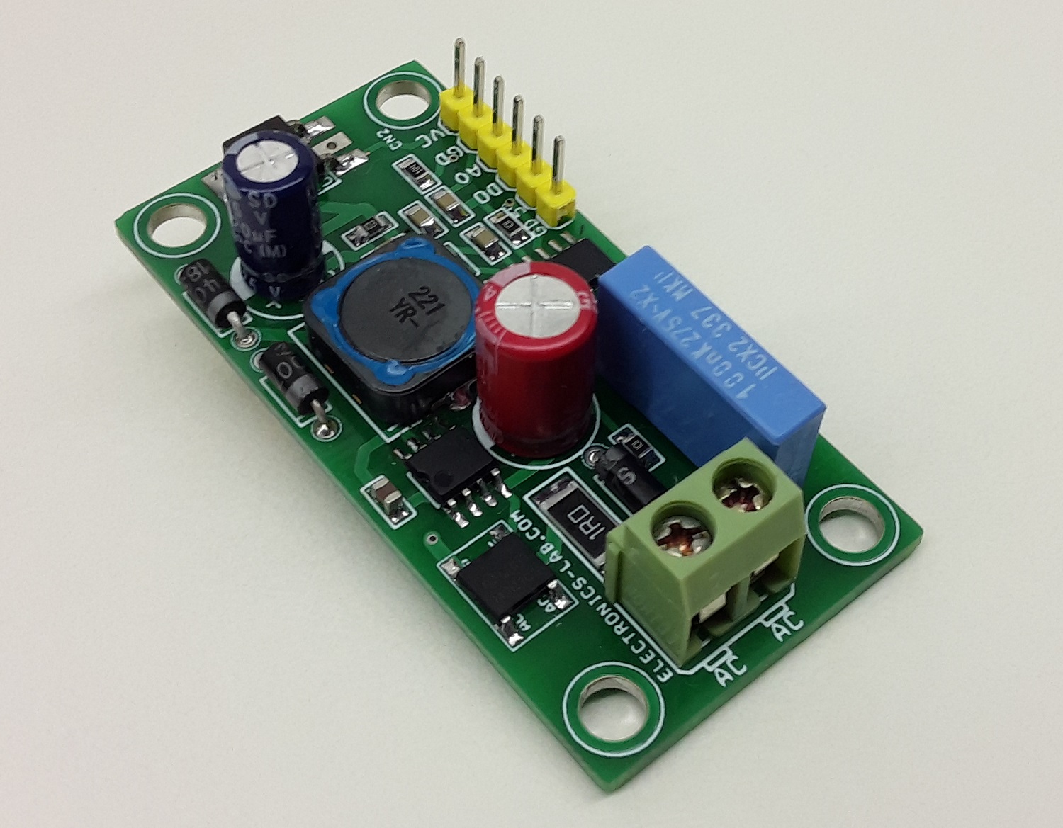

Sorry for the bad English. To make it clear, the schema would need to be corrected for D2 (MDB10S) and use – and + instead of G and V. I assume D2 is the MDB10S as we see in the pictures right ?

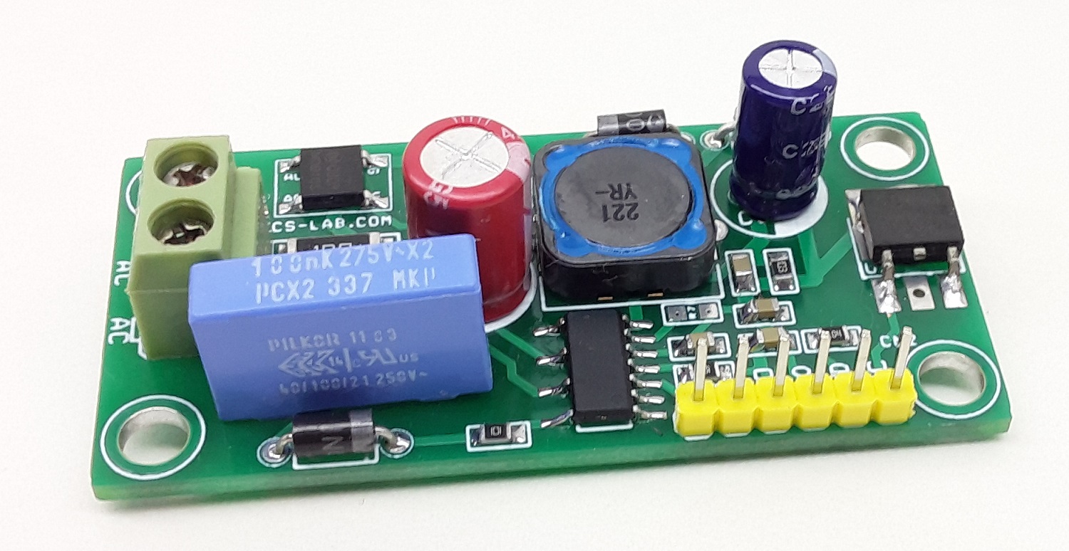

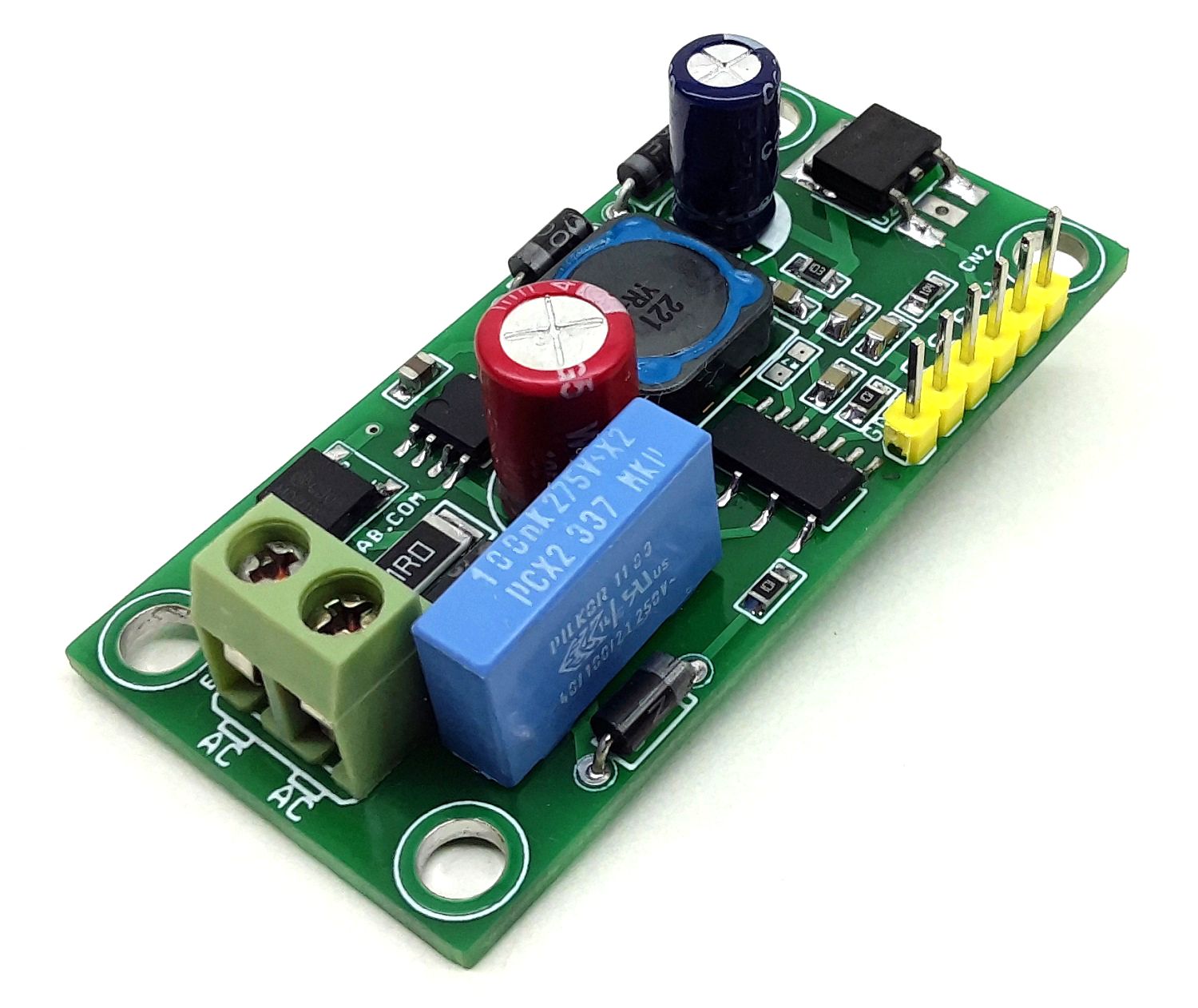

C3 (565-3447-ND) does not fit the board… C3 is not blue
Can you please confirm which C3 part must be soldered ?
Photo: https://imgur.com/a/LMZatmq
Digikey Part #565-3447-ND is this: https://www.digikey.gr/en/products/detail/chemi-con/EGXL250ELL221MJC5S/3528652 and it is a generic 220uF/25V electrolytic capacitor with 10mm diameter. It seems like your capacitor is larger. Have you purchased it with this exact part no ?
The part from the BOM is:
UNITED CHEMIC EGXL250ELL221MJC5S
https://www.mouser.lu/ProductDetail/Chemi-Con/EGXL250ELL221MJC5S?qs=RpYEFuZ7GTgRgzzNqSkrqQ%3D%3D
I agree with you for the specs, they are the same, but the UNITED CHEMIC EGXL250ELL221MJC5S has a 5mm spacing which is wider than in the blue one seen in the photo.
C3 – blue in the photo – (565-3447-ND) has a diameter of 10mm according to Digikey specs
C5 – red in the photo – (732-8886-1-ND) has a diameter of 8mm according to Digikey specs
You can clearly see with the photo that the blue capacitor is smaller than the red one…
In the BOM, the reference for C3 is a 10mm diameter 5 mm spacing which is BIGGER than than C5 (red one).
So there is a mismatch between the photo and the BOM.

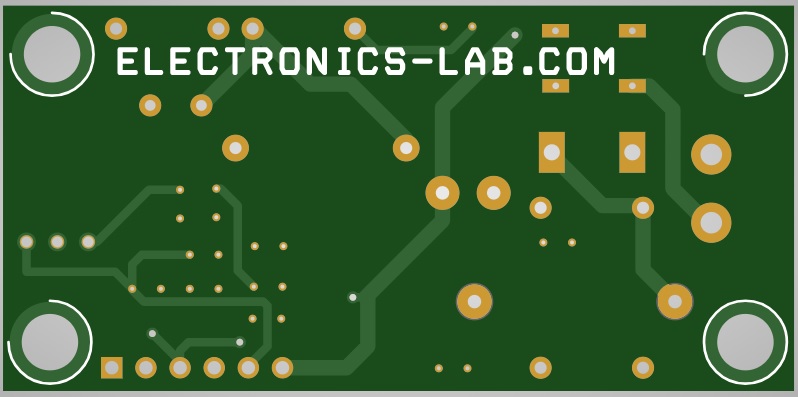

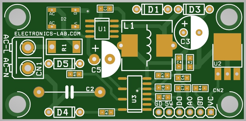

The lead spacing of the part is 5mm, but holes spacing designed as 3.86mm in Gerber file.
The problem is hole spacing too small designed in Gerber file.
So the lead spacing is bigger than hole spacing, that means the part can’t be soldered totally through the holes.
I decided to change for this one, which is the one used in the ROHM evaluation circuit for the BM1Z102FJ:
https://www.digikey.fr/en/products/detail/w%C3%BCrth-elektronik/860080474010/5727261
Wurth 860080474010
Capacitance
220 µF
Tolerance
±20%
Voltage – Rated
25 V
Ripple Current @ High Frequency
750 mA @ 100 kHz
Impedance
75 mOhms
Lead Spacing
0.138″ (3.50mm)
Size / Dimension
0.315″ Dia (8.00mm)
Mounting Type
Through Hole
We need to update the BOM with a 3.86mm lead spacing capacitor. I will add yours to the list. Thanks for noticing this.
