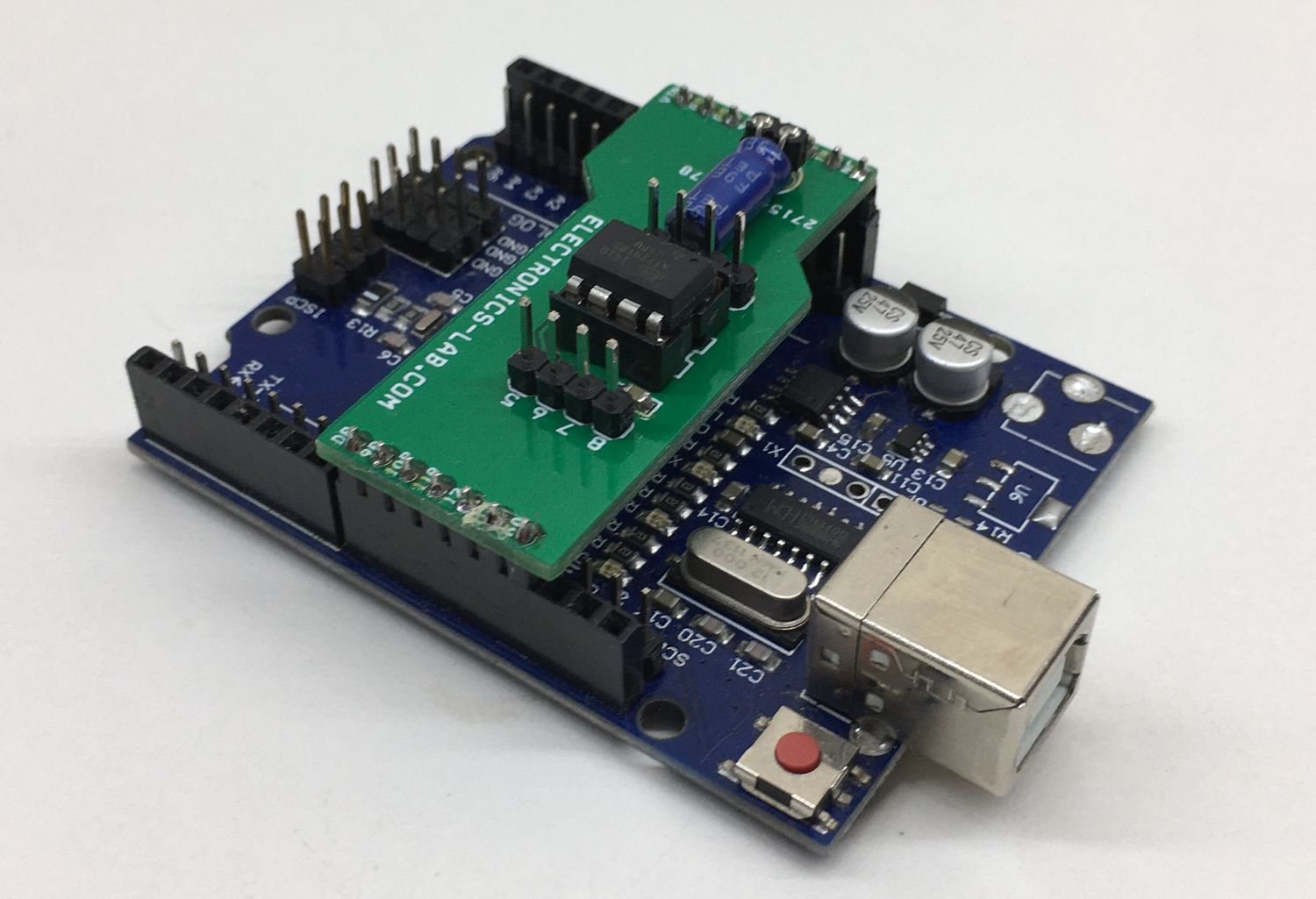

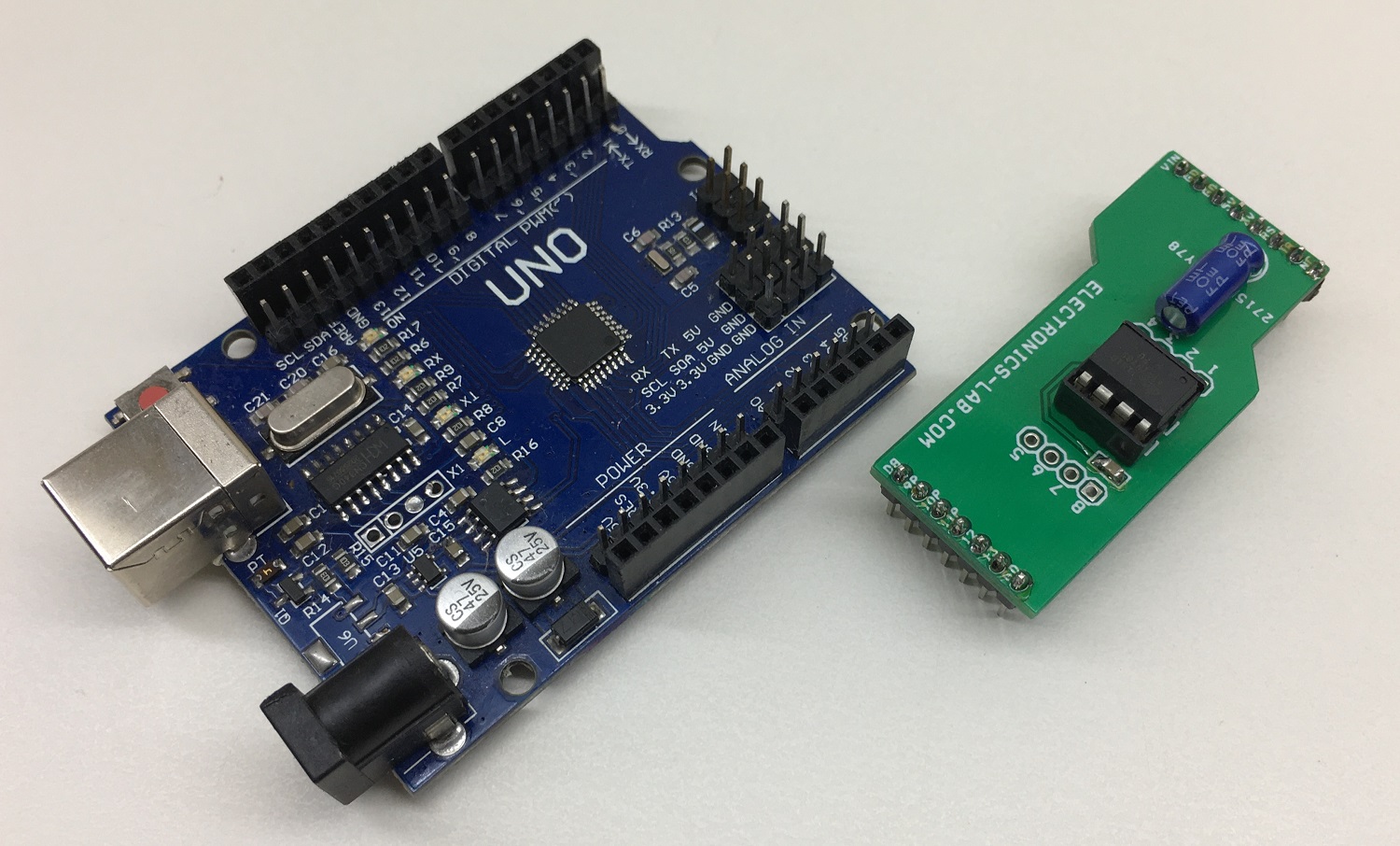

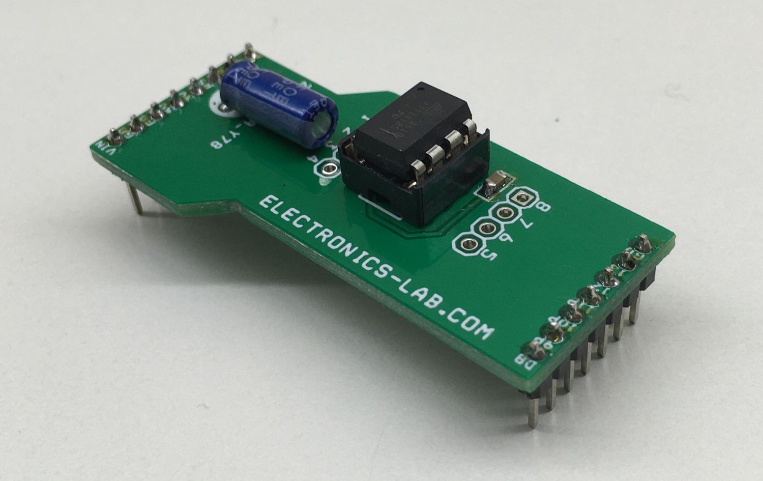

This Arduino shield transforms your Arduino UNO into an ISP-Programmer for the ATtiny85 microcontroller. The board simplifies the Boot-loader burning on the ATtiny85 chip.

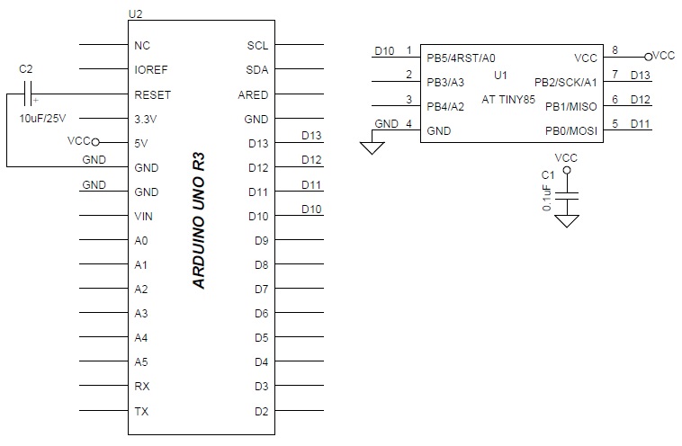

This Arduino shield transforms your Arduino UNO into an ISP-Programmer for the ATtiny85 microcontroller. The board simplifies the Boot-loader burning on the ATtiny85 chip. It consists of an 8-pin DIP socket to insert the new ATtiny85 chip, C1 decoupling capacitor, and C2 capacitor is provided to avoid the Arduino UNO from being auto-reset when we upload the program to the ATtiny85 chip. The project is a good choice when the user wants to shrink the Arduino project into an 8-pin microcontroller and when the project requires only a few I/O pins.

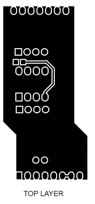

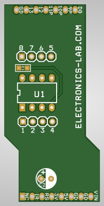

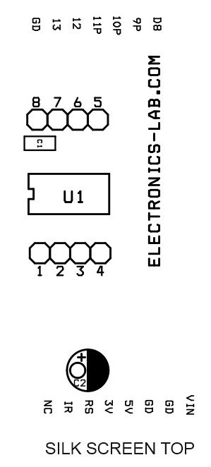

Features:

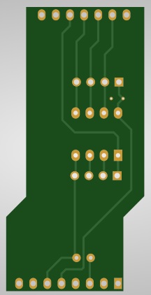

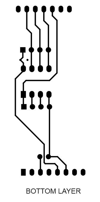

- PCB dimensions: 25 x 51.12 mm
Schematic

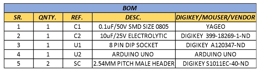

Parts List

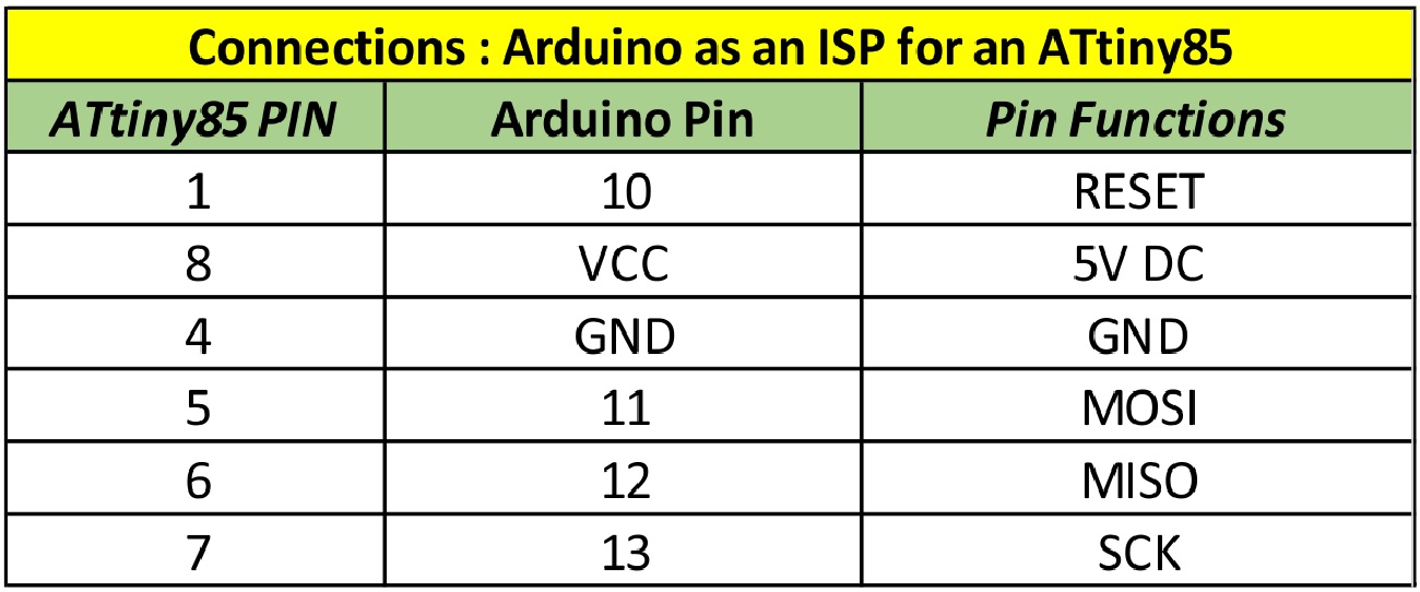

Connection

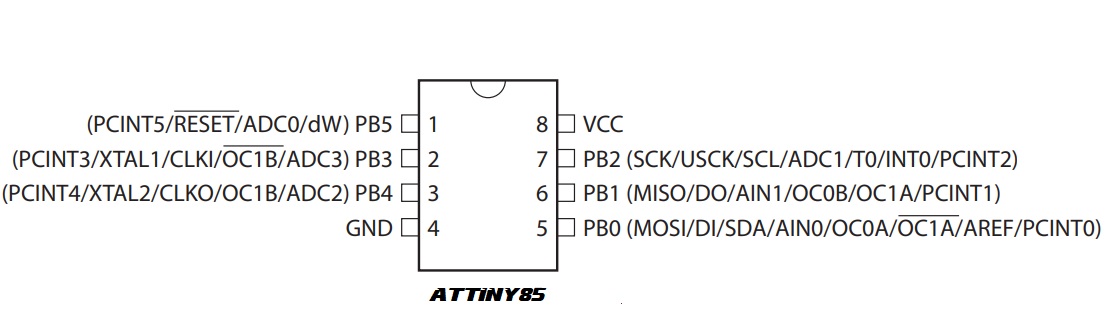

ATtiny85 Pinout
