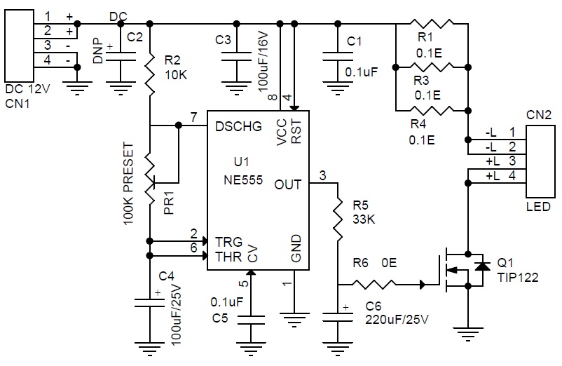

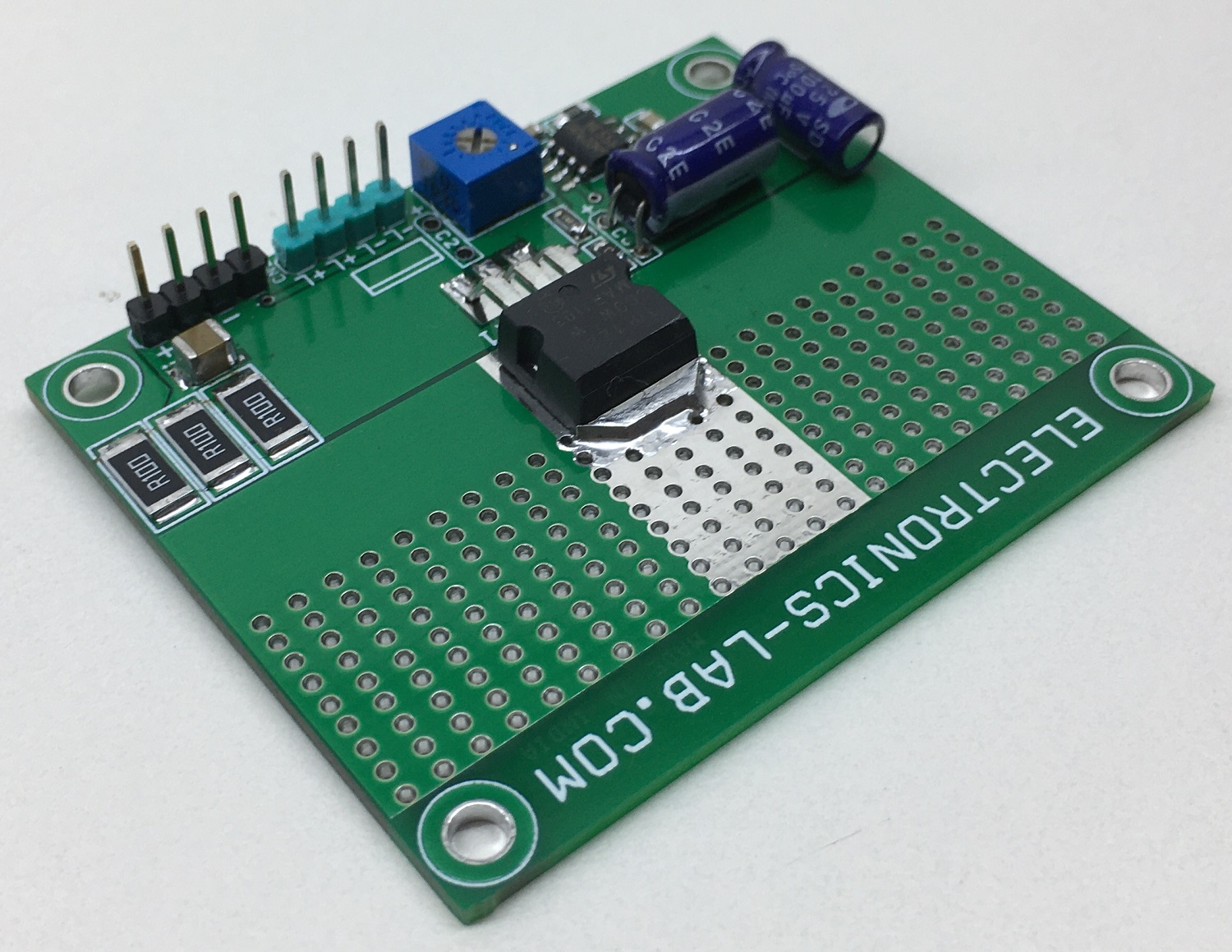

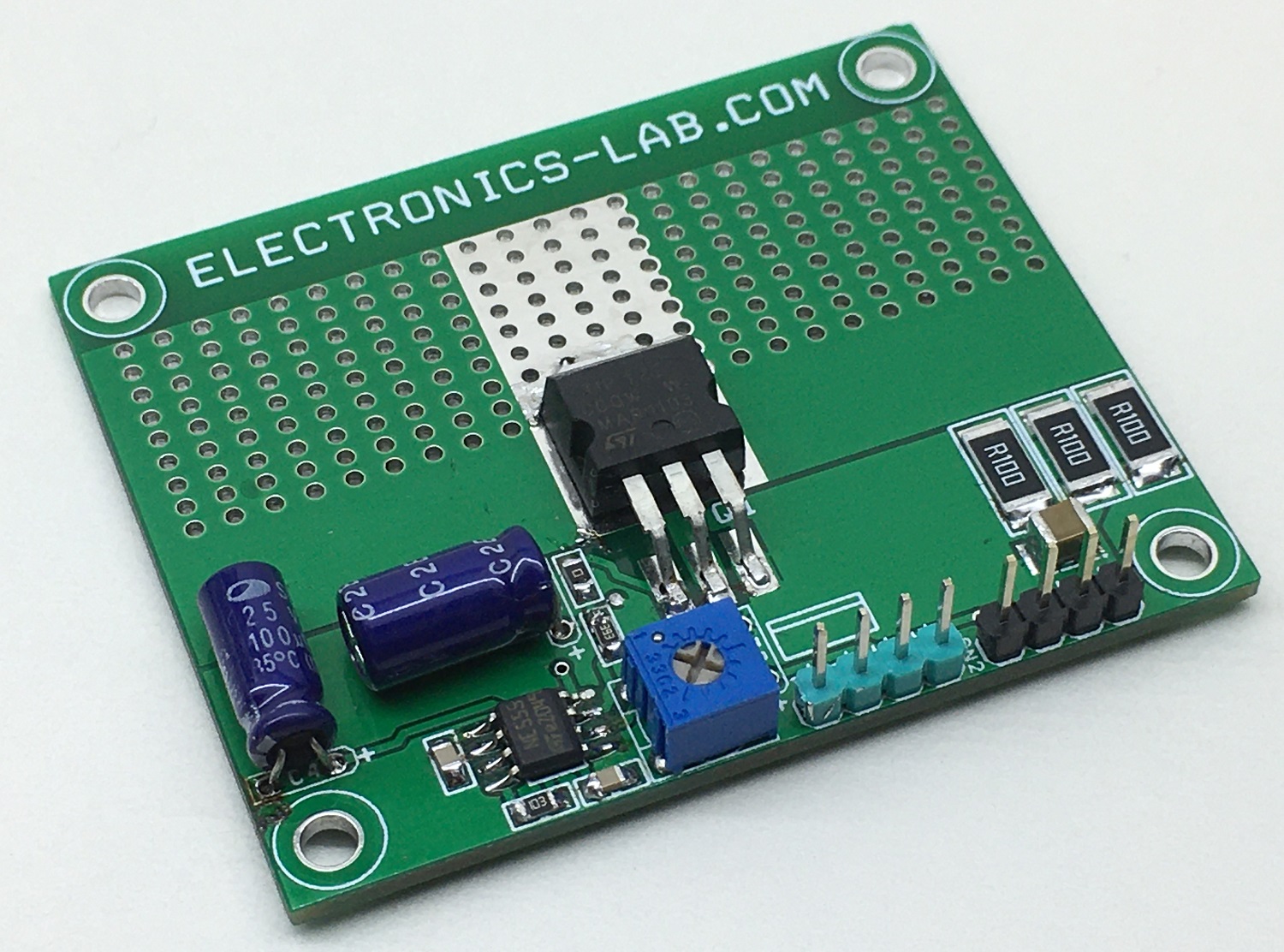

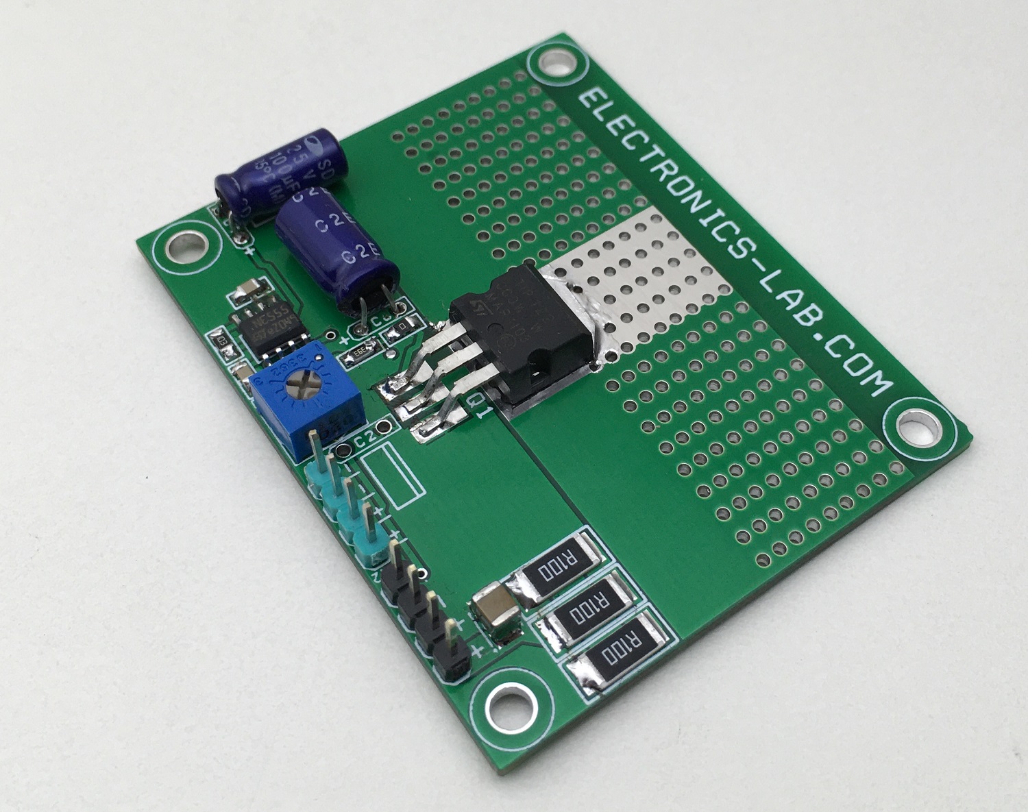

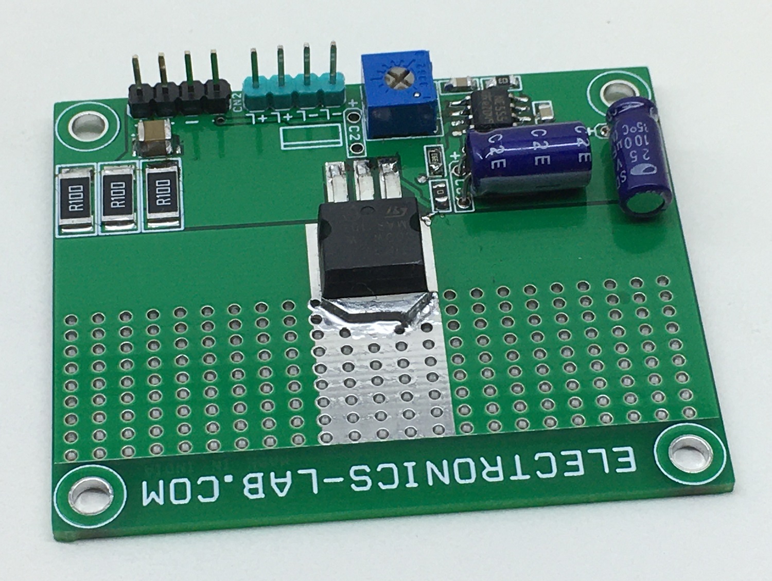

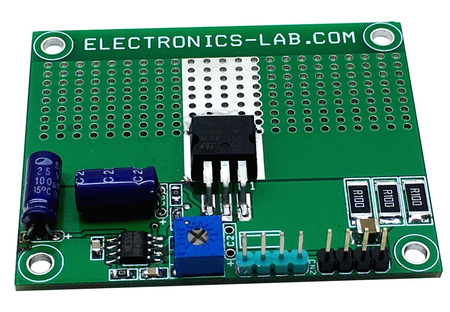

In general, generating an LED fade effect requires a microcontroller or another expensive circuit. We have built this low-cost LED fading board using an inexpensive 555 Timer. The 555 timer is used as an astable multivibrator, which generates low-frequency pulses, further, this pulse train is feed to the base of BJT transistor TIP122 with a series resistor along with a high-value electrolytic capacitor. The combination of resistor R5 and capacitor C6 at the base of Q1 gradually increases and decreases the base voltage which provides soft ON/OFF (Ramp) to the load. The circuit can drive a load up to 18W without heatsink. An onboard potentiometer is provided to adjust the frequency of flash. Connector CN1 DC is for 12V Input, Connector CN2 is provided to connect the LED. This circuit also can be used as a LED Strobe Light and covert a regular 12V LED Light into a Flashing Strobe Light with few changes of components.

Note 1: This circuit can drive 12V LED directly, thus use R1, R3, R4 at 0 Ohms, to drive bare LED choose appropriate series resistor R1, R3, and R4 as per LED load current requirement.
Note 2:  The circuit is built for low-frequency operation, to use as a high-frequency flasher choose C4 10uF /25V or lower capacitance.

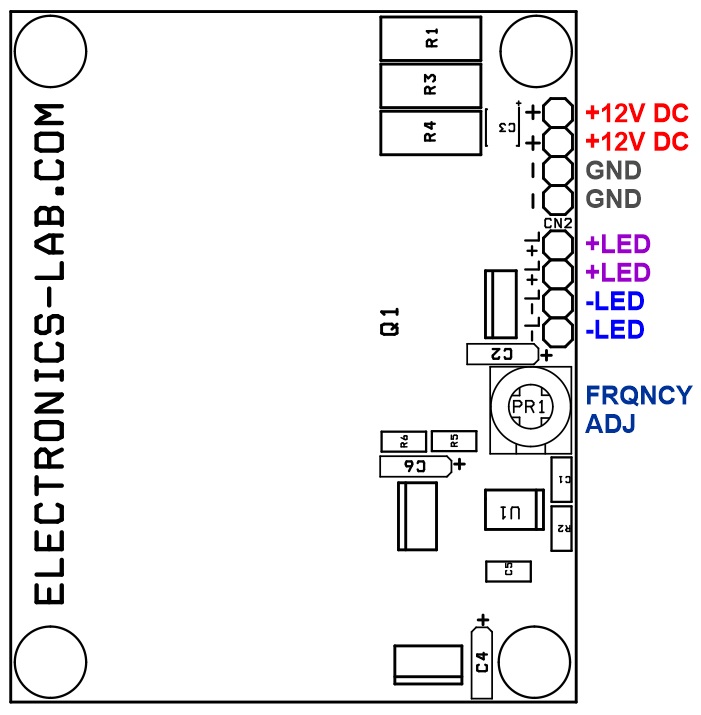

  • Header Connector for Power Supply and LED
  • Large Thermal Area on PCB provided for heat decapitation

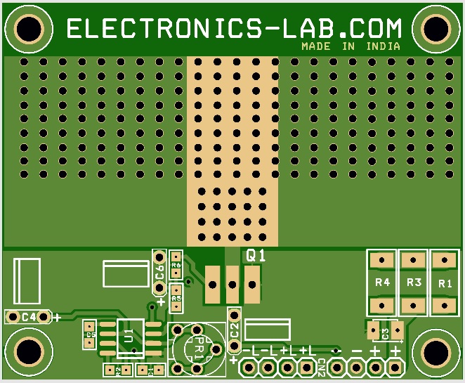

  • PCB Dimensions 60.48x 49.53 mm
Schematic

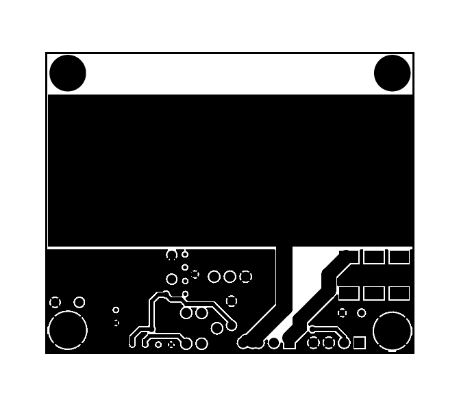

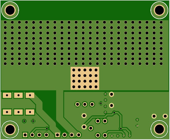

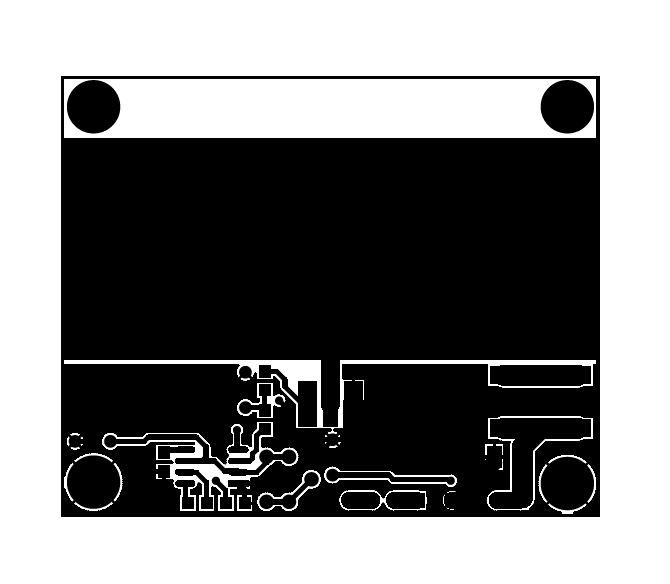

Gerber View

Hello, first of all thank you for all your effort.
With respect; at the schematic, there is a mistake. L- should be L+ and L+ should be L-.
