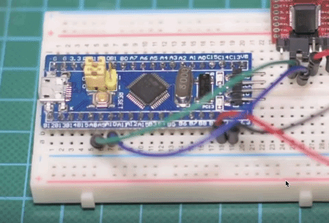

Schematics
As mentioned earlier, we will connect the STM32F1 board to the 1.8″ ST7735 based colored TFT Display along with a push button. The push button will be used to instruct the board to start the calculation.
Connect the components as shown in the Schematics below.
To make the connections easy to replicate, the pin to pin connections between the STM32 and the display is described below.
STM32 – ST7735
5V - VCC
GND - GND
PA2 - CS
PA3 - DC
PA4 - RST
PA5 - SCK
PA7 - SDA
3.3V - LED

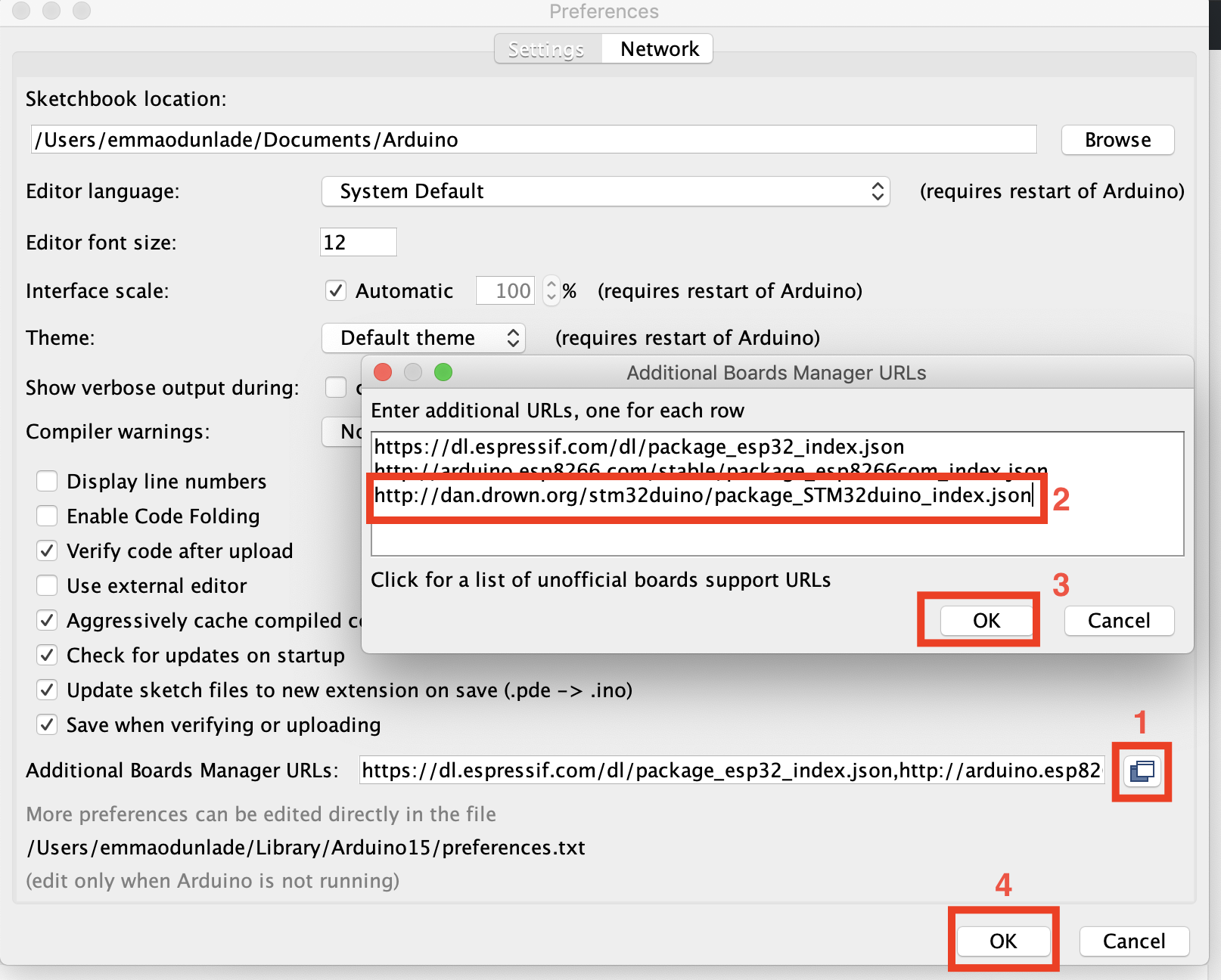

Setting up the Arduino IDE for STM32
As with most boards not made by Arduino, a bit of setup needs to be done before the board can be used with the Arduino IDE.  This involves installing the board file either via the Arduino Board manager or downloading from the internet and copy the files into the hardware folder. The Board Manager route is the less tedious one and since the STM32F1 is among the listed boards, we will go that route.
Start by adding the link for the STM32 board to the Arduino preference lists. Go to File -> Preferences, then enter this URL ( http://dan.drown.org/stm32duino/package_STM32duino_index.json ) in the box as indicated below and click ok.
Now go to Tools -> Board -> Board manager, it will open a dialogue box with a search bar. Search for STM32F1 and install the corresponding package.
The installation procedure will take a few seconds. After that, the board should now be available for selection under the Arduino IDE board list.

Uploading Code to the STM32
Uploading sketches to the STM32f1 is a little bit complex compared to standard Arduino compatible boards. To upload code to the board, we need an FTDI based, USB to Serial converter.
Connect the USB to serial converter to the STM32 as shown in the schematics below.
Connect FTDI to STM32
Here is a pin to pin map of the connection
FTDI  – STM32
VCC - 5V
GND - GND
Rx - A9
Tx - A10
With this done, we then change the position of the board’s state jumper to position one (as shown in the gif below), so as to put the board in programming mode. Press the reset button on the board once after this and we are ready to upload the code.
On the computer, ensure you select “Generic STM32F103C board” and select serial for the upload method after which you can hit the upload button.
Select the board and set upload method to serial
Once the Upload is complete, change the state jumper to position “0” this will put the board in “run” mode and it should now start running based on the code uploaded. At this point, you can disconnect the FTDI and power the board over its USB. In case the code does not run after powering, ensure you have restored the jumper properly and recycle power to the board.

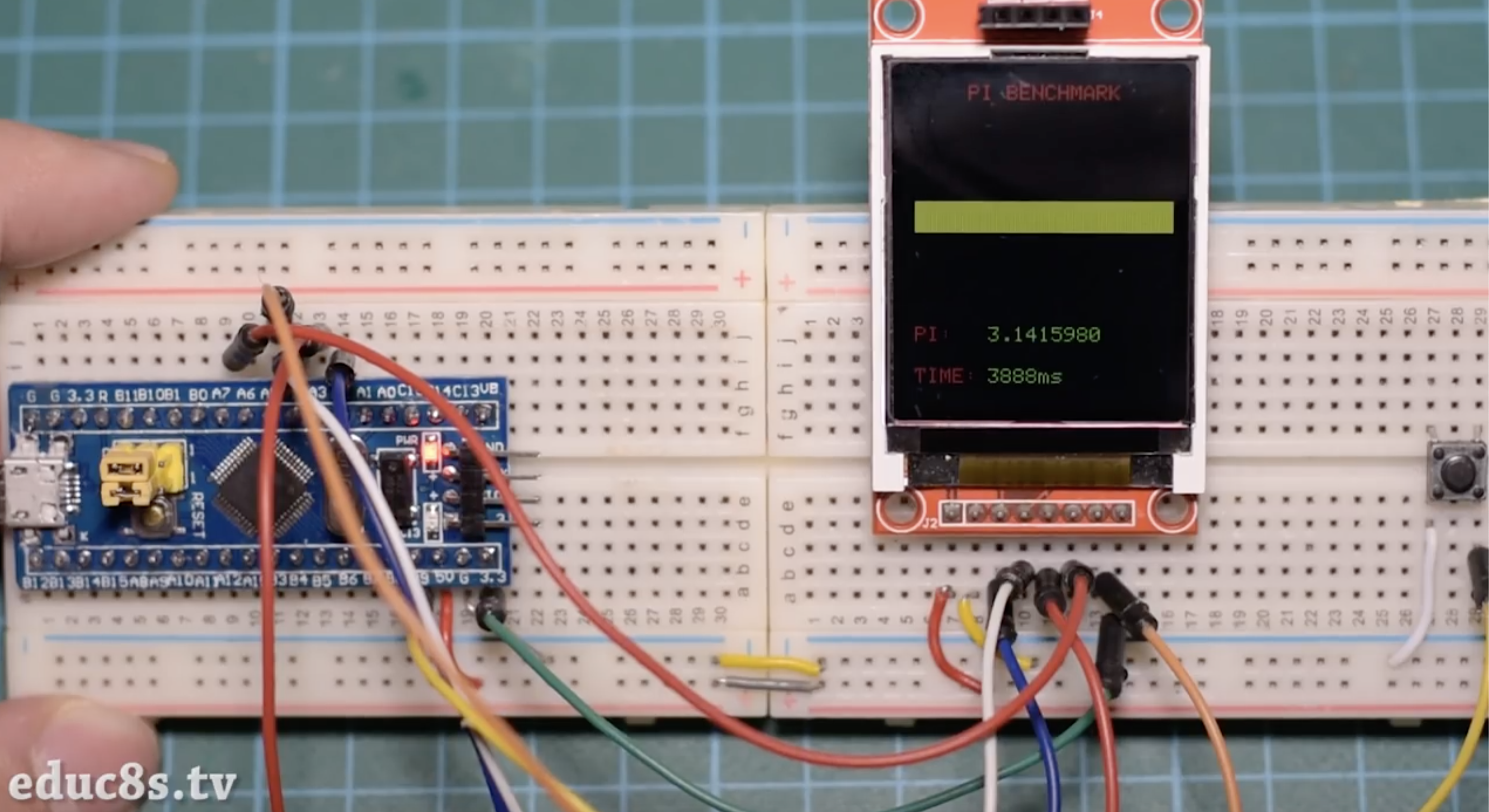

Demo
With the code complete, follow the upload process described above to upload the code to your setup. You should see the display come up as shown in the Image below.
Press the pushbutton to start the calculation. You should see the progress bar slide gradually until the end. At the end of the process, the value of Pi is displayed along with the time which the calculation took.
The same code is implemented on an Arduino Uno. The result is shown in the image below.
Arduino Speed Test
Comparing these two values, we see that “Blue Pill” is over 7 times faster than the Arduino Uno. This makes it ideal for projects which involves heavy processing and time constraints. The small size of the Blue pill also serves as an advantage here as it is only a bit bigger than the Arduino nano and it can be used in place where the Nano won’t be fast enough.
