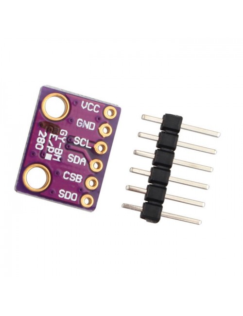

  1. GY-BME280 Sensor

BME280 – Arduino
SCL - A5
SDA - A4
VCC - 3.3v
GND - GND
