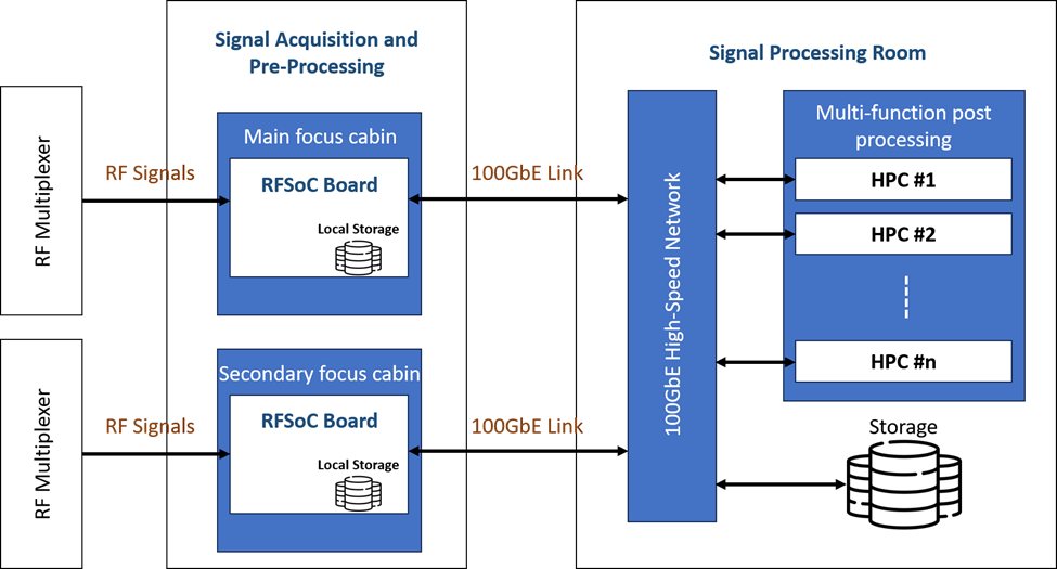

The figure below provides an overview of the radio telescope backend system, which is built on a heterogeneous architecture incorporating RFSoC, CPU, and GPU components. It includes a Signal acquisition and pre-processing block, a multi-function post-processing block, and a recorder/storage.
The signal acquisition and preprocessing unit utilize high-performance, low-power RFSoC technology with integrated high-speed 2.5 GSPS ADCs at 12-bit precision. RF multiplexers switch signals from various receivers, covering the entire passband with a maximum simultaneous bandwidth of 14 GHz. It also possesses local storage capabilities for retaining received signals, which can be transmitted to a post-processing unit when necessary for further processing.
The multifunctional post-processing unit accepts high-speed digital signals via a 100 GbE data exchange network. It enables the selection and loading of signal processing modes, including pulsar, spectral line, continuum, and baseband modes. The system offers Radio Frequency interference (RFI) mitigation options tailored to the observed electromagnetic environment. This unit comprises multiple high-performance computer (HPC) nodes that dynamically adjust CPU and GPU computing cores to match signal processing bandwidth and complexity, ensuring flexibility and scalability. Processed high-speed data is buffered into the storage, capable of handling data at a maximum rate of 4 GB/s.
