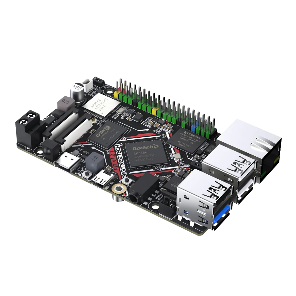

Rockchip RK3566 Powred BIGTREETECH Pi 2 Features Gigabit Ethernet, Dual-band Wi-Fi and more
The BIGTREETECH Pi 2 is a powerful single-board computer (SBC) powered by the Rockchip RK3566 chipset. It boasts 2GB of LPDDR4 RAM and a 32GB eMMC module, offering robust performance and ample storage capacity.
BIGTREETECH Pi 2 a RK3566 SBC with 2GB LPDDR4, 32GB eMMC, Gigabit Ethernet, dual-band Wi-Fi, Bluetooth 5.2, USB 3.0, GPIO, and more
The BIGTREETECH Pi 2 is a powerful single-board computer (SBC) powered by the Rockchip RK3566 chipset. It boasts 2GB of LPDDR4 RAM and a 32GB eMMC module, offering robust performance and ample storage capacity. With features like Gigabit Ethernet, dual-band Wi-Fi, and Bluetooth 5.2, it ensures seamless connectivity options. Additionally, the inclusion of a 40-pin GPIO header, USB 3.0, CSI, DSI, and a PCIe 2.1 interface enhances its versatility for various projects. It can be conveniently powered from a 12V – 24V DC input, all packed within a compact 94 x 56mm form factor.
The SBC is powered by a Rockchip RK3566 which features a Quad-core 64-bit Cortex-A55 cores running up to 1.8GHz, accompanying that is the ARM Mali G52 2EE GPU, but it lacks the NPU that we see in modern SBCs.

The BIGTREETECH Pi 2 Specifications
  • Rockchip RK3566 SoC: Quad-core 64-bit Cortex-A55 CPU (up to 1.8GHz) with ARM Mali G52 2EE GPU.
  • Memory/Storage:
    • 2GB LPDDR4
    • 32GB eMMC
    • 1x MicroSD card slot
  • Display/Audio:
    • 1x Micro HDMI
    • 1x 2-line DSI
    • 3.5mm Audio jack
  • Camera:
    • 1x 2-line CSI
  • Connectivity:
    • 1x 10/100/1000Mbps Ethernet
    •  Dual-band 2.4G/5G Wi-Fi
    • Bluetooth 5.2
  • Expansion:
    • M.2 Key
  • I/O Interfaces:
    • 40-pin GPIO header
  • USB:
    • 1x USB 3.0 Type-A
    • 3x USB 2.0 Type-A
  • Power:
    • 12V – 24V DC
  • Mechanical:
    • 94 x 56mm
