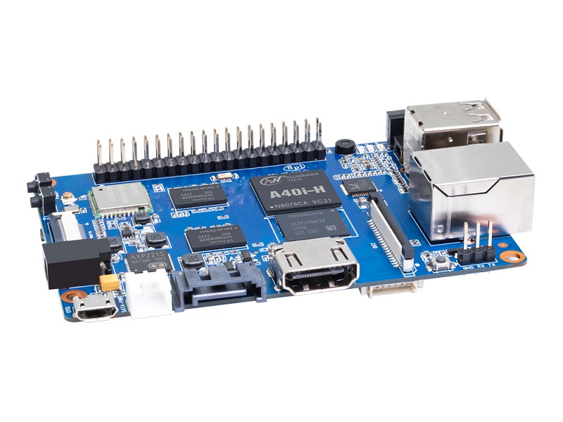

The Banana Pi BPI-M2 Ultra is an Allwinner A40i, Cortex-A7-based SBC which supports a wide -40°C to +85°C industrial temperature range. The SoC was first released in 2018, but the Banana Pi BPI-M2 Ultra is the first board to utilize this SoC.
The SoC was first released in 2018, but the Banana Pi BPI-M2 Ultra is the first board to utilize this SoC. However, using an industrial-grade SoC in a board that’s not industrial-grade doesn’t automatically enhance its grade, especially since the Realtek RTL8211E chip on this board is only certified for 0 to 70°C.
The SBC supports 8GB eMMC flash, a SATA interface, a microSD card slot, an HDMI 1.4 port up to 1080p60, 1x Gigabit Ethernet port, a 40-pin Raspberry Pi-compatible header with 28x GPIOs, and many other features.

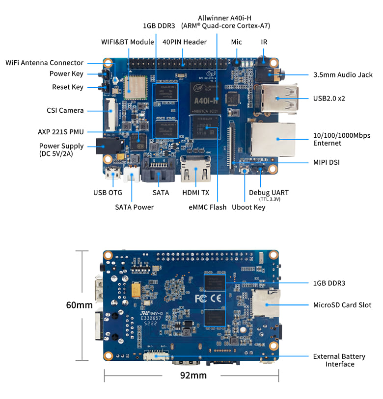

Banana Pi BPI-M2 Ultra Specifications
  • SoC: Allwinner A40i, quad-core Arm Cortex-A7, Mali-400MP2 GPU @ 500 MHz.
  • Memory: 2GB DDR3 SDRAM.
  • Storage: 8GB eMMC, SATA, microSD slot.
  • Video: HDMI 1.4 (1080p60), MIPI DSI, RGB, LVDS.
  • Audio: 3.5mm jack, HDMI audio, built-in mic.
  • Camera: CSI connector.
  • Connectivity: Gigabit Ethernet (Realtek RTL8211E/D), Wi-Fi 4, Bluetooth 4.0 (AP6212).
  • USB: 2x USB 2.0 host, 1x micro USB OTG.
  • Expansion: 40-pin header (Raspberry Pi compatible), GPIOs, I2C, SPI, UART, PWM.
  • Debugging: 3-pin UART.
  • Miscellaneous: Reset, power, u-boot buttons, IR receiver, LEDs.
  • Power: 5V/2A barrel connector, 3.7V Lithium battery, AXP221s PMIC.
  • Dimensions: 85 x 56 mm.
