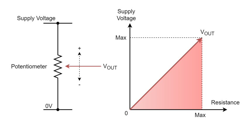

In the following figure, a potentiometer is used to select different voltage levels from 0 to VMAX depending on the position of the potentiometer’s knob. Whilst, moving through this range there is no obvious step or abrupt change in output voltage and finer values can be selected, carefully. In other words, it can be said that whilst moving from 0 to VMAX or any in-between positions of the potentiometer’s knob, the change in the output signal is continuous. This resembles analog signals generated by real-world sensors such as temperature, pressure, sound, and light intensity levels.
Figure 1: A potentiometer and its analog output

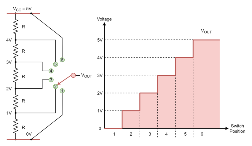

In contrast, the following figure shows different selectable positions of a rotary switch. Here, the range from 0 to VMAX, has been divided into different stages or levels which are selectable by rotary switch. Each stage comprises a resistor which is in series with preceding levels. This arrangement causes a voltage drop of a fixed level due to a fixed resistor at each level and as the resistors are also the same in values, therefore, each stage drops 1V. Hence, this kind of rotary switch has selectable voltage levels of 0V, 1V, 2V, 3V, 4V, and 5V. The output of such a rotary switch is discrete or non-continuous. Similarly, a “LOW” or a “HIGH” value, in the case of binary, is referred to as a digital signal as it represents discrete values.
Figure 2: A rotary switch and its discrete output

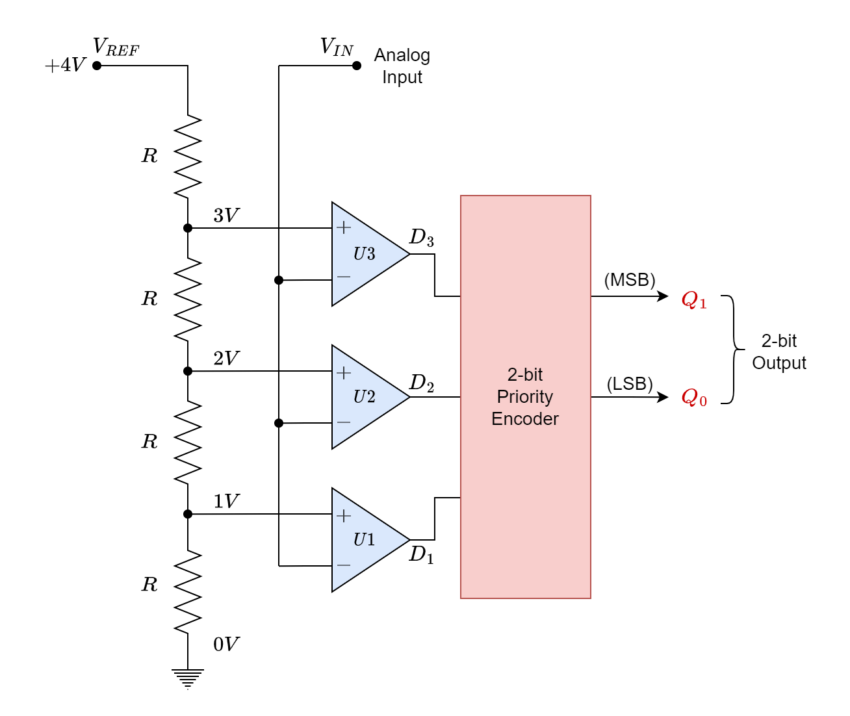

In the following figure, a 2-bit DAC has been shown comprising of 3 comparators and that could be verified also using the formula (2n – 1) which gives a result of 3 for n = 2. In this circuit, four resistors of the same values are used that produce ideally equal voltage drops at the input of comparators. The input signal is compared by all comparators with these respective voltage drops.
Figure 4: A circuit of 2-bit analog-to-digital converter (ADC)
In order to ease the understanding process, VREF is kept at 4V so there is an ideally 1V drop across each of these four (04) resistors. So, when the input voltage is (0 < VIN <1V) then the output of all three comparators is zero i.e. D1 = D2 = D3 = 0, and the priority encoder outputs “00”. A priority encoder such as TTL 74LS148 uses priorities that are allocated to each input. In simple words, a priority encoder here converts or encodes three (03) inputs into a 2-bit digital number.
Likewise, continuing with the comparison process of the input signal, if the input voltage is (1 < VIN < 2V) then comparator (U1) will output a “HIGH” signal as, in this case,  input voltage (VIN) is greater than the (VREF1 = 1V). The inputs at the priority encoder will be D1 = D2 = 0 and D3 = 1 which generates an output of “01”.
The same comparison procedure is followed for input voltages falling within ranges of 2 to 3V & 3 to 4V. The following table illustrates the input & output conditions of input voltage, comparator outputs, and digital outputs of the priority encoder.

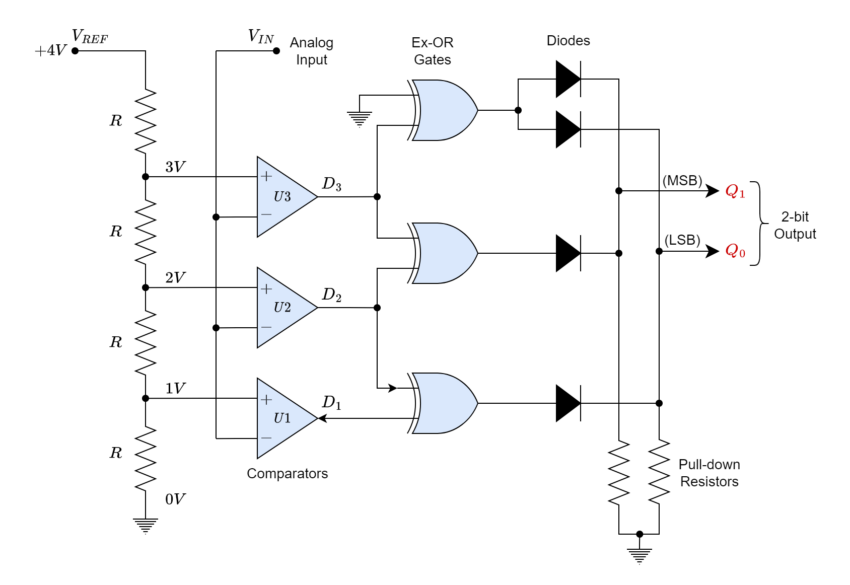

The priority encoders are usually available commercially for 8-to-3-bit devices i.e. TTL 74LS148, whereas, in the above 2-bit ADC, a 4-to-2-bit priority encoder is used. A 4-to-2-bit priority encoder can be constructed using discrete components as shown in the following figure.
Figure 5: A circuit of a 2-bit analog-to-digital converter (ADC) using discrete logic gates
In the above circuit, Exclusive-OR (XOR) gates are used to generate output by comparing the outputs of adjacent comparators. In case, there are differentiating inputs i.e. “HIGH” and “LOW” or vice versa then XOR generates a “HIGH” signal and, a “LOW”, whenever both inputs are the same. The diodes are used to allow uni-directional flow of signal and pull-down resistors ensuring that none of the outputs floats to give erroneous digital outputs.
However, the resolution of this circuit is somewhat low i.e. 1V, and this can be improved by using higher resolution ADC such as a 3-bit ADC.

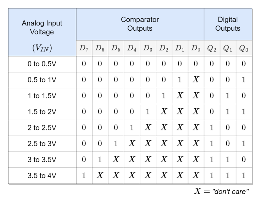

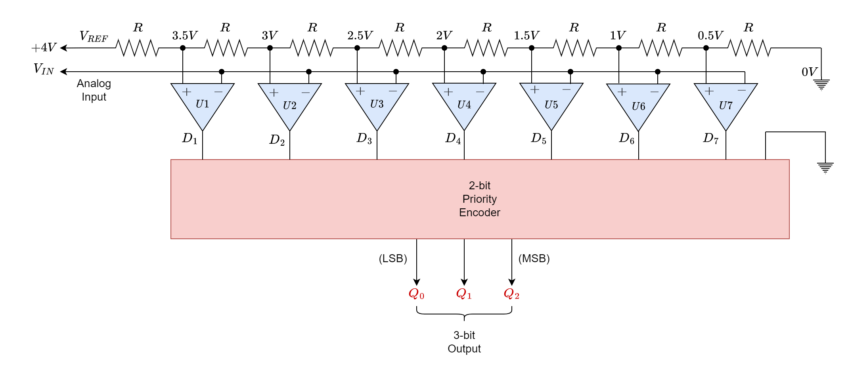

In a 3-bit ADC, a total of seven (07) comparators are required according to (2n – 1) using n = 3, and the voltage drop circuit will contain eight (08) resistors, accordingly. This means that stages of comparison have been increased from three (03) to seven (07) and the voltage comparison level has reduced from 1V to 0.5V (4V/8). So, this 3-bit ADC will be able to sense a change in voltage of 0.5V compared to 1V of a 2-bit ADC, consequently, yielding a high-resolution performance.
Figure 6: A circuit of 3-bit analog-to-digital converter (ADC)
The following table depicts the comparator and digital outputs compared to input signal ranges for a 3-bit ADC.
Similarly, the construction of a 4-bit ADC requires 15 (24 – 1) comparators, and, likewise, 255 (28 – 1) & 1023 (210 – 1) comparators are required for 8-bit & 10-bit ADCs, respectively. So, with the increase in resolution, the circuitry becomes more and more complex. However, the parallel or flash-type analog to digital converters has the advantage of processing comparisons in parallel yielding a faster conversion result at its outputs.
