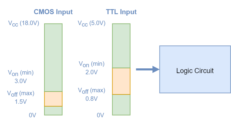

Voltage Levels
There are many different families of logic gates, and as discussed above, many different technologies get used. Each family within the technology will also have it’s own voltage range that can be accommodated by the inputs to produce that “0” and “1” signal. By in large, TTL is fairly simple with regards to what constitutes a signal. A voltage between 2.0V and 5.0V is a logic high and a voltage between 0V and 0.8V is considered logic low. This is assuming that a +5V rail is used as the power supply, if it is lower, then the upper end of the logic high is reduced to the supply voltage.
Due to the technology of CMOS devices using FET’s rather than bipolar transistors, CMOS uses slightly different logic levels. A logic high is classed as between 3.0V and 18.0V, and a logic low is below 1.5V. Similarly to the TTL voltage levels, the upper limit is reduced with a lower supply voltage. In essence, a logic low should be as close to ground as possible, and a logic high can comfortably be 5V in either technology, with 3.3V operation also being comfortable in TTL based systems. CMOS systems could run on 3.3V, but it would likely be too close to the 3.0V switch, to make a stable circuit.
Logic Inputs
fig 3: The standard inputs to a CMOS and TTL logic gate
