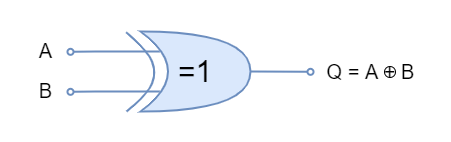

Logic Ex-OR Gate Symbol & Truth Tables
The representation of an Ex-OR logic by a symbol is shown in the following figure. Basically, a two-input Ex-OR logic is a modulo two-adder as it gives the sum of two binary numbers.
Exculsive OR Symbol
Figure 1: Logic Ex-OR Gate Symbol

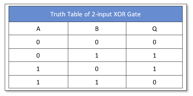

The truth table of a two-input Ex-OR logic is shown below:
Exclusive OR Gate Truth Table for two inputs
It is clear from the truth table that when inputs are at different levels i.e. either “01” or “10” then the Ex-OR logic output is “HIGH” and in case the inputs are at the same level then output is “LOW”. In other words, “A” or “B”, not both!.

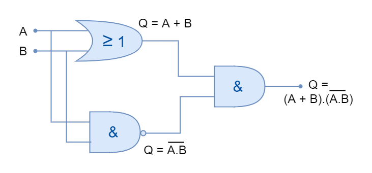

Ex-OR (XOR) Logic Circuit
Using the above equation of a two-input Ex-OR logic, an equivalent circuit can be constructed which is shown in the following figure.
Figure 3: Equivalent Circuit of an Exclusive-OR logic
The above equivalent Ex-OR logic comprises AND, OR, and NAND logics. However, it is not a good practice to include multiple logics for the construction of logic gates and a better Ex-OR circuit can be constructed using only NAND logic gates.

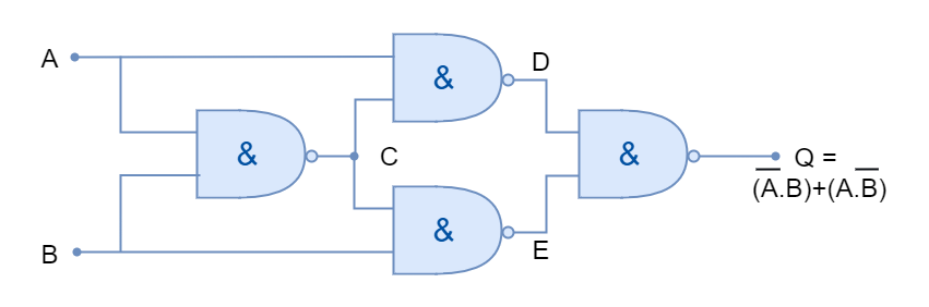

The construction of Ex-OR gate using NAND gates only is shown below:
Figure 4: Equivalent Circuit of an Exclusive-OR logic using NAND Gates

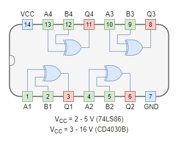

Commercially Available E-OR (XOR) Gates
The XOR logic gates are available in both TTL and CMOS logic families. The most commonly used XOR logic packages are:
CMOS based XOR Gate IC Package
  • CD4030B Quad 2-input
TTL based XOR Gate IC Package
  • 74LS86 Quad 2-input
Figure 5: 74LS86 & CD4030 XOR 2-input Quad Package

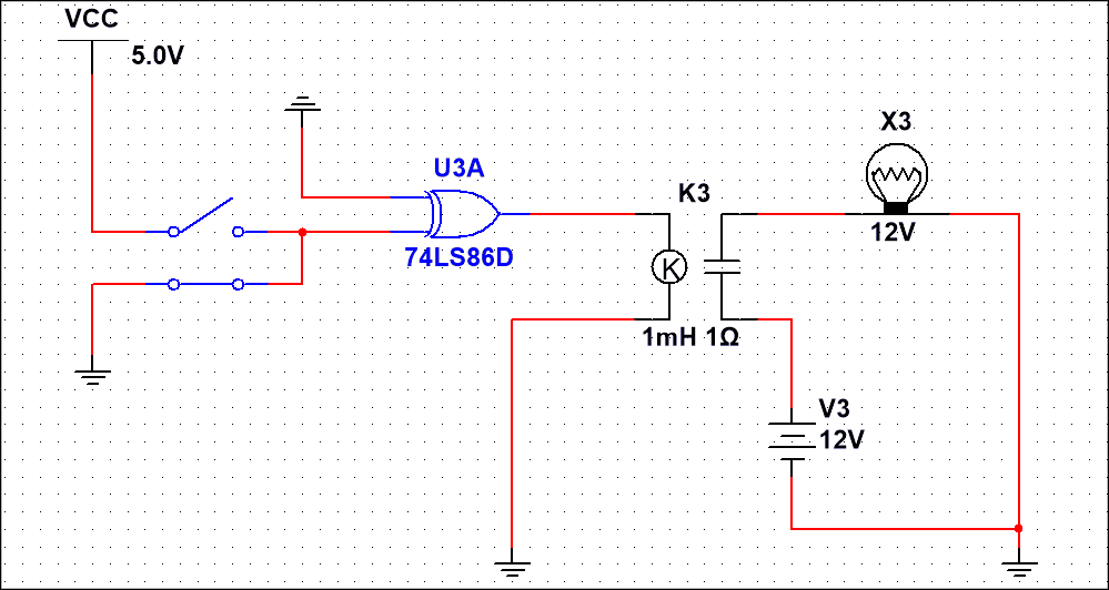

Example of XOR Logic
In the following figure, an XOR gate is used to drive a 12V relay to switch on the lamp using NI Multisim. The XOR gate (74LS86) turns off the relay when all of the inputs are connected to VCC/ Ground. The relay thus turns off the lamp through an external circuit of 12V. When one of the inputs is connected to VCC, XOR logic goes “ON” turning the relay and lamp to “ON” state.
Figure 6: A Multisim circuit showing XOR logic to control an external circuit
