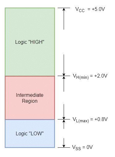

As discussed in previous articles, the logic gates are characterized not only by the operating voltage but also by their current sinking and sourcing capabilities. Besides the two distinct voltage states presenting logic states “0” & “1”, there are maximum and minimum voltages defining voltage ranges for each state. In the following diagram, the voltage ranges for logic “HIGH” and “LOW” states are shown which are separated by an intermediate state.
Figure 5: The logical sensing voltage levels of TTL inputs
It is obvious from the figure that the input needs to have at least 2V to be considered as a logic “HIGH” and, on the other hand, an input should remain below (maximum) a 0.8V to be sensed as a logic “LOW”. In short for a TTL 74LS family, the logic “HIGH” state ranges from 2.0V to 5.0V and the logic “LOW” state from 0.8V to 0V.

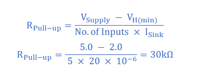

When an input is pulled high it acts as a current sink and positive current flows into it. The TTL74S logic series has a rated positive current of 20uA and a minimum voltage threshold for a logic “1” of 2.0V. In the calculation of the pull-up resistor, the minimum voltage threshold is used to remain on the safest side.
The resistance value obtained above is the maximum value which will ensure a maximum voltage drop of 3V at a minimum 20uA sink current. The voltage is usually kept close to the upper limit of voltage (close to +5V) and this is done by reducing the pull-up resistance value. However, such a close margin can be easily overcome due to resistance tolerance or change in supply voltage, etc. Moreover, the power dissipation is more in low-value pull-up resistance due to an increase in current which should be avoided in any case. The suitable resistance value for a pull-up resistance ranges from 10kΩ to 100kΩ.
In a similar way, a number of inputs can be tied together using a single pull-up resistance rather than using pull-up resistance at each input, separately. In such a case, the current flowing through single pull-up resistance will number of inputs times the minimum positive (sink) current. In the following calculation, a pull-up resistance value is determined through which five inputs will be pulled up.

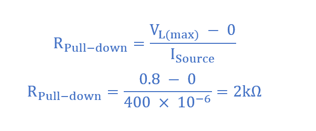

Pull-down Resistors
Just like a pull-up resistor, the pull-down resistor ties the input with an effective voltage level. However, contrary to a pull-up resistor, a pull-down resistor connects the input of a logic gate with the Ground (0V) or logic “0” state. The input becomes a current source and supplies current through a pull-down resistor towards the ground. The resistive value of a pull-down resistor for a TTL logic gate is more critical compared to the one used with a similar CMOS gate. It is because of TTL’s high current sourcing capability when its input is in a “LOW” state. The value of the pull-down resistor can be calculated in a similar fashion described above for a pull-up resistor. The TTL 74LS logic series requires a maximum of 0.8V in order to sense it as logic “0” and can deliver a minimum source current of 400uA. The pull-down resistor can be calculated using these parameters as follow:
This is the maximum pull-down resistor which ensures that voltage drop would be sufficient enough at the input to be sensed as logic “LOW”. Further increase in the pull-down resistor value will increase the voltage drop across the resistor and a voltage above 0.8V would be sensed as a logic “HIGH”. The good practice is to keep at least a 0.4V drop across the pull-down resistor.

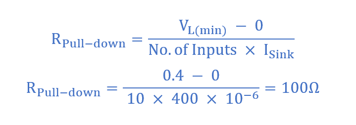

A number of unused inputs can be connected together with a single pull-down resistor. A sample calculation for a fan-in of 10 is shown below:

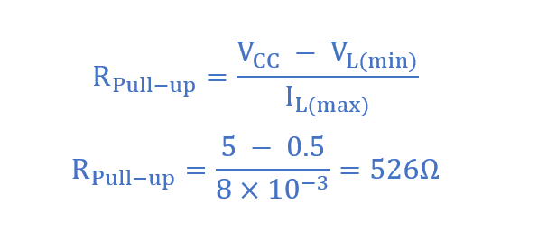

The value of the open-collector pull-up resistor depends upon the load which is driven through it and the current-sinking capability of the open-collector (transistor). When the transistor is in an “ON” state then current flows through the transistor and the value of the pull-up resistor must not exceed the current handling rating of the transistor. On the other hand, the load is supplied through this pull-up resistor when the transistor is in the “OFF” state. In this state, the pull-up resistor value should allow the required load current.
The output voltage levels are required to remain under permissible limits in order to be recognized as logic “LOW” or “HIGH”. For TTL 74LS logic family devices, the minimum “HIGH” logic voltage is 2.7V and the maximum “LOW” logic voltage is 0.5V. In short, the outputs of TTL 74LS devices are considered as logic “LOW” within 0 to 0.5 Volts and as logic “HIGH” within 2.7 to 5.0 Volts.
Consider the following calculation as an example for TTL NAND open-collector (74LS01):
This is the minimum resistance required to limit the current to 8mA which is the maximum current at the logic “LOW” state. In a similar way, the pull-up resistor value can be calculated through which an external load is connected. The external load usually requires high voltage or current and, for this purpose, normally hex inverter buffers are used. The TTL 74LS06 Hex Inverter Buffer uses 5V for biasing but its open-collector can support up to 30 Volts and a maximum of 40mA current at logic “LOW” level.

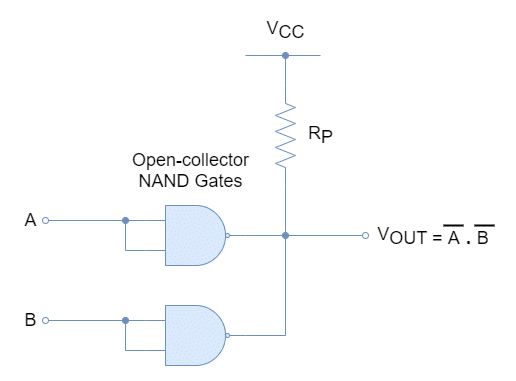

Wired AND Logic
The open-collector outputs can be connected together through a single pull-up resistor. These open-collector outputs tied together forms the Wired AND logic because the outputs are AND’ed together just like they were connected to an AND gate.
