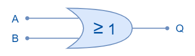

Logic OR Gate Symbol & Truth Tables
The representation of an OR logic by a symbol is shown in the following figure. Its symbol denotes the addition/ OR logic operation.
Logic OR Symbol
Figure 2: Logic OR Gate Symbol

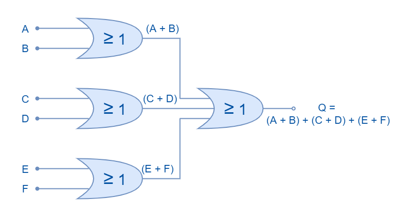

The Boolean expression can be extended to include multiple inputs to obtain OR logic operation. However, commercially available OR logic circuits have up to four inputs but the number of inputs can be further extended by cascading the OR logic circuits. In the following figure, three two-input logic OR gates and one three-input logic OR gate are cascaded to construct a six-inputs (2 x 3 = 6) OR logic circuit.
Cascaded Logic OR Gates
Figure 3: 6-input OR logic constructed by cascading multiple OR gates
The Boolean expression for this cascaded circuit can be written as:
Q = (A + B) + (C + D) + (E + F)

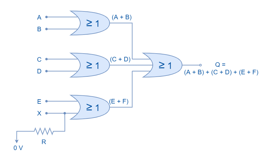

Odd Number of Inputs
The logic OR circuit having an odd number of inputs can be constructed by connecting the unused input to logic “LOW”. This will ensure that another input(s) of the logic OR gate is truly reflected at the output. It is explained in the following diagram where unused input is pulled down using a pull-down resistor.
Logic OR Gate with odd number of inputs
Figure 4: The OR logic having an odd number of inputs

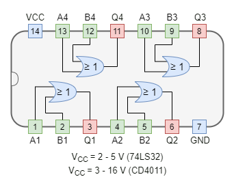

Commercially Available OR Gates
The logic OR gates are available in both TTL and CMOS logic families. The most commonly used OR logic packages are:
CMOS based OR Gate IC Package
  • CD4071 Quad 2-input
  • CD4075 Triple 3-input
  • CD4072 Dual 4-inputs
TTL based OR Gate IC Package
  • 74LS32 Quad 2-input

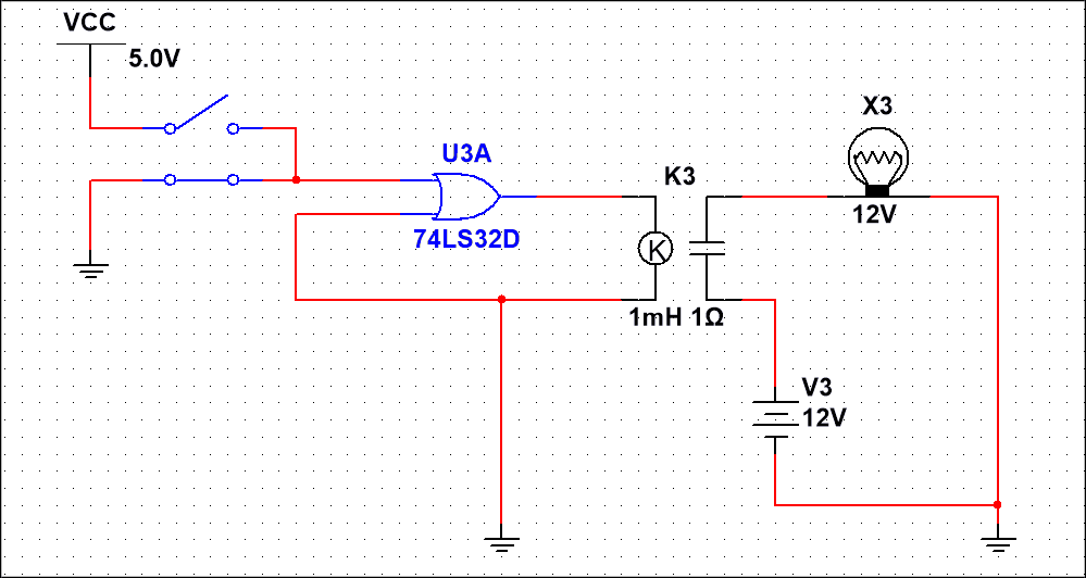

Example of OR Logic
In the following figure, an OR gate is used to drive a 12V relay to switch on the lamp using NI Multisim. The OR gate (74LS32) energizes the relay when any of its inputs is connected to VCC. The relay thus turns on the lamp through an external circuit of 12V. When all of the inputs are connected to ground OR logic goes “OFF”, turning the relay and lamp to “OFF” state.
