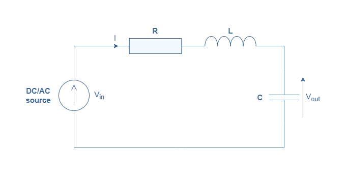

A representation of the RLC circuit is given in Figure 1 below:
fig 1: Illustration of the series RLC circuit

In Figure 1, these three components are interconnected in series. The circuit is either supplied with a DC or AC source and the output is the voltage across the capacitor. The total impedance of the circuit is the sum of the independent impedances previously stated:
ZRLC=ZR+ZL+ZC=R+j(Lω-(1/Cω))

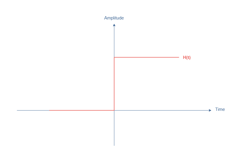

In this section, we will focus on the behavior of the circuit presented in Figure 1 when applying a Heaviside step H(t) to it:
fig 2: Illustration of the Heaviside function
The Heaviside step is characterized by being equal to 0 for t<0 and Vin for t>0. The transition between these two states is similar to an impulsion since the derivative tends to +∞ when t=0.

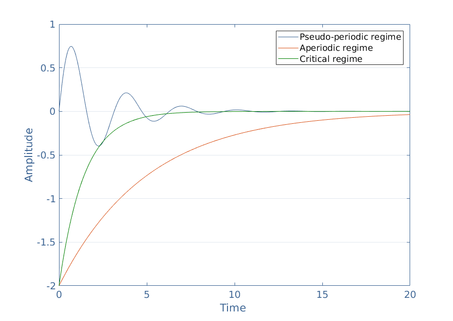

The transient response is complex to determine and involves many steps that will not be detailed in this article. We will admit that its expression can take three different forms and depends on the value of Q=(1/R)√(L/C) called the quality factor of the circuit. Another important parameter is ω0=1/√(LC) which is the fundamental pulsation of the circuit.
When Q>1/2, the regime is said to be pseudo-periodic or to be an underdamped response, the transient response can be written with the form Vout,tr=Ae-αtcos(ωt+Φ). The constants A, α and Φ can be found by considering the initial conditions of the circuit (if the capacitor is charged or not …). The pulsation ω is called the pseudo-pulsation and depends on the fundamental pulsation ω0.
When Q<1/2, the regime is said to be aperiodic or to be an overdamped response, the transient response takes the form Vout,tr=e-αt(A1e-ωt +A2eωt).
Finally, the last case when Q=1/2, which corresponds to the critical regime or critically damped response. In this case, Vout,tr=(A+Bt)e0t.
What is important to keep in mind is that these different solutions dictate how the voltage Vout behaves and tends to its permanent value Vin when a Heaviside step is applied to it:
fig 3: Curves of the different regimes for the transient response
We can comment on this figure by starting to say that each curve tends to 0 when the time increases. It makes sense because we know that Vout=Vin+Vout,tr and Vout(t→+∞)=Vin, therefore, Vout,tr→0.
However, the different possible transient responses do not tend to 0 with the same speed and behavior. The critical regime is the regime that tends the fastest to 0 meanwhile the aperiodic regime is the slowest. The pseudo-periodic regime presents oscillations which amplitude decreases exponentially.

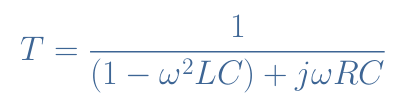

We consider in this section the same circuit presented in Figure 1 now supplied with an AC source. Using the property that in the complex notation, dX/dt=jωX with ω being the angular pulsation of the source, we can rewrite Equation 1 under the following form:
eq 2: Complex second-order differential equation of the series RLC circuit
We can then express the ratio Vout/Vin which is the transfer function T of the series RLC circuit:
eq 3: Transfer function of the series RLC circuit
Knowing that Q=(1/R)√(L/C), ω0=1/√(LC) and considering the parameter x=ω/ω0 called the reduced pulsation, we can rearrange Equation 3 to write the canonical form of the transfer function which simplifies and makes the expression more compact:
eq 4: Canonical form of the transfer function of the RLC circuit

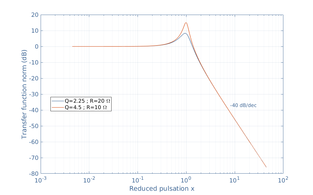

It is interesting to plot the norm of the transfer function in order to obtain the gain of the circuit as a function of the parameter x. The values R=10 Ω and 20 Ω, L=0.2 H, and C=100 μF have been taken for this example:
fig 4: Gain of a series RLC circuit
We can note that the series RLC circuit presented in Figure 1 acts as a second-order low-pass filter in the AC regime since it decreases the output signal for the pulsations higher than ω0, which is commonly called the resonance frequency of the circuit.
Second-order filters have the property to slightly amplify the signal for the frequencies around ω0 and present a decrease of -40 dB/dec after the cutoff frequency, instead of only -20 dB/dec such as for first-order filters.
It is highlighted in Figure 4 that the value of Q (which depends on R) as an effect on the shape of the curve. The peak around the resonance frequency is indeed characterized by its bandwidth Δω=ω0/Q.
In this example, ω0=223 rad/s and Q=4.5 or 2.25, which gives a narrower bandwidth of Δω=50 rad/s for the orange curve and a wider one of 100 rad/s for the blue curve. We can, therefore, note that the quality factor dictates if the resonance is narrow (large Q) or wide (small Q).

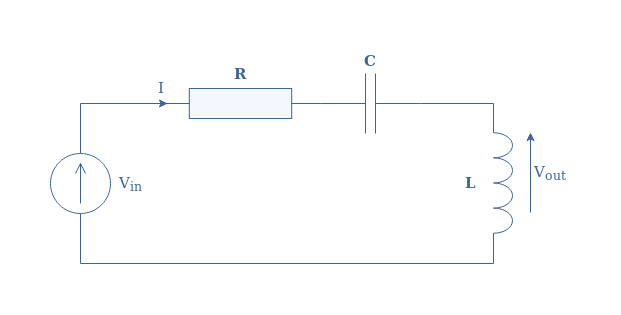

Figures 5 and 6 present two new configurations which will be referred to as RCL and CLR circuits:
fig 5: Illustration of the RCL circuit
fig 6: Illustration of the CLR circuit

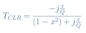

It can indeed be shown that the transfer functions of these two circuits are given by Equations 4 and 5:
eq 5: RCL circuit transfer function
eq 6: CLR circuit transfer function
The nature of these new filters is revealed by plotting the norm of their transfer function with the same values: R=10 Ω and 20 Ω, L=0.2 H, and C=100 μF.
fig 7: Gain of series RCL and CLR circuits
The circuit RCL is a second-order high-pass filter since it attenuates the frequencies under ω0. The circuit CLR is a band-pass filter since it only amplifies frequencies in around ω0. Note that the same commentaries as in the previous section about the shape of the curve as a function of Q still apply for both these filters.
