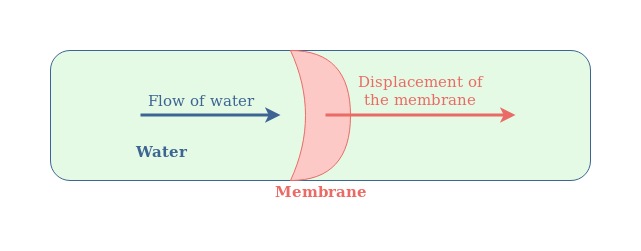

In order to better understand these concepts and how capacitors work, we can define an hydraulic analogy with an elastic membrane inside a pipe such as shown in Figure 2. Hydraulic analogies are a common way to establish correlations between abstract concepts in electricity with a more simple approach in the hydraulic domain.
fig 2 : Hydraulic analogy of the capacitor
In this analogy, the pipe represents the electric wire, the flow of water represents the electricity and the membrane is the capacitor. Moreover, the stiffness of the membrane represents the capacitance.
Such as for the capacitor, the water cannot go through the membrane but its pressure (analogy of the potential) induces a displacement of the membrane. If the water pressure is kept constant in the same direction, the membrane is pushed in the same direction with the same curvature and the molecules of water do not move. However, if an alternating flow of water is given, the membrane is pushed alternatively in opposite directions and the molecules of water are moving around it.

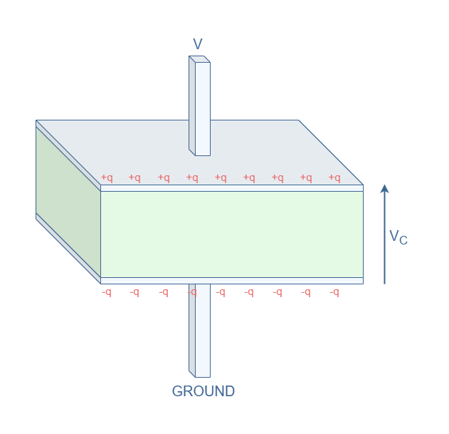

Now that we know more deeply what a capacitance consists of, we need to understand why it’s behavior is different when applying a constant or alternating voltage, which we briefly explained with the hydraulic analogy. Consider the same architecture of capacitance C as presented in Figure 1 when applying a constant potential difference V-VGROUND :
fig 3 : Parallel-plate configuration in DC regime
Due to electrostatic effect, applying a positive voltage V attracts charges +q at the plate 1 and -q at the plate 2. The sum of the positive charges (resp. negative charges) is +Q (resp. -Q). This distribution of charges generates a voltage VC=Q/C in the capacitor.
As long as the capacitor holds the charges, the voltage VC remains stable and we describe this particular state as charged. For perfect capacitors, the voltage VC can remain even if the DC source is turned off. However, in reality, we observe a discharge when the charges redistribute and VC decreases exponentially.
Apart from a temporary current that can be observed when the capacitor discharges (if the source is turned off), IC=0 in DC regime.

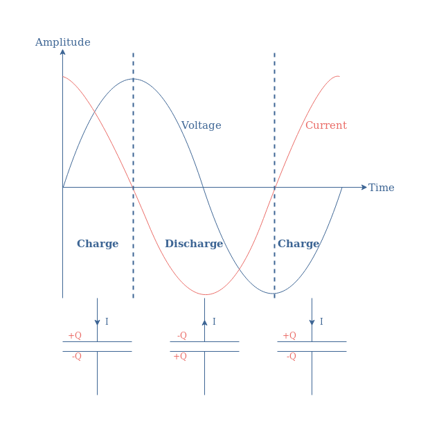

This behavior is however different in AC regime, the Figure 4 below superimpose the voltage and current characteristic along with the distribution of charges in the capacitor :
fig 4 : Charge and discharge cycles in AC regime
When applying an AC voltage to a capacitor, charge and discharge cycles are observed which generates a current that is phase shifted of -90° which is known as a quadrature of phase delay.

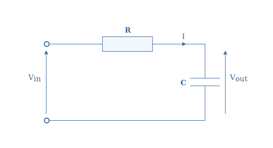

RC filter
Consider the following circuit in Figure 5 with Vin the input voltage and Vout the output voltage :
fig 5 : Series RC circuit
We use the same technique as shown in the AC inductance tutorial in order to get the gain and phase shift of the circuit with the transfer function.
By applying the voltage divider formula, we get the following transfer function TV :
eq 4 : RC circuit transfer function

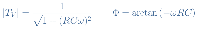

And finally the gain and phase shift of the RC filter is given by |TV| and Φ :
eq 7 : Gain and phase shift of a RL circuit

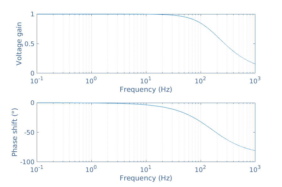

We can plot these two quantities on a Bode diagram by choosing for example R=100 Ω and C=1 μF :
fig 6 : Bode diagram of the RC series circuit
From the Bode diagram, we can observe that the RC series circuit is a low-pass filter since at low frequencies, the gain is equal to 1 and when the frequency increases, the gain tends to 0.

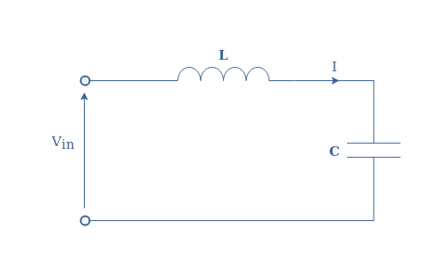

The association of an inductor with a capacitor is more interesting because a completely opposite behavior appears when connected in series or parallel, which isn’t the case for the RC filter.

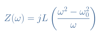

Let’s first of all consider the series circuit such as represented in Figure 7 :
fig 7 : LC series circuit
The total impedance Z is given by Z=ZC+ZL=jLω+(1/jCω). We can rewrite this expression with a common denominator, and by defining the quantity ω0=1/√(LC), it comes :
eq 8 : Impedance of a LC series circuit
We can see that Z(ω0)=0, for this reason, ω0 is named the resonance frequency. When connected with a load, an LC circuit will behave as a band-pass filter around ω0.

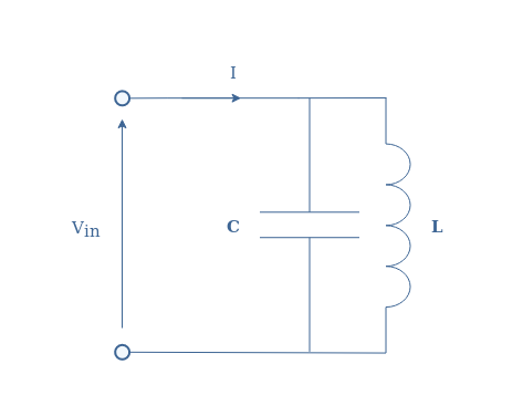

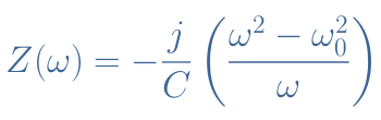

The parallel circuit represented in Figure 8 behaves exactly at the opposite of the series circuit.
fig 8 : LC parallel circuit
With the same method as exposed previously, the total impedance can be written such as :
eq 9 : Impedance of a LC parallel circuit
Here however, Z(ω0)→+∞ which means that at the resonant frequency, the circuit behaves as an open circuit. When connected with a load, the LC parallel filter act as a band-stop filter around ω0.
