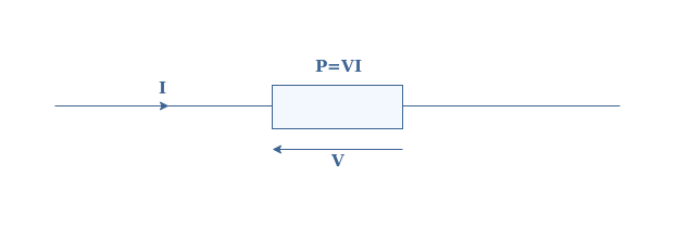

In this subsection, we focus specifically on the phase shift of the current (I) and voltage (V) signals across an electrical dipole and investigate its consequences regarding power.
In the DC regime, the dissipated power (P) across a dipole is given by the product of the voltage and current :
In the AC regime, this representation is no longer true since both the voltage and current are alternating. Consider the voltage across the dipole to be V=Vrms√2.sin(ωt) and the current of the same frequency presenting a phase difference of +ΔΦ: I=Irms√2.sin(ωt+Φ). With Vrms and Irms being the root mean square values.

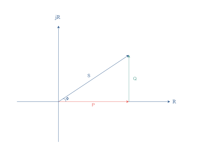

The term cos(Φ) is known as the power factor and gives the efficiency of a receptor to absorb the power of a source. This factor is a real number between 0 and 1 and these two extrema reflect very different behavior :
  • If cos(Φ)=1 the dipole is considered purely resistive, the phase shift between the voltage and current is zero. The dipole does not present any inductive or capacitive behavior.
  • If cos(Φ)=0 the dipole is purely reactive, the phase shift between the voltage and current is maximum, equal to ±90° or ±π/2 rad. In this case, the dipole does not consume any power but instead returns it to the circuit.
The power given in Equation 1 is called the active power (P), the product Vrms×Irms is known as the apparent power and noted S. It is the power that would be dissipated if the component was purely resistive. The quantity Vrms×Irms×sin(Φ) is the reactive power and noted Q. These quantities can be linked thanks to the phase shift ΔΦ in the same complex power diagram :
fig 3: Definition of the active, apparent and reactive power

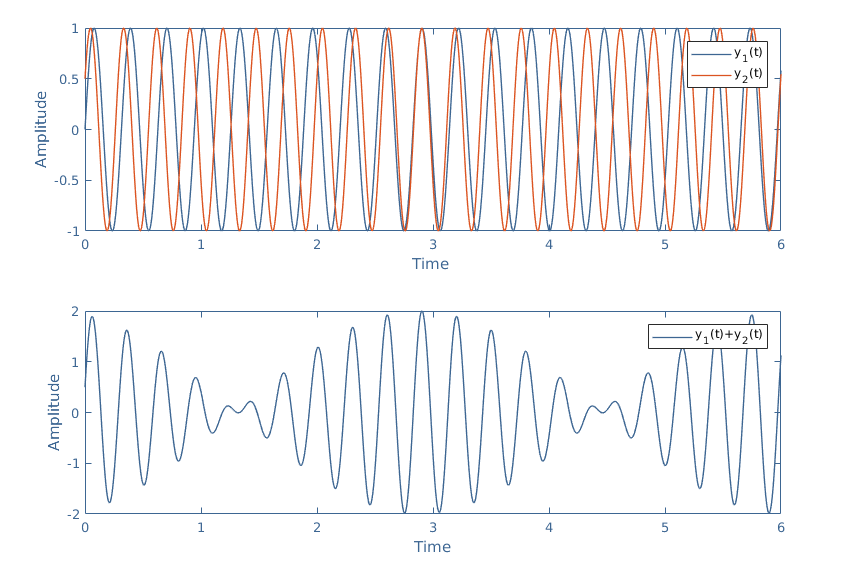

Between signals of similar frequency
In this section, we consider two signals y1(t) which is the reference and y2(t) phase-shifted of Φ of similar frequencies but not strictly identical: ω1≠ω2. Usually, a phase-shift can only be defined for two signals of the same frequency, but in this particular case, it still makes sense to define a phase-difference as the frequencies are similar. If the frequencies are too different, usually when ω1>2ω2 for example, it does not make sense to define it since the phase difference varies as much as the signal itself.
In the case where the signals are of similar frequency, the phase difference is not constant anymore but slowly varies with time: ΔΦ(t)=(ω2-ω1)t+Φ.
The superposition of these two signals is interesting because of the creation of a beating phenomenon such as illustrated in Figure 4:
fig 4: Illustration of the beating phenomenon between two signals of similar frequency
The beating takes his name from the acoustic domain where this phenomenon is particularly audible and easy to experience, however, it also appears in optics, electronics, mechanics etc… The beating is actually a particular case of interference, which we focus on in the next section.
Interference
We can see in Figure 4 that a superposition of sine waveforms results sometimes in addition to the amplitudes when the signals are in phase or in a subtraction when the signals are in opposition of phase. This phenomenon is known as interference and takes place when the signals are of the same frequency.

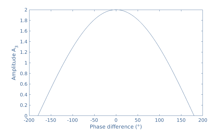

Consider again two sinusoidal waveforms of identical frequency : y1(t)=A1sin(ωt+Φ1) and y2(t)=A2sin(ωt+Φ2). Let’s call y3(t) the superposition y1(t)+y2(t) and A3 its amplitude. It can be shown that the amplitude of y3(t) satisfies the following equation :
eq 2: Amplitude of the superimposed signal
We can notice that the phase difference between y1(t) and y2(t) plays an important role in the final amplitude of the resulting signal. Two cases are interesting to highlight :
  • ΔΦ12=0, the signals are in phase and the amplitude A3 is maximal as satisfies A32=(A1+A2)2. In this case, we say that the interference between y1 and y2 is constructive.
  • ΔΦ12=±π rad, the signals are in opposition of phase and the amplitude A3 is minimal and satisfies A32=(A1-A2)2. In this case, the interference between y1 and y2 is destructive.
When the phase difference is between these two extrema, we can plot a graph showing the evolution of A3 as a function of ΔΦ12 :
fig 5: Amplitude of the resulting signal as a function of the phase difference
In this figure, we choose for the sake of simplicity A1=A2. We can see again that when ΔΦ12=0, A3=A1+A2=2 and when ΔΦ12=±180°, A3=A1-A2=0.
