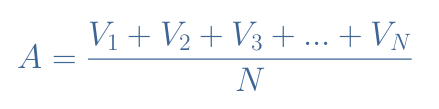

We can demonstrate this result by explaining how to calculate the average value. For a finite set of values, the averaging process consists of summing all the values (V1, V2, V3…)  and dividing them by the cardinal number N of the set (how many values there are in the set):

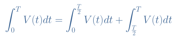

Equation 1 is the average of the signal V(t) taken between the times 0 and T, that is to say, a full period. The term ∫V(t)dt gives the value of the area between the curve V(t) and the reference of 0 V. Because the integration operation is linear, this term can be split in two:
For an elementary waveform such as presented in Figure 1, we can see that the first and second terms of this formula are equals but of opposite signs, therefore the average value is equal to 0.

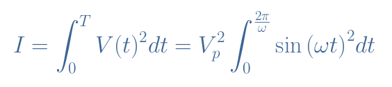

As an example, let’s determine the RMS value of a sine waveform of peak value Vp and angular pulsation ω V(t)=Vp×sin(ωt). We note f the frequency that satisfies f=ω/2π and T=1/f the period.
First of all, we compute the integral term that we note I:

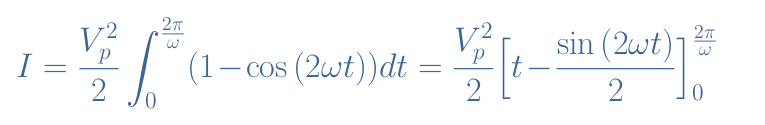

We use the trigonometric identity sin2(x)=(1-cos(2x))/2 to continue:
Evaluating the bracket term between 0 and T gives 2π/ω=T. Therefore, the integration term is finally equal to (πVp2)/ω. From Equation 4 we can see that we still need to multiply by 1/T which leads to [(πVp2)/ω]×[ω/(2π)]=Vp2/2 for the term under the root.
