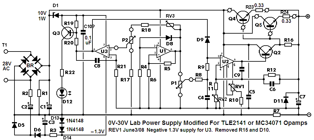

dracu_n_dulap Posted April 16, 2010 Report Posted April 16, 2010 Hi! I've built this psu and it works great :Dbut I was wondering why is R22 (in the latest schematic) a 1W resistor? ??? From my standpoint is just a current limiting resistor for the led, isn't it?and are 2W resistors enough in each power transistors emitter ? i've put 5w to be sure. Quote
audioguru Posted April 16, 2010 Report Posted April 16, 2010 Hi Dracu,I am glad to hear that your psu works fine. ;DR22 dissipated almost 1/2W when the transformer was 30VAC and the 10V zener diode was not installed. Now it can be a little 1/4W resistor.It is easy to calculate the power in a resistor. The 0.33 ohm emitter resistors have a max current of 1.5A. Then they dissipate (1.5A squared) x 0.33 ohms= 0.74W. A 1W resistor will be pretty darn hot so use 2W resistors. Quote

noworries2004 Posted April 23, 2010 Report Posted April 23, 2010 Finally connected up m ypower supply unfortunately it is not working, Measuring from Ground, using a 29.4 volt transformer 4 A. I am getting an input to R1 of 41V, how ever i am also getting this 41V at the output, Measuring voltage pot, i am getting a range from 1.1V up to 10.86V. I am reading 1.082 V across R5+R6, 0.541 across R5. Some how the input voltage is going straight through to the output?Has anyone got any ideas or suggestions. Email me back for further information. I am using th PCB recieved from Red wire so that is definetly ok.CheersReally need some help guys Quote
noworries2004 Posted April 23, 2010 Report Posted April 23, 2010 Current limiting LED is always on, U2 heats up as well , Quote
audioguru Posted April 23, 2010 Report Posted April 23, 2010 Ho No Worries,The output transistors or driver transistor are shorted or have their pins mixed up.The current-limiting LED should not be turned on when there is no load so it is another problem.The voltage pot should have an output from 0V to 11.2V.R5 plus R6 should have 11.2V. R5 should have 5.6V.Did you make the latest circuit with its parts? Quote

redwire Posted April 26, 2010 Author Report Posted April 26, 2010 Hi noworries2004. Knowing that you are using a pcb that has been comercially produced , its got to be the output transistors. Are you using the BD139 with the metal tab facing you as shown in the pictures on the 1st page. I guess you are trying this with one output transistor until you get things going? To help with transistor setup-from the attached photo 1. The blue wire is attached to the transistor base and pin 8 on your pcb. 2. Pin 7A or 7 on the pcb needs to connect to the collector of the transistor. On the pcb photo it is black with a red stripe. On the transistor photo is black) 3. Emitter: (red wire on the transistor photo, Yellow wire on the pcb photo) The wire from the emitter resistor should branch off with two wires athough only one is shown in the transistor picture, with one connecting to Pins 1 or 3 of the PCB (shown as yellow) the other wire is your output. make sure you print out the data sheet to get the pins correct. hope this helps Quote
noworries2004 Posted April 27, 2010 Report Posted April 27, 2010 I have checked the power transistors but i am still getting 41v at the output, I used a single power transistor but still no joy, How can i check if the power transistors are blown? Quote
audioguru Posted April 27, 2010 Report Posted April 27, 2010 The driver transistor and the output transistor are simple emitter-followers.The base voltage is the input and the emitter voltage is the output which is about 0.7V less than the base voltage if the project has a load of about 100mA.The collectors of the transistors are connected to +41V so if a transistor is shorted from collector to emitter then the output will always be at or near +41V.If a transistor is shorted from base to collector then it will always be turned on and the output will always be near +41V.Remove a transistor from the circuit and use an ohm-meter to see if it is shorted. Quote
redwire Posted April 28, 2010 Author Report Posted April 28, 2010 noworries2004, audioguru To isolate the problem couldn't noworries simply remove the output transistor then connect a multimeter to the emitter of the driver resistor- BD139 (PIN Eight) and the other lead on PIN 4( ground) and adjust the voltage pot. Wouldn't the voltage range vary between 0 and 40V? This would let him know if everything else is working. I'm guessing the lack of feedback voltage wouldn't be a problem. noworries could you send a picture of your completed pcb board? Perhaps I could spot something compared to mine. Quote
audioguru Posted April 28, 2010 Report Posted April 28, 2010 Without any negative feedback then opamp U2 will have a input voltage but no output feedback so its gain of about 200,000 will force its output as high as it can go.Remove the output transistors then short their base-emitter terminals for the driver transistor and U2 to work properly and drive a high resistance load. Quote

noworries2004 Posted May 4, 2010 Report Posted May 4, 2010 \Audioguru following reststances were taken between collector, base emmittercollector - base 0LBase - emmitter 0LCollector - emitter 2.341 M Ohms Quote
