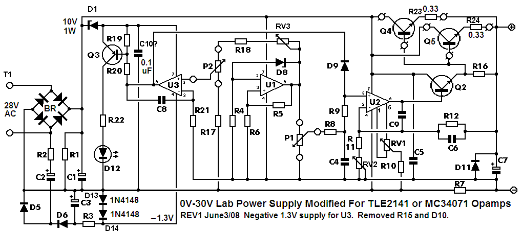

bugmenot Posted May 13, 2010 Report Posted May 13, 2010 And the PSU don't reach zero volts... Can I make any modifications in R10 or in RV1 to make the 0V adjust reach zero? Quote
audioguru Posted May 13, 2010 Report Posted May 13, 2010 And the PSU don't reach zero volts... Can I make any modifications in R10 or in RV1 to make the 0V adjust reach zero?1) Try shorting R10.2) The driver transistor and/or output transistors might be leaking current, replace them.3) C7 is an electrolytic type that has a voltage absorption problem. Use a film capacitor instead that is used in high quality speaker crossover networks.4) Try adding a permanent load of about a few mA. Quote

singonn2 Posted July 13, 2010 Report Posted July 13, 2010 hi everyone , now i doing new 5A power supply project using schematics and part list provide by redwire in first page . now i meet a problem , the LED is light while i switch on power same as noworries , i still using 24VAC 3A transformer for a test before get a new 30VAC 5A transformer.When i using TLE2141CP OPA U2 was heat up very fast , U2 pin4 was 2V ,i had already take off Q4,Q5 . Negative supply for U3 pin4 is -1.5V , U3 pin7 voltage is about 20V.U1,U2 pin7 is 31V it's normal , but pin4 only a few mV.Any pro can help me ? thx. :) Quote
mendimano Posted July 15, 2010 Report Posted July 15, 2010 I have finished the power supply 5 amperes version according to attached schematic and parts list,i have measured the output voltage it is 40 volts voltage potentiometer works fine i can bring it to zero voltage, as far as current pot it turns on the LED shortly after i increase the current regulation pot,( is it OK?)PS_Parts_List_10-11-091.pdf Quote
audioguru Posted July 15, 2010 Report Posted July 15, 2010 I have finished the power supply 5 amperes version according to attached schematic and parts list,i have measured the output voltage it is 40 volts voltage potentiometer works fine i can bring it to zero voltage, as far as current pot it turns on the LED shortly after i increase the current regulation pot,( is it OK?)The current regulation pot sets the max amount of current the output of this power supply can provide.RV3 calibrates the max current to be 5.0A.At zero rotation the warning LED should not light if there is no load.At half-way rotation the warning LED should light and the output voltage should drop only when the load current tries to be 2.5A or more.At maximum rotation the warning LED should light and the output voltage should drop only when the current tries to be 5A or more. Quote
mendimano Posted July 16, 2010 Report Posted July 16, 2010 Thank you audioguro for this detailed instructions on how to test the power supply, by the way U1 and U3 op amp are getting hot (U1 a Little bit more) is that normal without any load on power supply, only the voltmeter at the output. Quote
audioguru Posted July 16, 2010 Report Posted July 16, 2010 Thank you audioguro for this detailed instructions on how to test the power supply, by the way U1 and U3 op amp are getting hot (U1 a Little bit more) is that normal without any load on power supply, only the voltmeter at the output.I am assuming that your your unregulated supply is +40V.If U1 is an MC34071 then it has an idle current of 2.8mA max which causes heating of 40V x 2.8mA= 112mW. U1 has an output of 12.2V and an output current of 5.6mA so it heats with an additional (40V - 11.2V) x 5.6mA= 161.3mW. Then the total heating is 273.3mW max which will make it warm, not hot.A tiny little surface-mount package might get hot.If the circuit is made on a breadboard then the opamp will probably oscillate and get hot.If U1 is a TLE2141 then it has an idle current of 4.4mA max. Its total heating is 337.3mW max which will make it warm, not hot.A load on the power supply will reduce the unregulated supply voltage a little which will make opamps U1 and U3 a little cooler. U2 will get a little warmer. Quote

sparky666 Posted July 25, 2010 Report Posted July 25, 2010 I would like to build this power supply too. Now I'm making the PCB design for bottom layer only PCB, when I saw that something's wrong with U1(I think). The Vcc+ pin is at the In- side, and the Vcc- at the In+ side. How is that IC placed there? And one more thing: Can I use TL071CP instead of TLE2141(They are pin compatible, they do the same thing, the price is different)? Any help would be appreciated. Quote
audioguru Posted July 25, 2010 Report Posted July 25, 2010 I would like to build this power supply too. Now I'm making the PCB design for bottom layer only PCB, when I saw that something's wrong with U1(I think). The Vcc+ pin is at the In- side, and the Vcc- at the In+ side. How is that IC placed there?The schematic shows which parts are connected to which pin numbers. The layout on the datasheet shows which pins are on which side.Pin 7 connects to the positive supply. Pin 2 is the inverting input that connects to D8 and R4. Pin 3 is the non-inverting input and connects to R5 and R6. Pin 4 connects to the output 0V.Can I use TL071CP instead of TLE2141?Not without reducing the supply voltage to it since the supply is 42V without a load and the max allowed supply for a TLE2141 or MC34071 is 44V but the max allowed supply for a TL071 is only 36V.U3 has its positive supply reduced by a 10V zener diode that can also supply a TL071 for U1 with a max supply of 32V if you want.U3 must be a TLE2141 or MC34071 because they have inputs that work with a very low negative supply voltage. Quote
