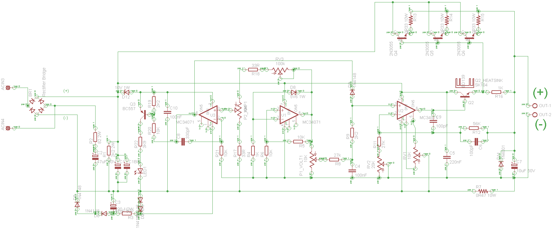

redwire Posted October 13, 2012 Author Report Posted October 13, 2012 Was anyone able to open Javierhm's Eagle file? I tried to open with version 6.3.0 with no luck. Quote
Javierhm Posted October 23, 2012 Report Posted October 23, 2012 Sorry for the delay!I was working in an Eagle 6.3 version.I post it here including a bitmap.PSU_Audioguru.rar Quote
audioguru Posted October 23, 2012 Report Posted October 23, 2012 I can't open your RAR compressed file because it has errors.Why not post the schematic as an ordinary PNG file? Quote
PicMaster Posted October 23, 2012 Report Posted October 23, 2012 I was able to open it try this one I've zipped it up see how you get onPlaca_principal.zip Quote
Hero999 Posted October 23, 2012 Report Posted October 23, 2012 You seem to be determined to stop people from opening your file.Please use a universal format such as PNG or PDF so that veryone can read it. Quote
Javierhm Posted October 23, 2012 Report Posted October 23, 2012 Here you are an image of the schematic and the circuit itself (zip compressed - not .sch format allowed to be posted in this forum) corrected to be compatible with version 6.3 of Cadsoft EagleWhy not post the schematic as an ordinary PNG file?.Because the Eagle file can be useful to somebody else.Placa_principal.zip Quote

WinDTrek Posted November 25, 2012 Report Posted November 25, 2012 i'm currently building the 5A version. i have all the components soldered already on the PCB. however just now i noticed that D10 is not in the schematic but it's on the part's list. i have check again the final schematic from red and audio and both has NO D10 but it's on their part's list. Quote
audioguru Posted November 25, 2012 Report Posted November 25, 2012 The original schematic had a useless D10 from the base of the driver transistor to the output.I deleted it from my schematic but it is still on the parts list by mistake.The 10V/1W zener diode is on my latest 3A schematic (March 11/09) but it does not have a "D" number. It is D12 on my latest 3A parts list.I didn't make a schematic for the 5A version because the changes are only a few. Quote
redwire Posted November 26, 2012 Author Report Posted November 26, 2012 Audioguru, Also note that the 10V, 1W Zener is listed as D12 on the parts list but on the schematic D12 is an led indicator for the current control. If you make the changes I'll post the revised parts list on the first thread. Quote
