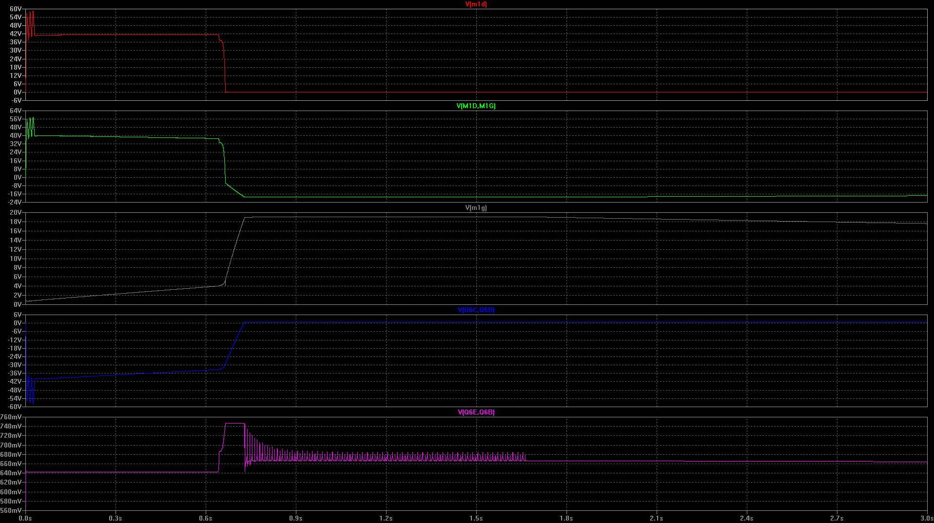

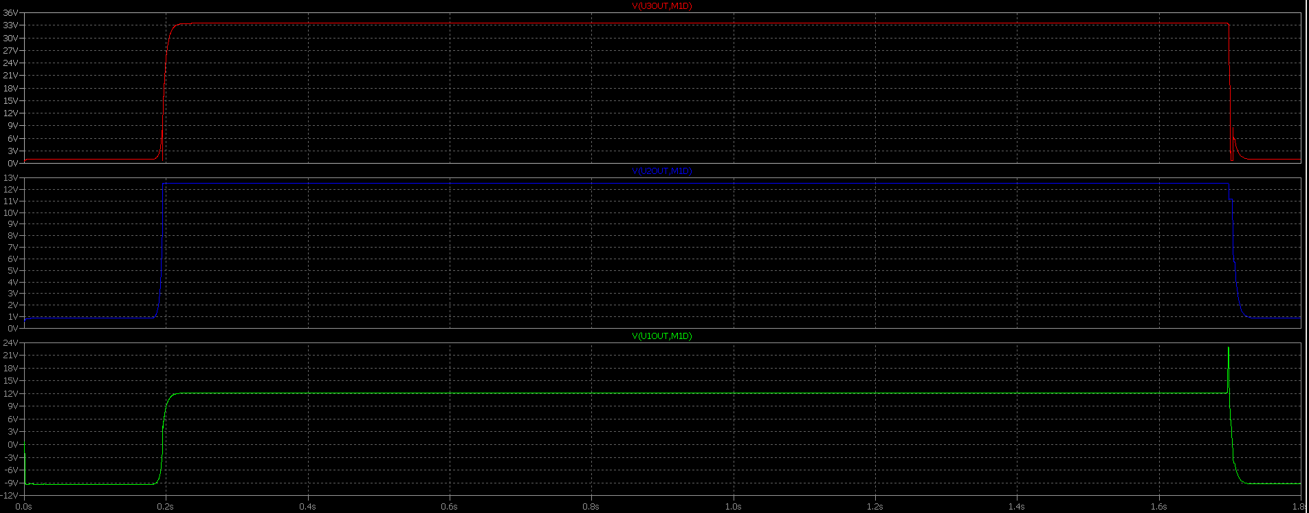

I've been playing with the simulation and found that if I change the value of C6 in the sim schematic (C4 in the original schematic) to a larger value I can get the output to slowly ramp up.  I tried introducing the spike like I had it in the mosfet circuit but it doesn't really affect the output so it's as if the circuit doesn't suffer from the problem.  But, if we reduce the time the output can rise with a larger value here wouldn't the issue be solved for the most part?
C6 in the latest SIM circuit prevents the current regulator from quickly cutting back or quickly allowing more current. Then if the output is suddenly shorted the current in the circuit will skyrocket until the slowly ramping opamp can catch up which is very bad.
Maybe the current sensing resistor should be non-inductive (not wire-wound).

What about the sims C9 (orig C6)?  I can get the same results there as well.
It slows down changes in the voltage regulation. Add a load then the voltage suddenly drops and when this capacitor charges then the voltage slowly comes up to normal. Disconnect a load and the voltage suddenly increases and when this capacitor charges then the voltage slowly comes down to normal.
It prevents high frequency oscillation, maybe because the output transistors are very slow.

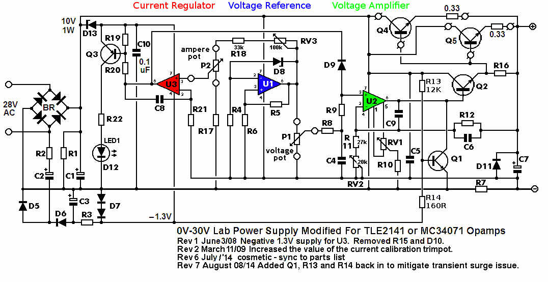

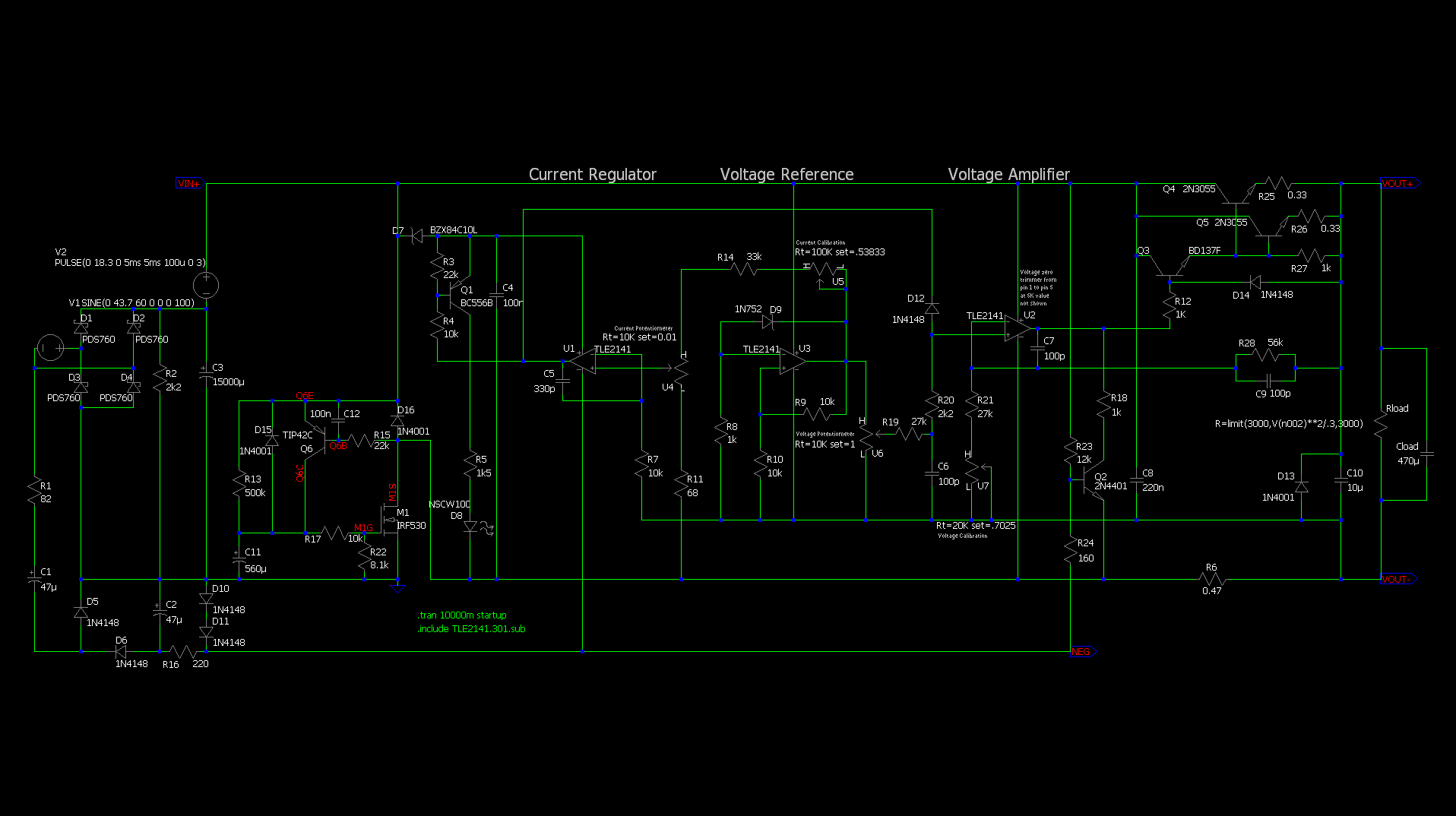

Hello guys. Since i'm new to electronics, may I know what are the function of the op-amps in this circuit?
We cannot teach the basics of opamps in one post but here goes:
1) Everyone who modifies this circuit uses a different parts numbering system so I will describe the three opamps as the voltage reference circuit, the voltage amplifier and the current regulator.
1) The voltage reference opamp provides a constant current to the 5.6V reference zener diode and has a gain of 2 times so the reference voltage is 11.2V.
2) The voltage amplifier opamp drives the BD139 driver transistor which drives the two 2N3055 output transistors. Two resistors in the amplifier allow the amplifier to have a gain of 2.68 times so that the 11.2V reference is amplified up to 30.0V at a high current.
3) The current regulator opamp compares the voltage produced by the load current in the 0.47 ohms current sensing resistor with the voiltage of the current setting potentiometer. If the sensed voltage is too high then this opamp reduces the voltage from the voltage setting potentiometer through a diode until the load current is the same as is set. If the output is shorted then the current regulator opamp causes the output voltage setting to drop to almost zero so the current is not higher than the setting of the current setting pot.

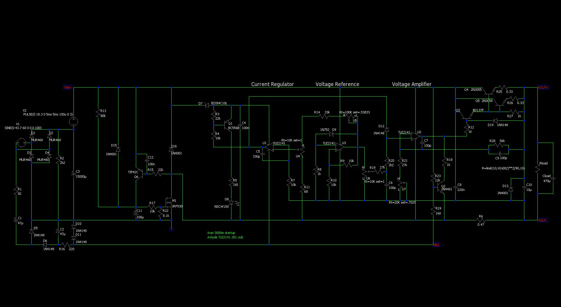

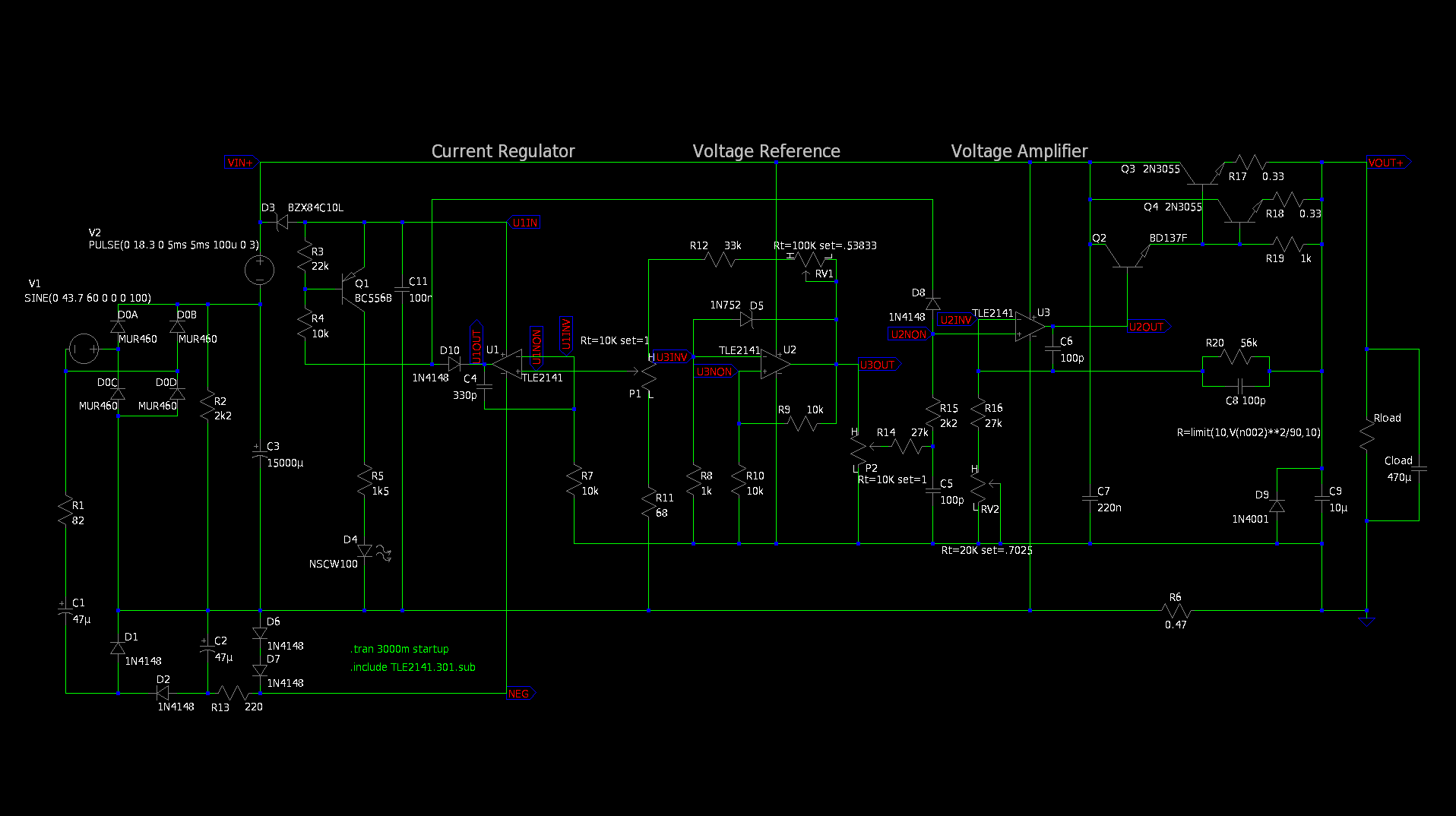

Here's a corrected and slightly modified version of the simulation.  There were a few errors in the original and I've rearranged things to more closely resemble the original schematic.  I didn't renumber the parts because it's a pain to do.  It's easy to renumber them top to bottom, left to right which is why my Eagle schematics are renumbered the way they are but to do this based off of the original would take quite awhile and if you add or remove something it just screws up the flow.  I've been trying to get a decent spike simulated but it's not going very well so far.  I have noticed that the output of the current control op amp oscillates where the other two don't.  Anyone else have any experience with LTSpice IV?
See this post for the latest simulations.

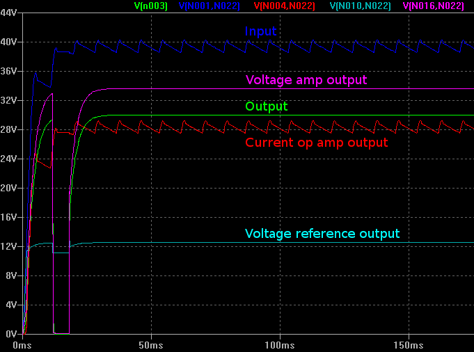

The current regulator opamp is not oscillating. Its output is saturated as high as it can go which is about +28V because it is not regulating the current so of course it shows the 120Hz ripple from the unregulated +39V, which is reduced to +29V by the 10V zener diode.
The moment the current regulator opamp begins to work then its output will have no ripple.

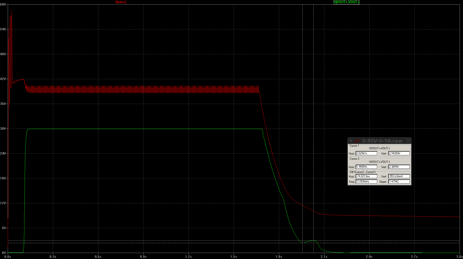

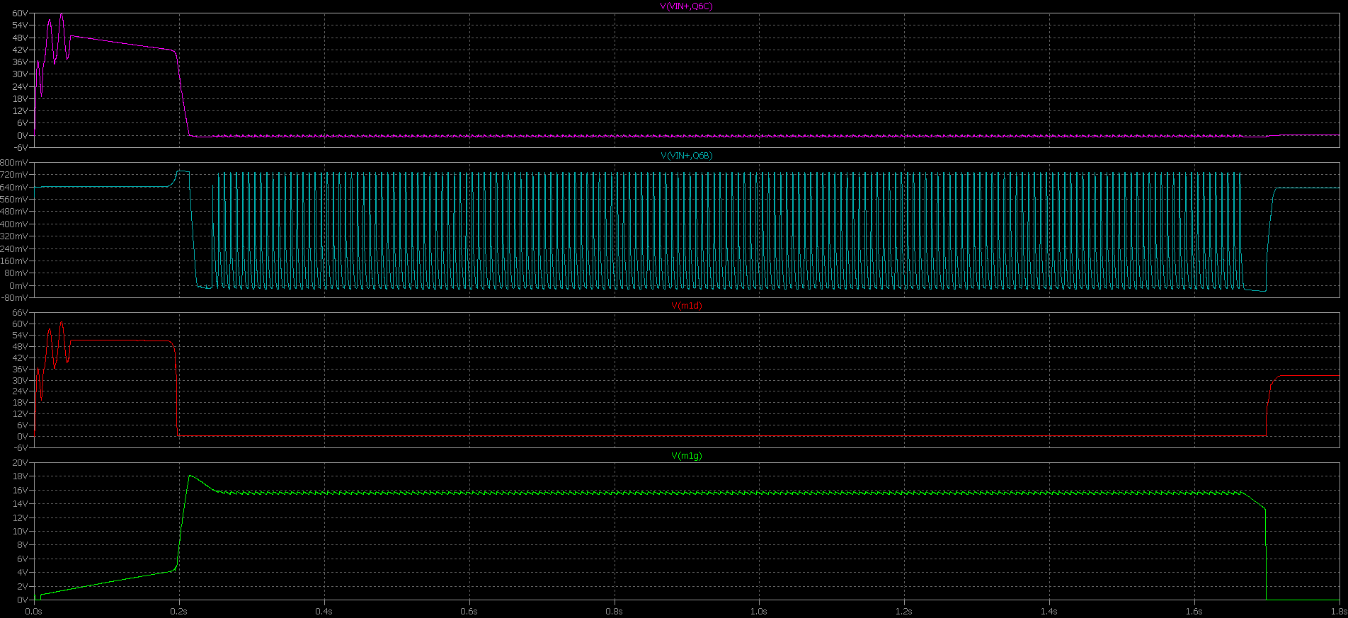

Yep, you're right, as I lower the current pot to about .48 it starts to kick in and smooth out the output.  It's neat to be able to simulate this in a somewhat accurate way.  I've got the trimmer on the voltage set so it outputs right at 30V when the voltage pot is set at 1 (.7025) but I haven't messed with the current side of things yet.  I'm still trying to figure out how to emulate a voltage spike on the input without drawing the time frame out with the soft start mosfet circuit.  For some reason when I change the time to ramp the voltage up, the spike stretches out along with it instead of firing and just shutting off.  It's kind of frustrating really.
Edit: Here's a nice plot showing that if anyone's interested.

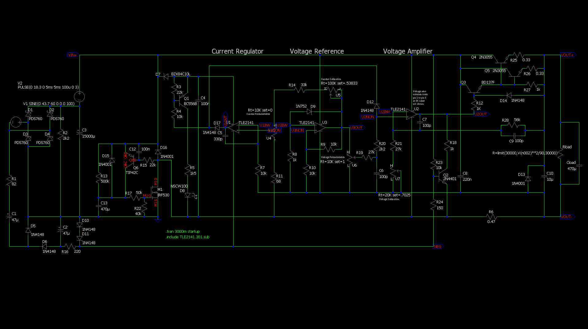

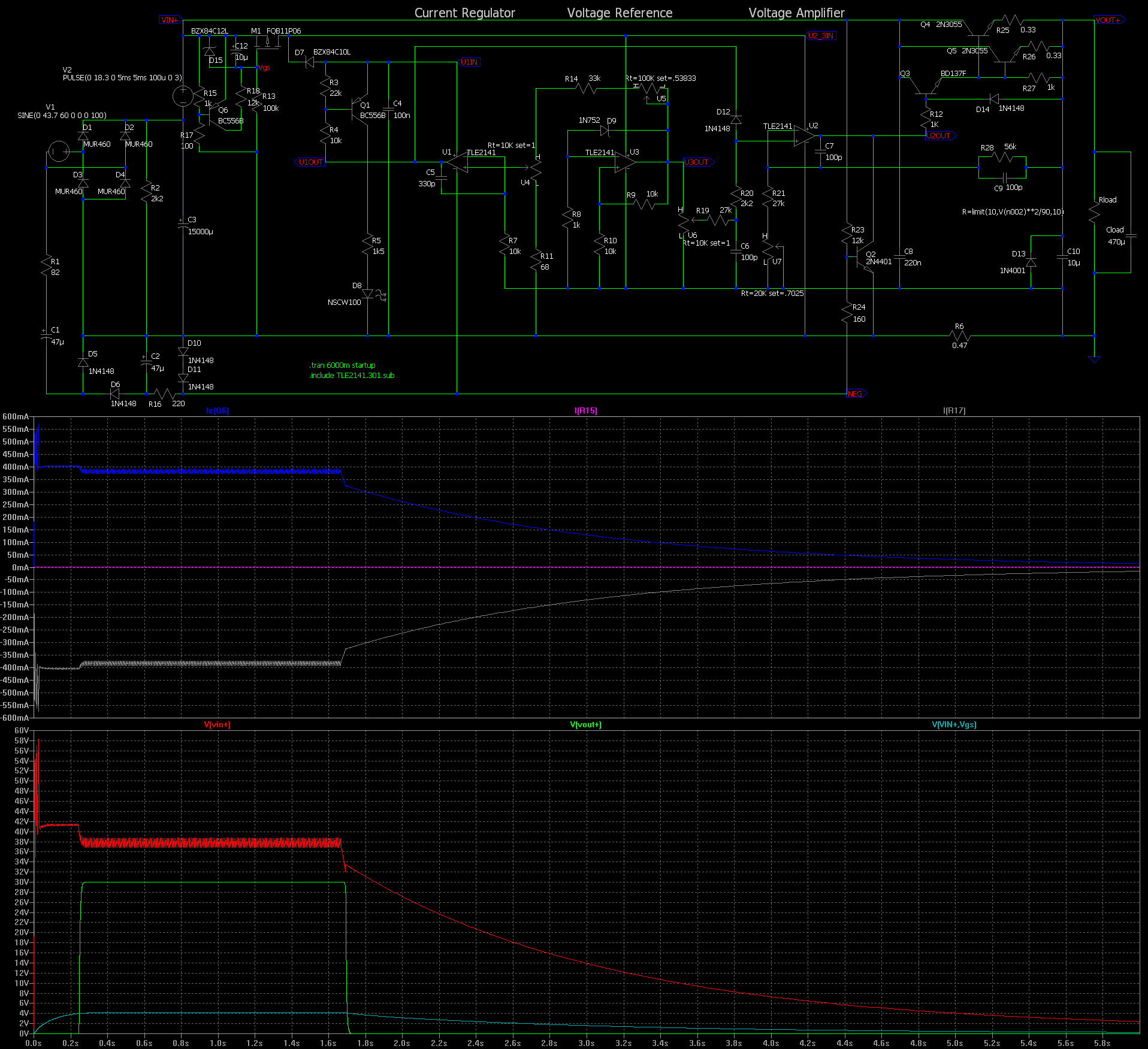

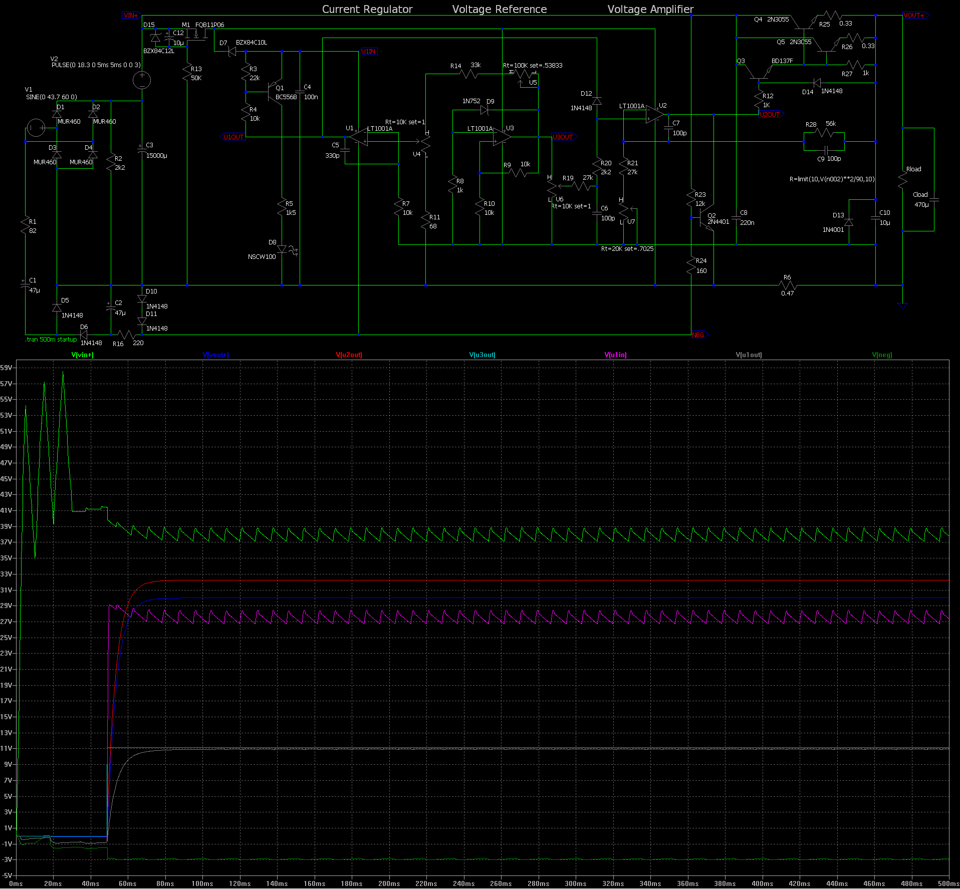

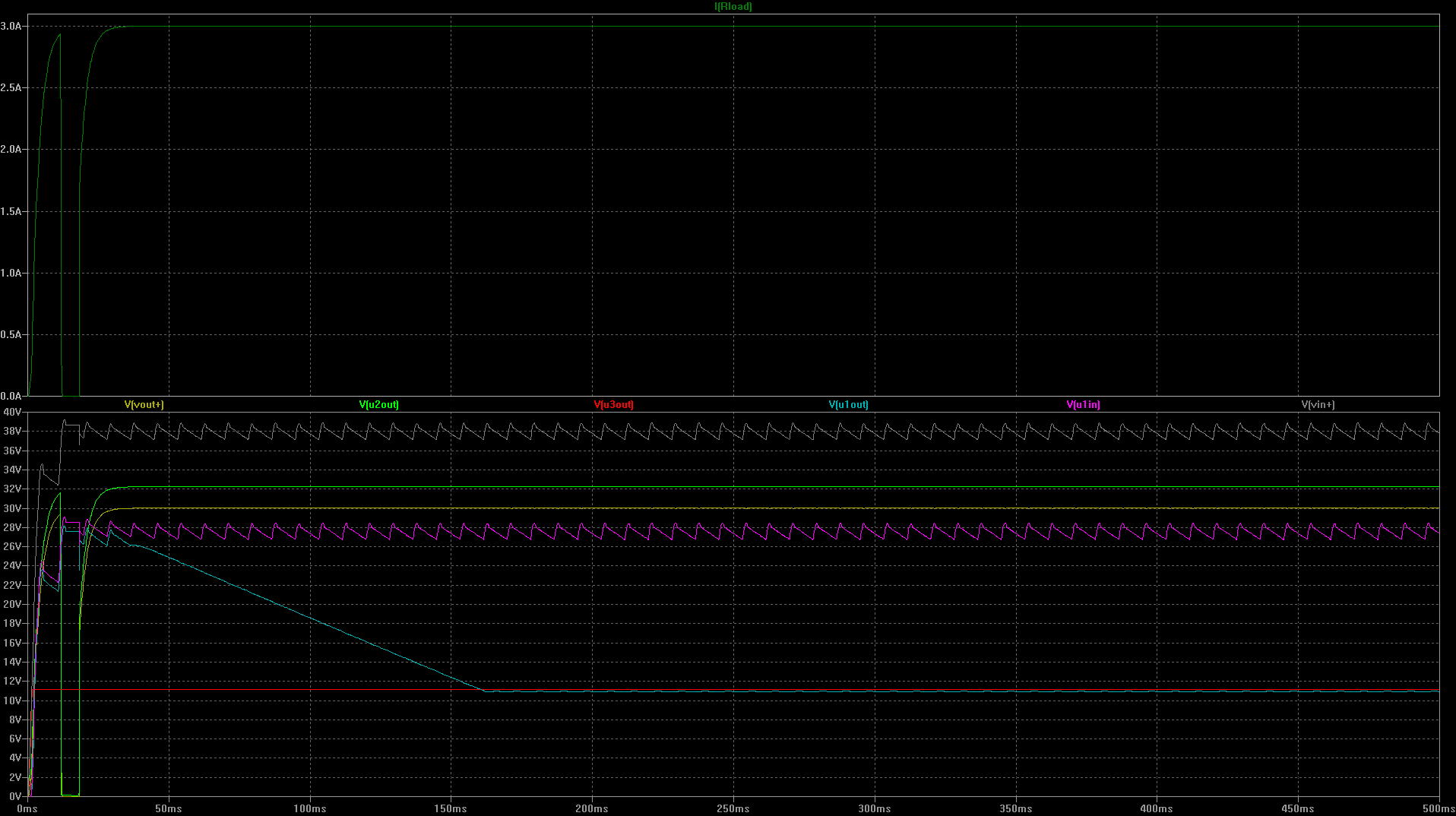

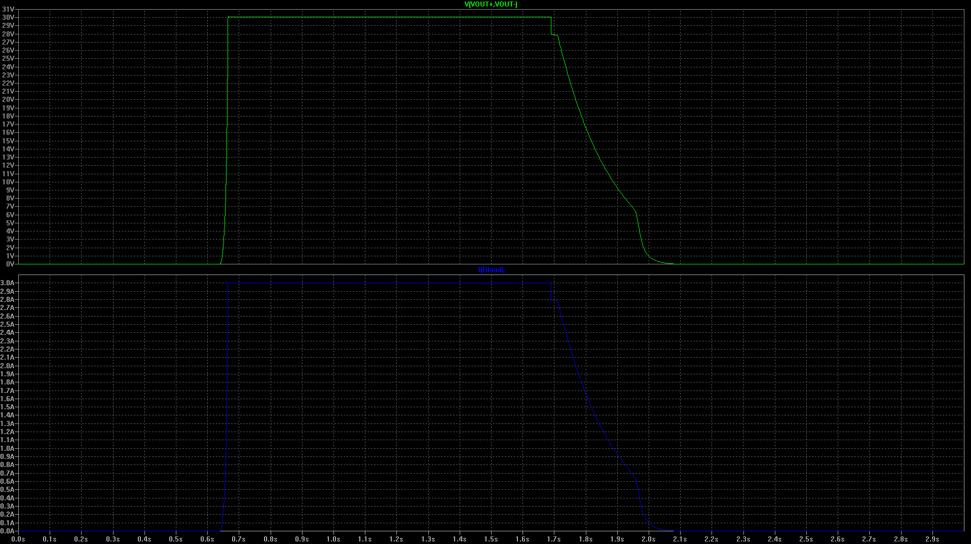

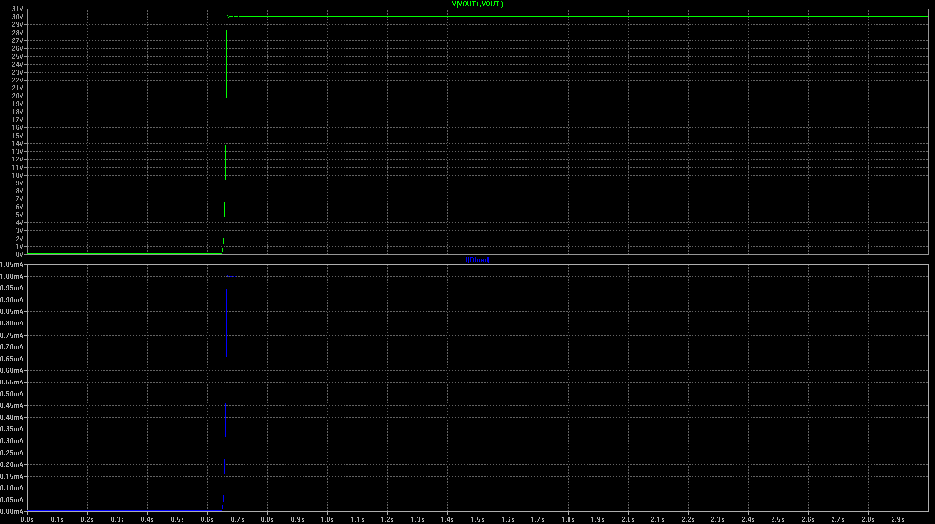

I finally got the spike to behave.  I've put U1, U2, and U3 behind the mosfet soft-start circuit and left the pass transistors outside of that.  Here's the results and the simulation so that you can run it for yourselves.
Edit:  I was just browsing around TI's site and came accross Taming linear regulator inrush currents.  ;D  Figure 2 shows I was on the right track here.  I think we may have a workable solution with this.
2nd edit:  I'm attaching a separate simulation that injects noise into the input in addition to the spike.  This one takes awhile to run but the results are fantastic in my opinion.  The output of the supply is very smooth even though the input is rough as hell.

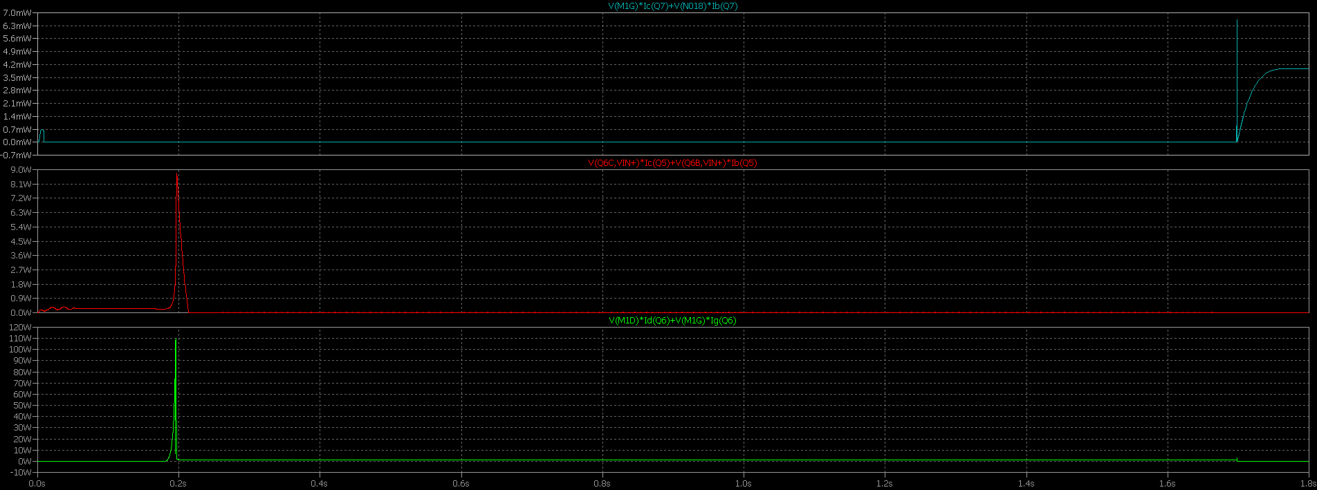

See my last post above for an issue that I ran into and a possible solution.  I'm not sure if this will work or not and if I'm overloading things with the voltage divider circuit to the base of the PNP transistor.  The thing simulates rather well for all that but I'd like some opinions.
One thing I'm worried about is power dissipation in the base resistors and the transistor itself.  There's a fine line between the three values of resistors in the soft start circuit and the actual ability to shunt to ground after power off.  If I use bigger resistors, similar to the overcurrent shunt, I end up with a 4V spike as the transistor turns off and, what I believe is the mosfet turning back on due to residual energy in the cap.  Am I going about this all wrong?
Edit again:  I think this might work as far as power dissipation goes.  I kept trying to think in terms of input to ground so I think that's where I was running into trouble.  I'm going to try this out tomorrow and see what kind of results I get.
2nd edit:  It won't work in this configuration.  I'm working on another version but I'm having trouble with Vgs voltages and fall off times.  Stay tuned.

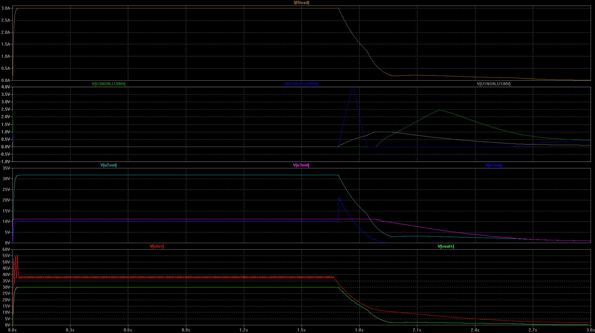

I think I may be on to something finally.  I've checked the power across the soft start components and things seem to be within tolerances there.  You can replace the TLE2141's if you want but they work fine if you keep the TLE2141.301.sub file in the same folder as the 0-30V-0-3A.asc file.  I got this circuit out of some research I was doing on soft starts to the primaries of the transformers and modified it for my purposes.  The original circuit had a pot in series with R13 to adjust the delay but it didn't want to work in this context so I deleted it.  I'm still not sure why it wasn't adjusting the time delay but I'll keep playing with it until I figure it out.  I'll admit that the mosfet and pnp might not be ideal but I used the ones that were standard to LTSpice and had the kinds of specs I wanted.  I did check the datasheets on them and, to my newbie mind, they seemed fine for this instance.  Please give criticism and suggestions if you have them.

This works really well until you start to play around with the current regulation side.  The transistor and mosfet in the soft start needs more work I'm thinking because it's not quite stable as current goes down.  This is a shot of the final schematic I'm working with.  The current and voltage trimmers are as accurate as I can get them and still have this simulate in a relatively fast manner.  If you load the output with R=limit(3000,V(n002)**2/.3,3000) and set the current pot to 0.01 and voltage to 1, you'll get what you see in this plot.  If you set the current pot to one and leave the voltage pot at 1, you'll have to set the Rload to R=limit(10,V(n002)**2/90,10) to see the nice plot above.  I'm still working on it but I'd say for the most part that this is done enough to try out and test in the real world.  If anyone does, could you report back your findings?  I can't build one of these right now due to other obligations at the moment.  This thing is better than a video game.  ;D

Here it is folks.  I got the soft start stabilized and had to add one component to the circuit to make it work well.  The U1 op amp (U3 original) needed a diode between its output and where U2's (U2 original) non-inverting input connected through D12 (D9 original) headed out to the BD557.  I don't know what effect this diode would have in the real world but it makes the simulation work and stops all the wonky current control issues.  I deleted the other simulations as this is going to be the final version of this with the soft start.  I'm now going to try and fix the circuit without a soft start.

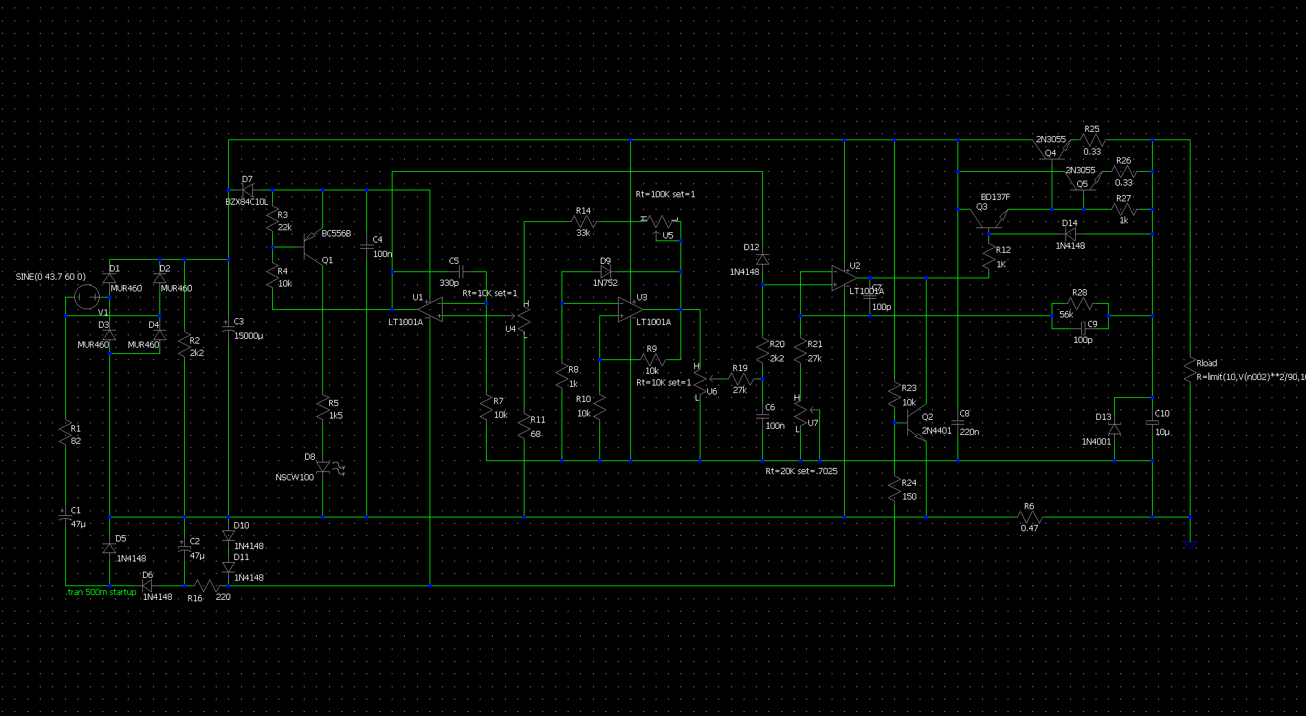

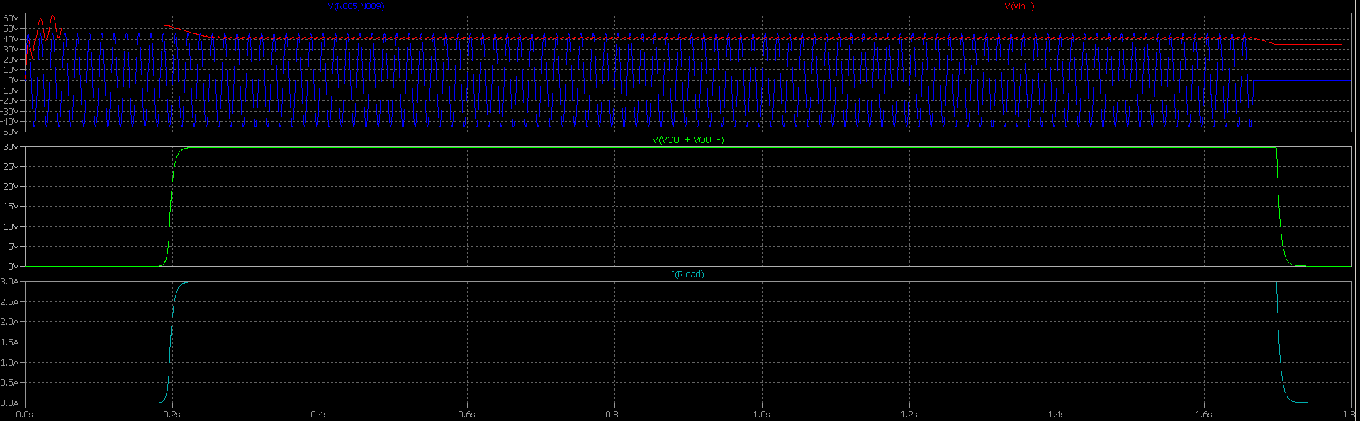

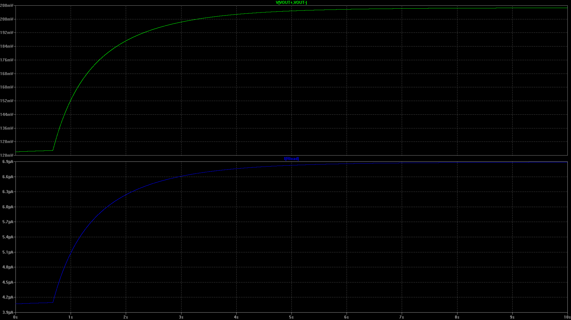

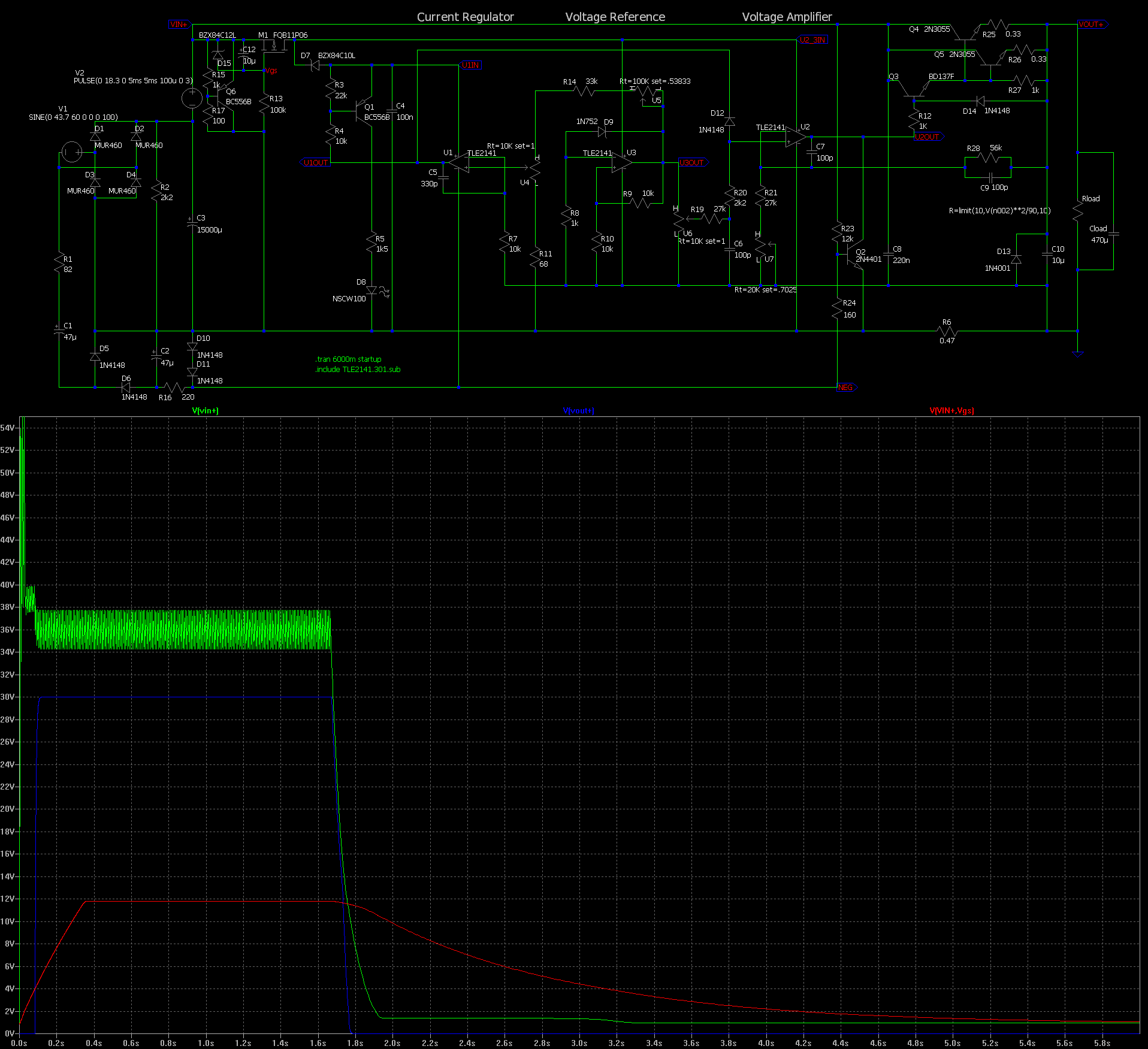

I've done some further testing on the design as I have it already built and I think I've solved the transient issues altogether without a soft start although it might not be a bad idea as it stands.  I even took back out the original Q1 circuit and am getting really good results, at least in the simulation.
The current control op amp needs a diode on its output pin.  That's it.  I think what has been happening is that the voltage control op amp has been destabilizing that part of the circuit where it connects at that point.  I'm going to do some further testing with a behavioral noise voltage on the input to see how it behaves.
My apologies for the renumbering, I've been playing with LTSpice to learn how it works better and I've figured out that ctrl-alt-shift-r renumbers the parts and I didn't feel like taking the time to make them line up with the schematic that's been posted here from time immemorial.  Left to right, top to bottom seems to be the convention so I'm going to stick with that.

It is very confusing when each new schematic has different parts designation numbers.
Your new D10 has backwards polarity then the current regulation will not work.
When the new U1 detects over-current then its output goes low enough to pull down the voltage feeding the voltage amplifier opamp so that the current in the load is reduced.
You're right, I modified it and corrected the screenshots.  Needless to say, it still works better with a diode there.  Before I tried that, it would seriously mess up the output.
Edit:  I added the corrected diode polarity to redwire's board and it didn't do anything to stop the spike.  Would you be willing to build and test one of these to figure out where this issue is coming from if I sent you a board?

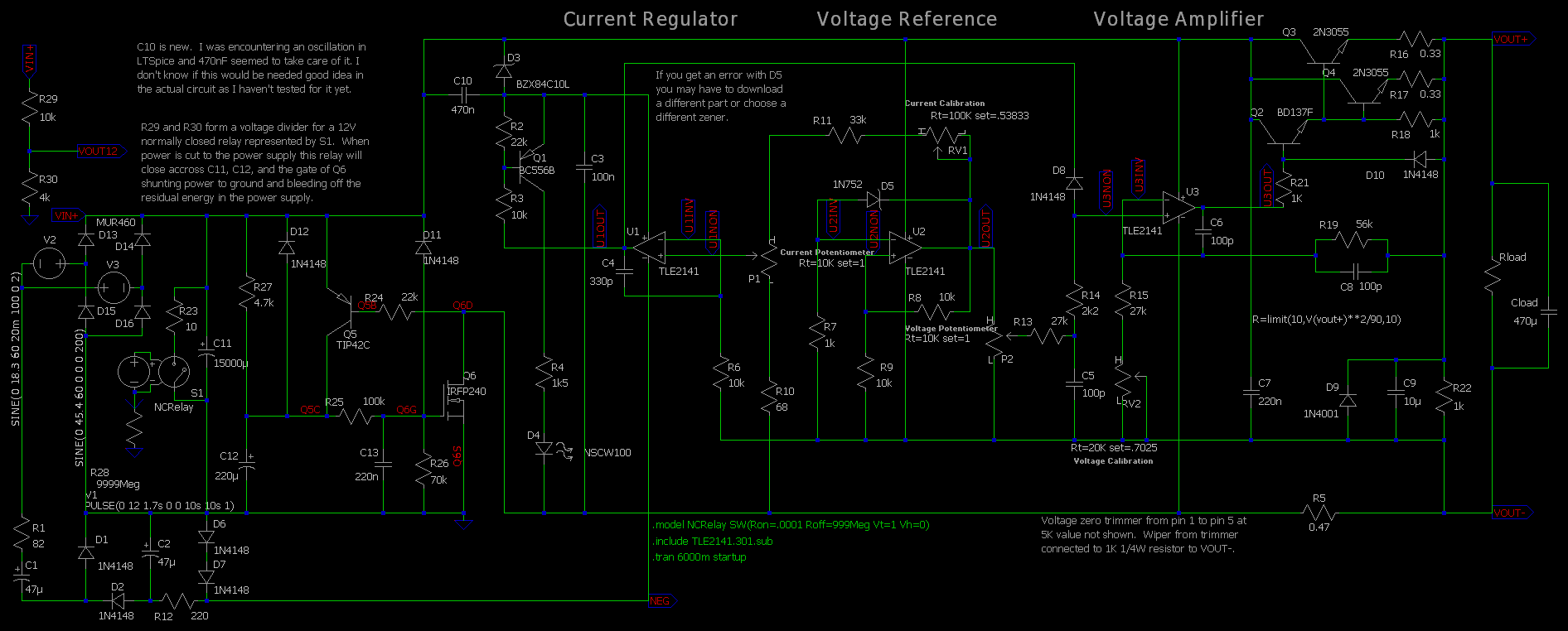

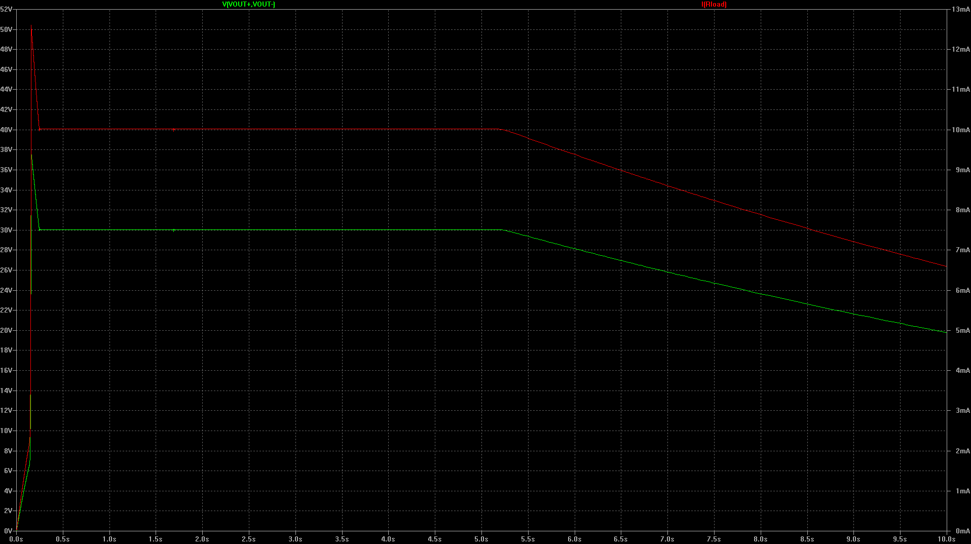

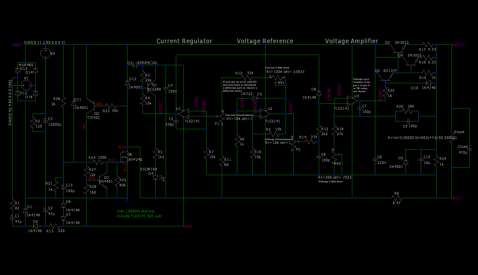

OK, scratch all that from before.  How does this look?  I've got a soft start and I moved Q1 (Q7 on this schematic) from the output of the op amp to the gate of the mosfet and now it starts up with a delay and shuts down rather quickly without introducing any oddities into the output(s).  I think the power across all the components are within tolerance but I may have missed something.  The soft start handles the startup transient and Q7 shuts everything off quickly.
Edit: a couple of modifications to the circuit plus changed the values and wattage of a couple of resistors to have lower values for bleeding the caps etc.

I've tweaked the circuit to have some really smooth waveforms during startup and shutdown.  I'm not going to post screenshots of those but I'll post the circuit and the spice file with accompanying models for the 2141's in LTSpice.  This is complete unless someone can find fault with it.  The soft start works great and I've added a small 12V normally closed relay to switch in a 10 ohm resistor on shutdown to bleed out the caps that keeps things powered up, I.e. C11, C12 and also the gate of the mosfet is hooked in as well to quickly power everything off.  I've been working really hard on this so be gentle.  I've tried to think of most things to check but I may have missed something.  This is the most complicated simulation I've done to date and the fact that it actually works amazes me.  LTSpice is, in my opinion, better than a video game for entertainment.
C10 is new because I was getting an oscillation through the zener at U1 in my simulations but I don't know if it's needed in the real world as I haven't tested that part of the circuit yet.  The bleeder resistor is only in circuit when the power is off and until the relay powers up fully so a larger power resistor would be needed but could probably live on board if you wanted.  I plan on using a couple chassis mount resistors that I have on hand but the rest of the circuit is going to be designed to live on the circuit board.
Edit:  Accidentally uploaded the wrong .asc file, sorry.
