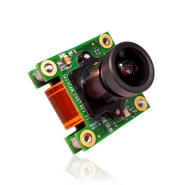

See3CAM_CU27 is a low-light camera based on the SONY STARVIS IMX462 image sensor. It stands out in its superior near-infrared performance. The high sensitivity of this Full HD camera helps to capture images in as extremely low lighting conditions as 0 lux, which makes it suitable for night vision applications and medical microscopes. Also, this camera comes with a high-performance onboard Image Signal Processor (ISP). This facilitates accurate color reproduction with auto exposure and auto white balance functions that provide the best possible image output. See3CAM_CU27 is a fixed focus camera that has an M12 lens holder which offers customers an opportunity to use the lens of their choice.
Key features of See3CAM_CU27
  • High Sensitivity – Capture images even in extremely low lighting conditions (0 lux)
  • IR sensitivity – Capture high-quality images in near-infrared regions
  • USB 3.1 Gen 1 interface – Plug and play support for Windows and Linux systems.
  • Inbuilt Image Signal Processor – Facilitates accurate color reproduction with auto exposure and auto white balance functions
  • Streams MJPEG video data in Full HD @100 fps and UYVY video data in Full HD @60 fps
