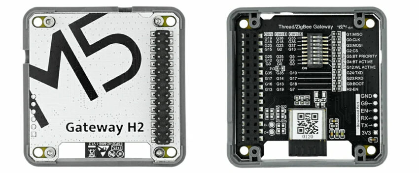

M5STACK has launched the ESP32-H2 Thread/Zigbee Gateway Module (SKU: M141), a stackable development module designed for M5 series hosts, featuring the ESP32-H2-MINI-1 chip with a 32-bit single-core RISC-V processor with a clock speed of up to 96 MHz. This module supports wireless communication protocols such as Zigbee, Thread, and Matter (based on Thread), leveraging IEEE 802.15.4 technology for seamless ecosystem interconnectivity.
This module supports wireless communication protocols such as Zigbee, Thread, and Matter (based on Thread), leveraging IEEE 802.15.4 technology for seamless ecosystem interconnectivity. With built-in hardware encryption for secure IoT applications, the module includes an 8-position DIP switch for flexible interface switching (UART/SPI) and wireless function control.
It supports low power consumption of 8.55mA at 3.3V and a working current of 18.35mA at 3.3V during Thread networking, making it suitable for smart home automation, industrial automation, healthcare, consumer electronics, smart agriculture, and sensor networks. The module is compatible with development platforms like UIFlow 2.0 and Arduino IDE, allowing easy firmware flashing and debugging. Measuring 54.0 x 54.0 x 13.1mm and weighing 11.8g, it features an on-board PCB antenna and 2MB flash. With an operating temperature range of 0-40°C, it is well-suited for building energy-efficient wireless communication nodes.

ESP32-H2 Thread/Zigbee Gateway Module Specifications:
  • SoC: ESP32-H2, 32-bit single-core RISC-V processor @ up to 96 MHz
  • Memory: 2MB Flash
  • Wireless Connectivity:
    • IEEE 802.15.4
    • Zigbee 3.0, Thread 1.3, Matter (based on Thread)
  • Interfaces:
    • 8-position DIP switch for UART/SPI selection and wireless function control
    • Standard programming/debugging interface
  • Expansion: Compatible with M5 series hosts for expansion
  • Misc: On-board PCB antenna
  • Power Consumption:
    • Standby: 3.3V @ 8.55mA
    • Active (Thread networking): 3.3V @ 18.35mA
  • Security: Built-in hardware encryption engine
  • Operating Temperature: 0°C to 40°C
  • Dimensions: 54.0 x 54.0 x 13.1mm
  • Weight: 11.8g (module)

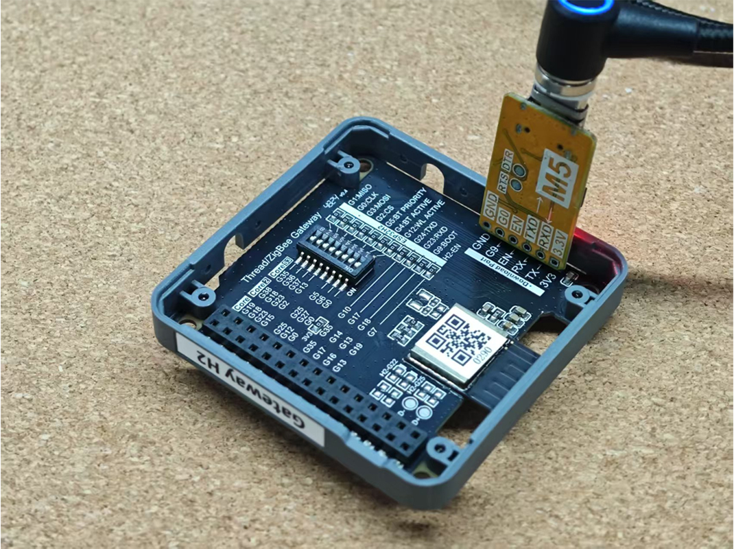

At the time of writing, the ESP32-H2 Thread/Zigbee Gateway Module is available for $6.50 on the M5Stack store. However, to program the ESP32-H2, this device seems to need the ESP32 Downloader available at the store for $9.95.
