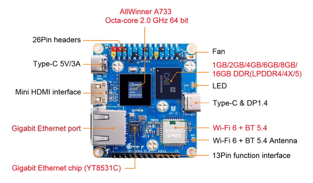

Orange Pi Zero 4 front sideOrange Pi Zero 4 front side

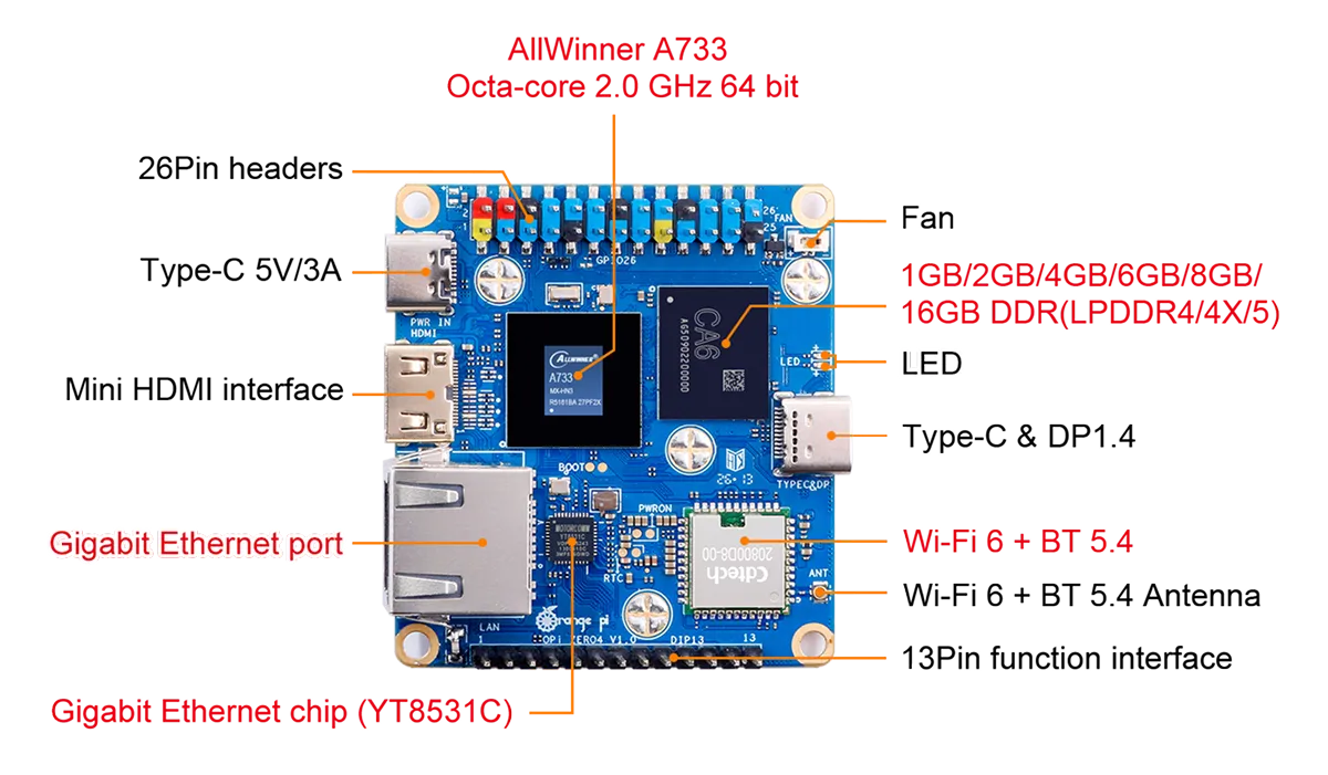

Orange Pi Zero 4 top side specifications

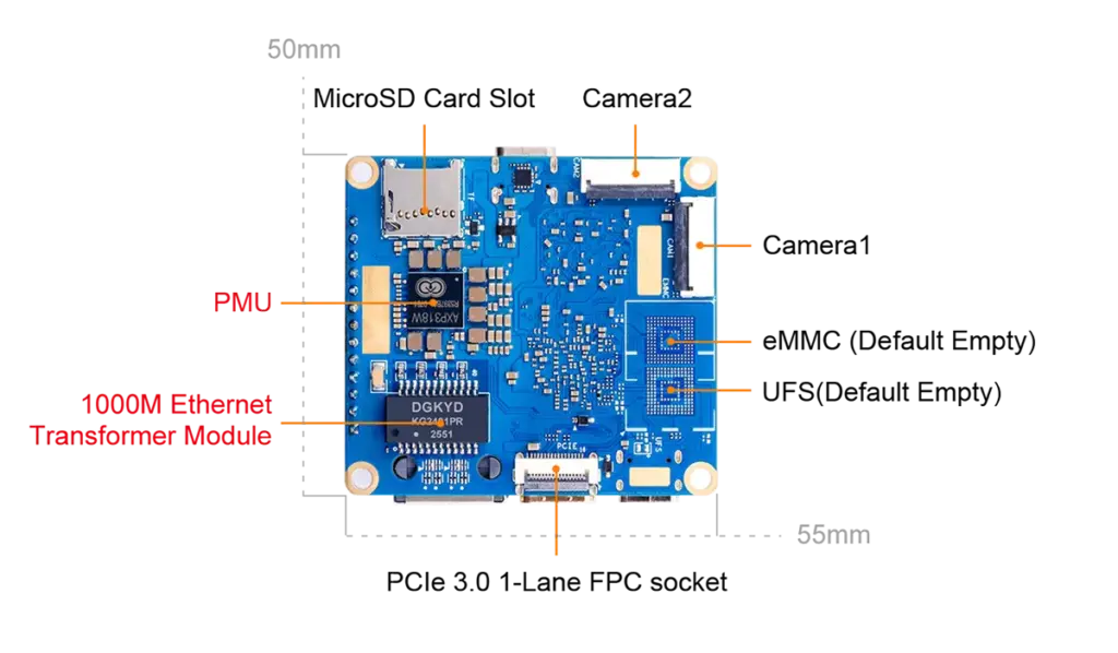

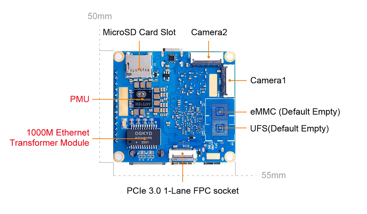

Orange Pi Zero 4 bottom side specifications
